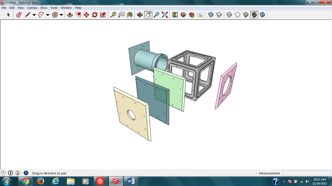

Hey guys, this will likely be kinda scattered because I've got a lot of little details to talk about.

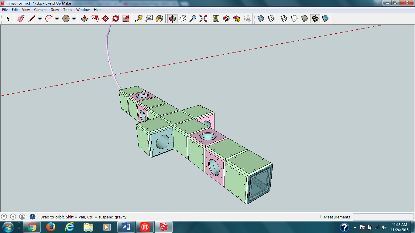

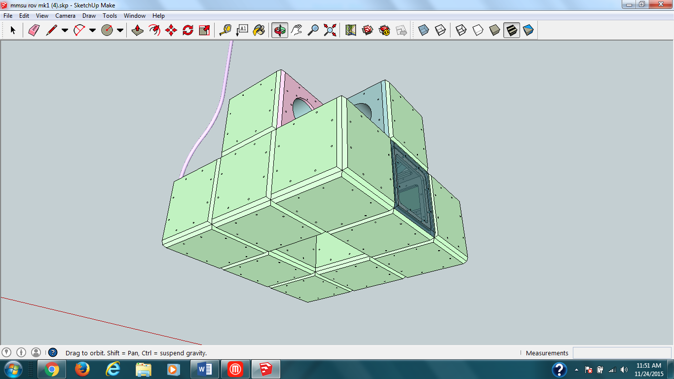

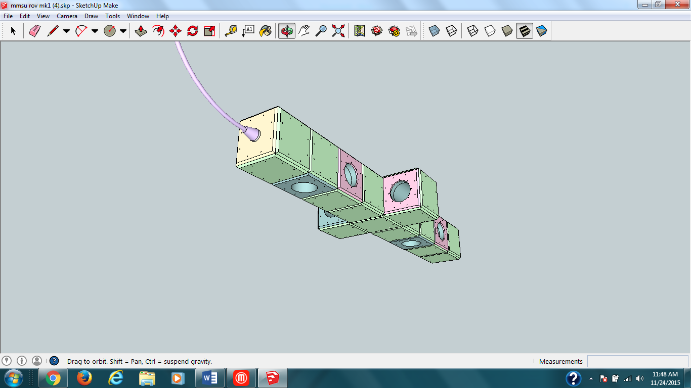

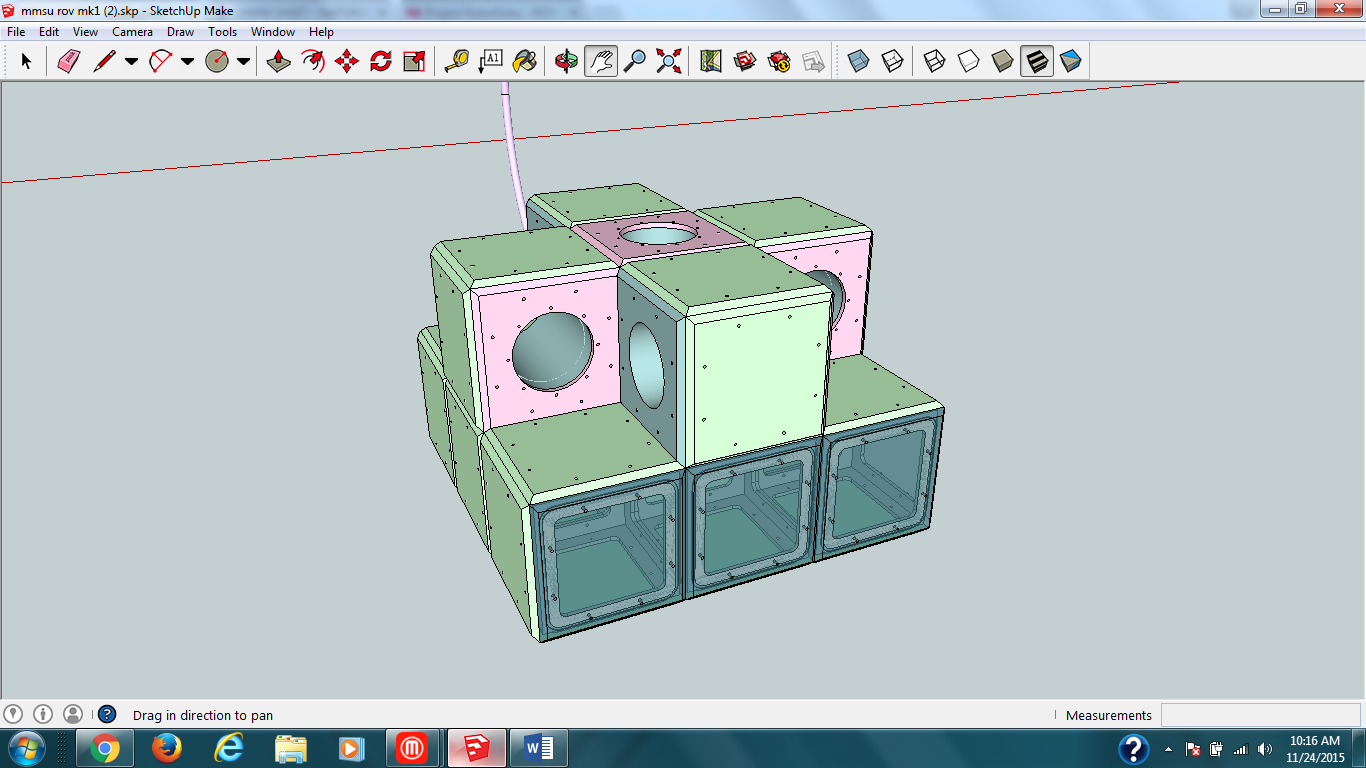

So i got the pictures here, it shows the basic layout of the cubes, as well as two potential configurations one being small and highly maneuverable for observation, the other being fast and slender for surveying.
All of the plates have eight threaded M2 screw holes that are common across all plates and cubes to maintain compatibility.
The pink plate with the hole and the blue plate with the tube make up a thruster assembly, basically a propeller shroud which contains the motor and prop.
the green plate is just a standard bulkhead, the tan one has a thread
ed hole cut into it for a bulkhead fitting to run in a cable, and the clear one is Acrylic for cameras or light to see through.
And the base grey frame is milled UHMWPE (I am currently working on funding for it so until then i'm focusing on software/electronics)
The size of the base frame is 100 mm^3, and the plates are all 4 mm thick.
PLEASE criticize, ask questions, comment. This is a prototype for a larger project and still very young so input is greatly appreciated!
