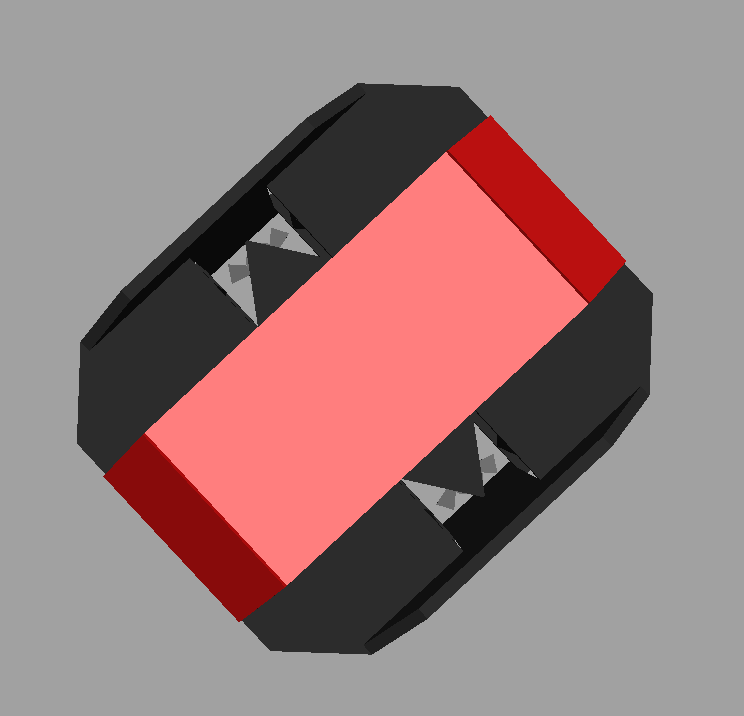

And since I've got most of it working, at least in a basic fashion, I thought I'd turn my attention to the design of the frame.
I plan on using a 4" enclosure from Blue Robotics and I plan to make most of the rest of the frame from 10mm thick sheets of HDPE which I should be able to work with using my very modest tools - a Dremel and a scroll saw. It will have 6 brushless thrusters and the ROV will only need to dive to a maximum depth of 15m.
I think the pictures should explain what I'm thinking, for scale the ROV is 400mm long. The red panels on top will be just thin 3mm acrylic under which I plan to put whatever I use for buoyancy - that space will fit about 30 ping pong balls so that might be the way to go.

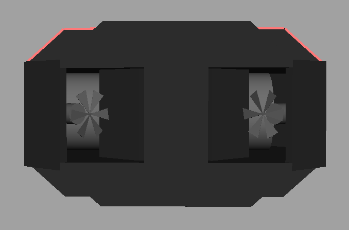

Here's a view with the top off to show the internal vertical pieces:

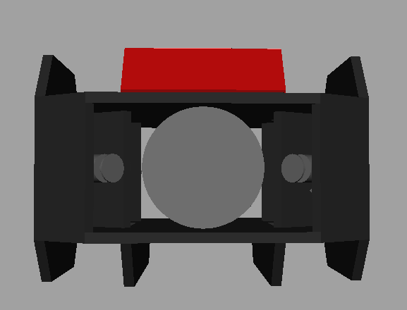

And the pieces of HDPE and acrylic roughly laid out:
Can anybody see any potential issues? Any advice?

Looks pretty sweet!
Not sure about the ping pong balls though. Not had any experience with them

Bindo wrote:Looks pretty sweet!
Neither have I but I was reading the great info posted by KR2_Diving here: viewtopic.php?f=18&t=803&hilit=ping+pong&start=90#p9968 and it seemed that they could be an easy way to go.

SSN626B wrote:@subn00b,
I built my ROV Chassis out of 1/2" thick HDPE with 6 T100 Thrusters and two 4" diameter 11 3/4" long WTCs and I still had to add almost 5 pounds of ballast to get it to be just slightly awash.
SSN626B/TCIII
Thanks for the info. I was worried about having to add a lot of buoyancy but it doesn't sound like that will be a problem!
Also I think I'm going to build the frame from 6mm thick acrylic instead of the HDPE as I'm thinking I'll just get it laser cut rather than do it myself.
