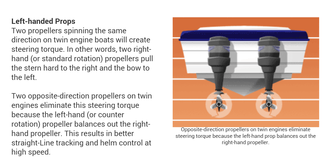

Thank You for the reply. The plan for my ROV is 50cm long, by 35cm wide and 35cm high. These are rough estimates as of now. Therefore the orientation of the propellers will not make a difference, due to the size of the vehicle ? So I can go with either left or right hand propellers ? Thanks for the reply once again, it clarified a lot of things to me.
This is an image that I found on :  http://www.iboats.com/basics/propeller_basics.html   which accurately explains the relation ship between left hand propellers and right hand propellers.
