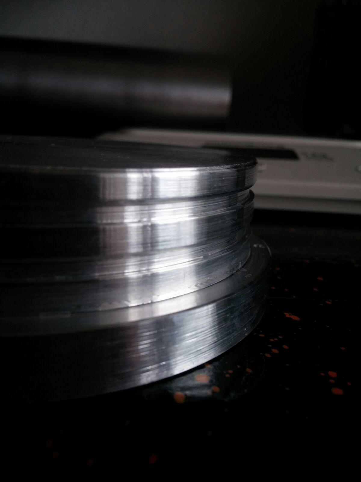

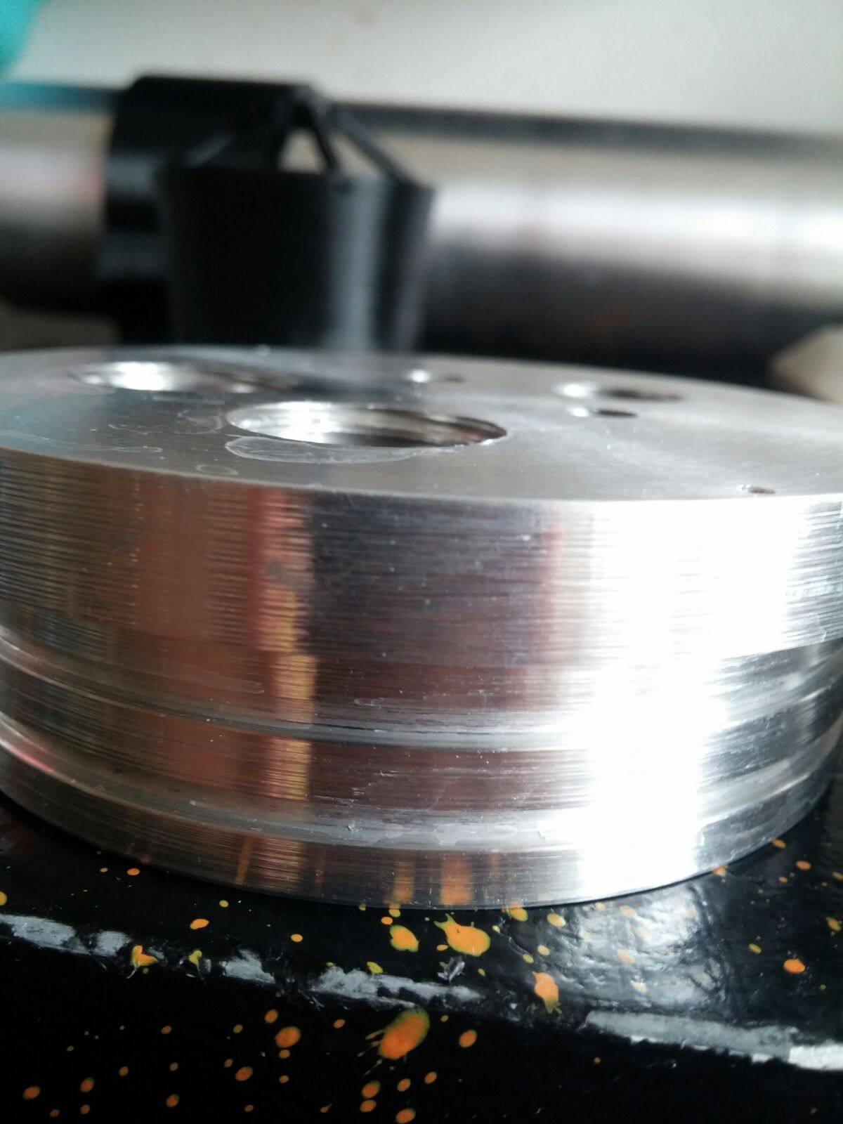

I draw the parts of my rov, the turner maker made them. Do you think them can works? These are 2 pictures of the endcaps!
Thanks
Re: My rov and first problem
Posted: Sep 28th, 2015, 6:21 am
by Bindo
They should work, however if it isn't the finish you were expecting then reject them!
Posted: Sep 28th, 2015, 11:21 am
You might have to polish up the o-ring grooves a bit just to make sure you get a good clean seal but other than that they look good.

May the problem be the roundness of the seats in the photo 2?
Posted: Sep 28th, 2015, 4:04 pm
You mean because the groove for the o-ring is flat and not round?
I'm no expert but I'm pretty sure you want a flat groove so the when the o-ring compresses it spreads out evenly too form the seal. Although they do look a little to rough of a surface finish in those photos.

In fact, I say they are too rounded!
Posted: Sep 28th, 2015, 5:21 pm
by rossrov
Hi vinsub. I agree with Steve's comments. Also possibly that grade of material is not the best for machining. Looks a bit "cheesy". The groove shape looks O.K. If the edges are too sharp damage could be done to the o-ring during assembly. Polish the grooves a bit, and use lots of o-ring grease before your lake test.
Posted: Sep 29th, 2015, 5:15 am
by Bindo
actually the chamfer on the oring grooves is on the wrong side!!
those orings may extrude through the gap
Posted: Sep 29th, 2015, 10:48 am
by vinsub
Can i widen the o-ring seat of a few tenths of millimeter and make straight the wall of the seat?
