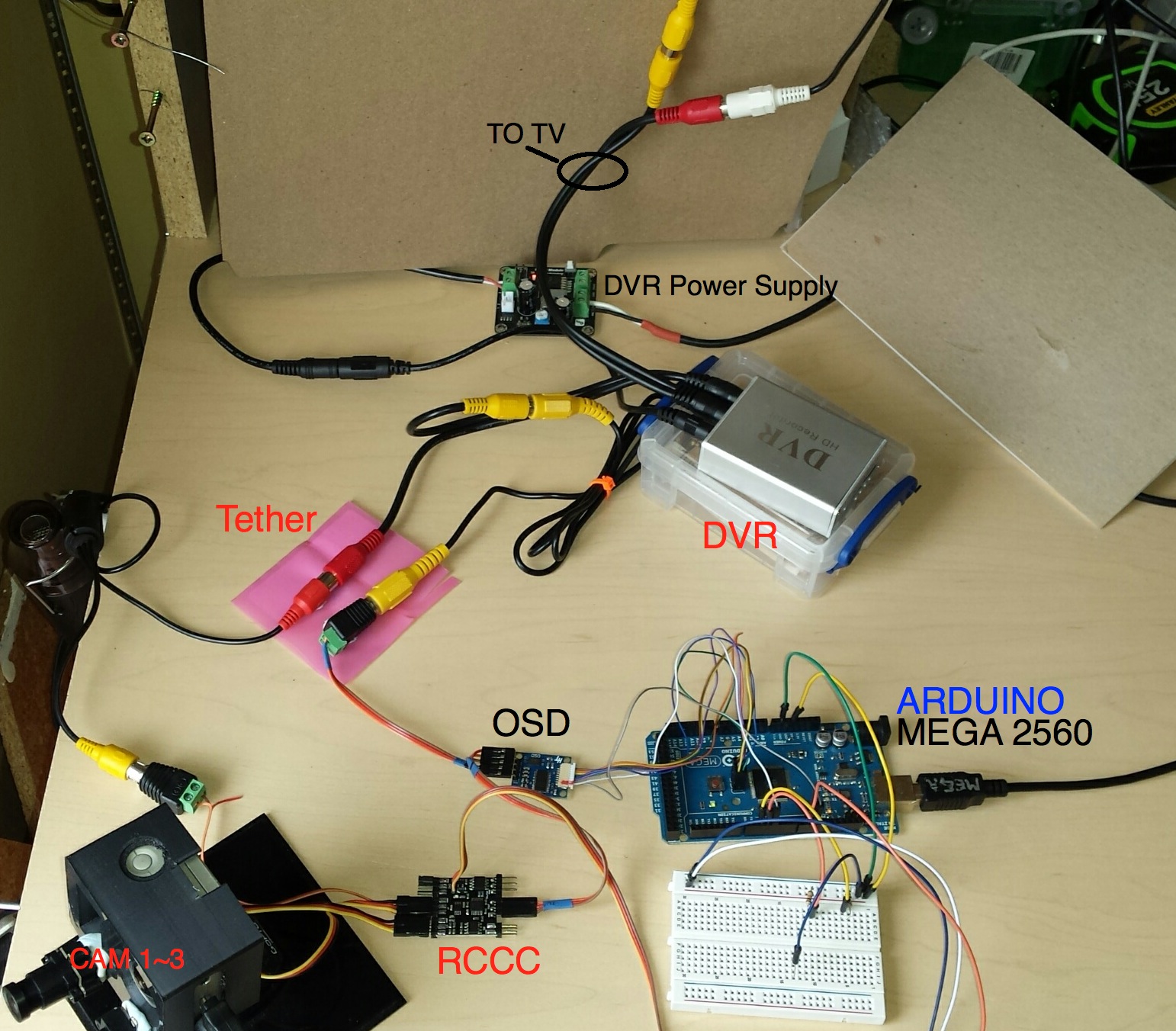

Here is the configuration that I will be installing on my ROV:
TOPSIDE:
DVR - Records active feed from drivers Screen. Available from HobbyKing.
Drivers Screen - Currently an old 12" TV... will be upgrading to a LCD Screen soon!
ROV SIDE:
Camera 1: Mini CMOS FPV Camera from HobbyKing.
Camera 2: GoPro Hero 2
Camera 3: Mini CMOS FPV Camera from HobbyKing.
OSD: On Screen Display from Hobbytronics.
RCCC: Video Multiplexer / Switch from ReadyMadeRC.com
Arduino MEGA 2560

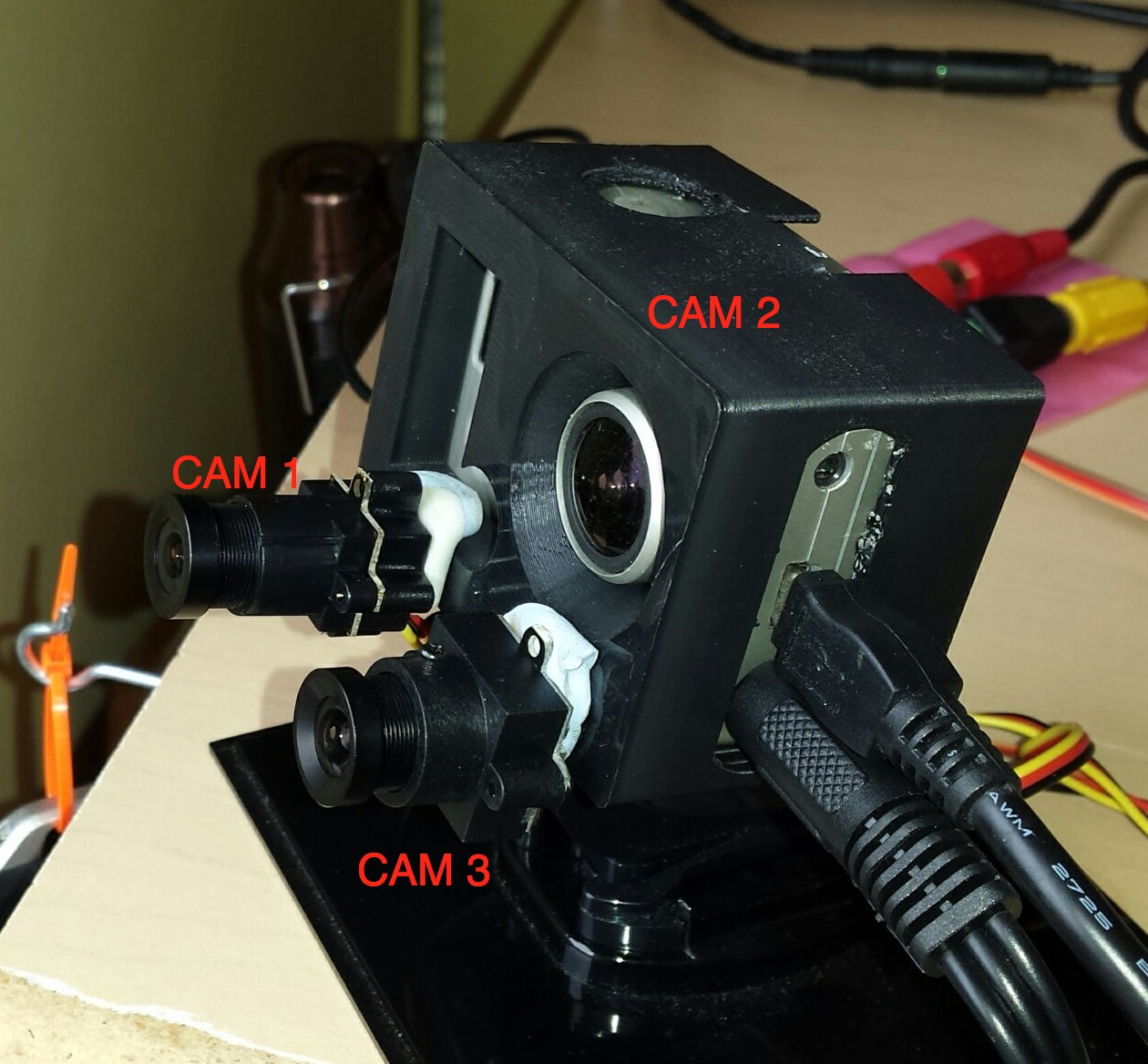

Cameras 1 and 3 are two different models from HobbyKing. They were nearly identical in price, and spec... but I wanted to Hedge my bets to see if there was a difference. So far, Camera 1 is only marginally better, as it has a slightly better build quality and image. A nice element of camera 3 is that it has a set screw to lock the lens in place once you have it focused.
EDIT: After playing with the cameras after dark, I can now conclude that CAMERA 1 is the best of the $20 cameras!
I reviewed OSD options in a previous post.
I reviewed the RCCC in a previous post. In short, it is AWESOME!
Here is what the system looks like:
ROV Video System Components
ROV Video System Components.jpg (478.85 KiB) Viewed 50452 times
Here is a close up of the cameras:
ROV Cameras CLOSE-UP
ROV 3 Cameras CLOSEUP.jpg (306.6 KiB) Viewed 50452 times

After further review (night time use) I can safely say cam 1 is the clear winner!
Much less noise and a sharper picture in low light! Will work on trying to get some samples posted so you can be your own judge...
