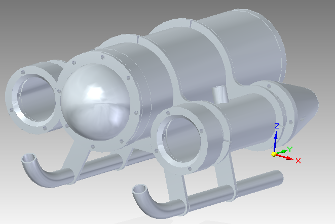

It began with a lot of work in the 3D software Solid Edge.
ROV 3d samlede.png (104.43 KiB) Viewed 4158 times

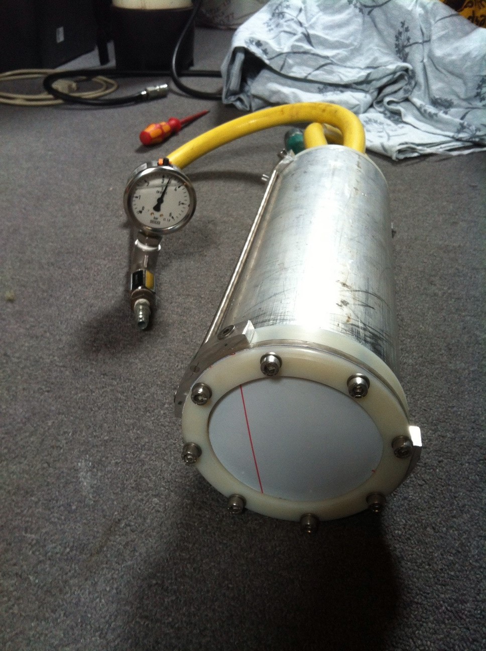

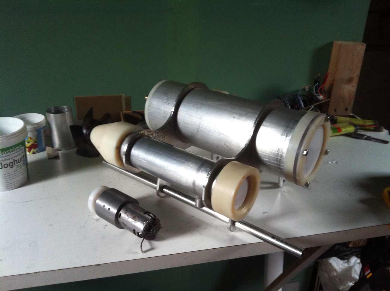

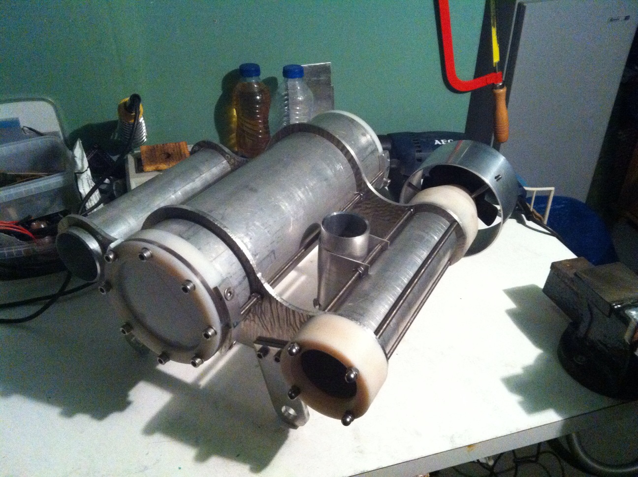

Then I went to the workshop and after a lot hours I got this.
And it passed the pressure test to at least 35 m.
More pictures are on its way.
