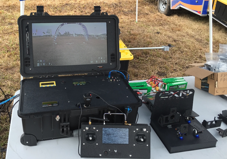

Ground Station = Pelican style case, 19" Widescreen LCD or 12" Sun-readable monitor, 4ch SSD DVR, custom 9ch radio controller, 19Ah SLA battery.

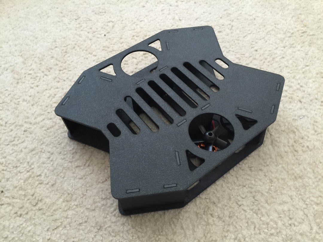

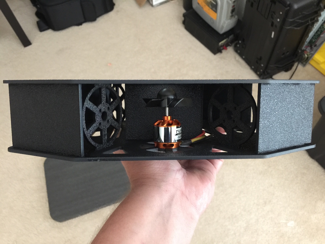

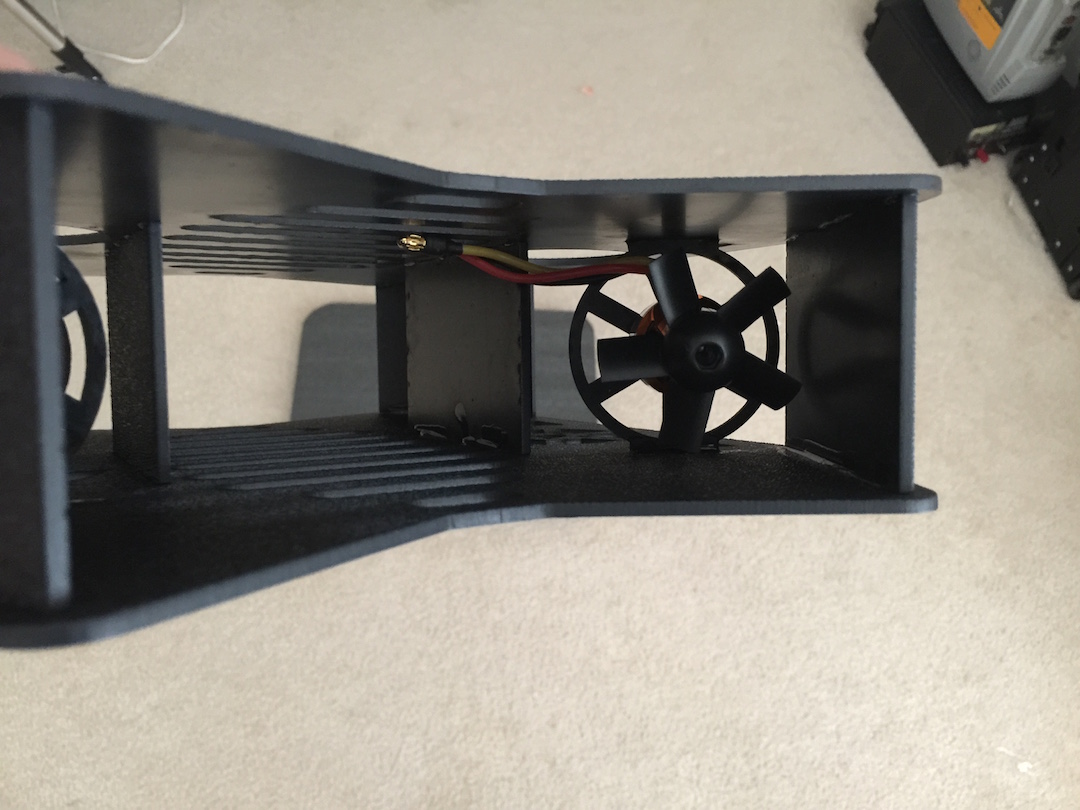

So far here are some pictures of the frame I'm making (Laser cut high impact ABS) motors and propellers are not the ones I will be using, but you get the idea on how it would look like. The ground station monitor and case is the one I will be using but with a different bottom plate.
I will post more pictures as I go, any input will be appreciated too.

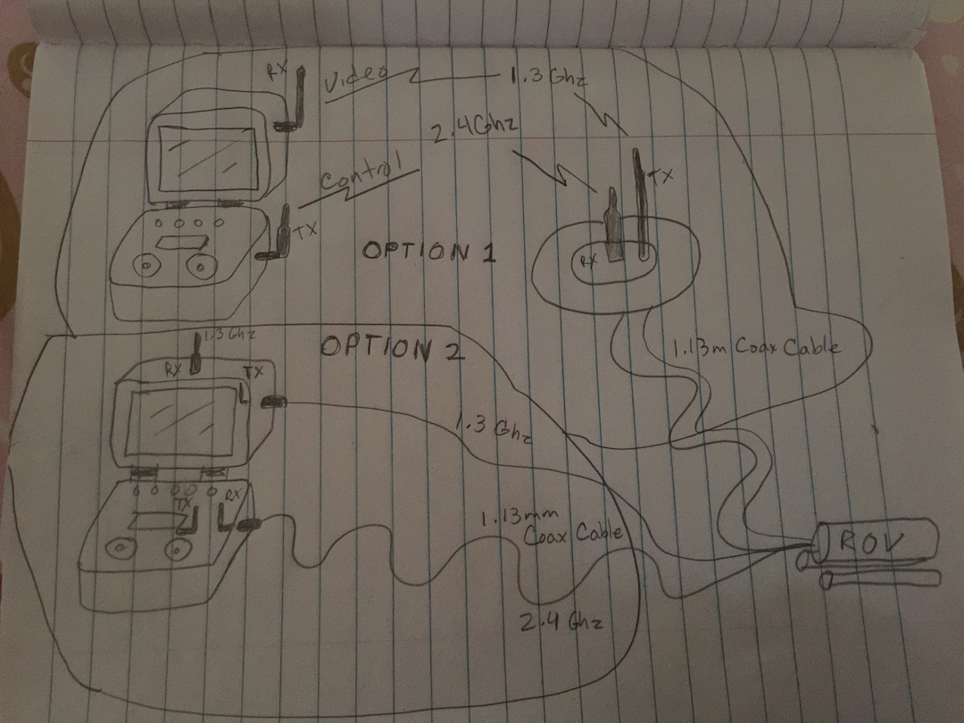

But another option will be using a normal 2.4ghz radio control TX/RX.
RX will be inside the ROV with a very long 1.13mm flex coax cable and then the antenna portion will be by the ground station. I will make a diagram and post it soon.
Here are to option that might work, assuming the coax antenna cable doesn't break.

Welcome crd, and nice design with the laser cutting etc. I can appreciate why you are wanting to use coax, but be aware that thin coax is very "lossy" ie, has high attenuation at the frequencies you are using. Looking at a data sheet, at 1GHz it is about 1.5dB per metre, meaning that for every two metres of cable the signal is halved in strength. I don't know what this translates to in usable length, but it won't be much, even if you plugged directly from transmitter to receiver, which could do damage to receiver anyway.
Dropping the frequency would allow greater tether length, but you will have trouble sourcing RC and video transmitters and receivers for lower frequencies.
Option 1 in your sketch would be good if you put the radio gear in the buoy and ran the camera and ppm signals through the coaxial cables.

Any input is appreciated, I might be able to find some 27mhz and 40mhz R/C TX and RX's but they are limited. I would like to try the PPM signal without any control TX or RX via cable first. Can't wait to start building it, I'm just waiting on some electronics and the propellers.rossrov wrote:Welcome crd, and nice design with the laser cutting etc. I can appreciate why you are wanting to use coax, but be aware that thin coax is very "lossy" ie, has high attenuation at the frequencies you are using. Looking at a data sheet, at 1GHz it is about 1.5dB per metre, meaning that for every two metres of cable the signal is halved in strength. I don't know what this translates to in usable length, but it won't be much, even if you plugged directly from transmitter to receiver, which could do damage to receiver anyway.

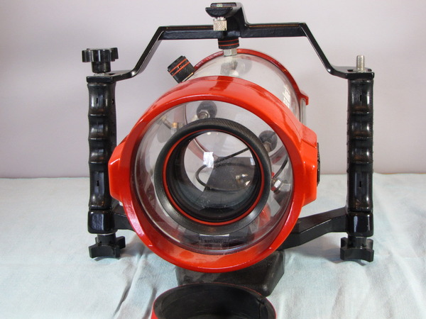

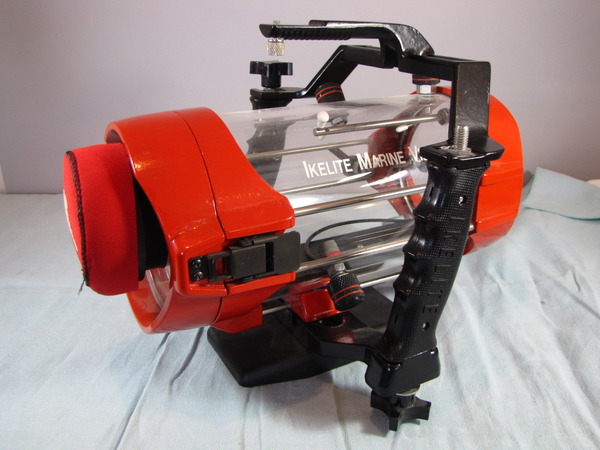

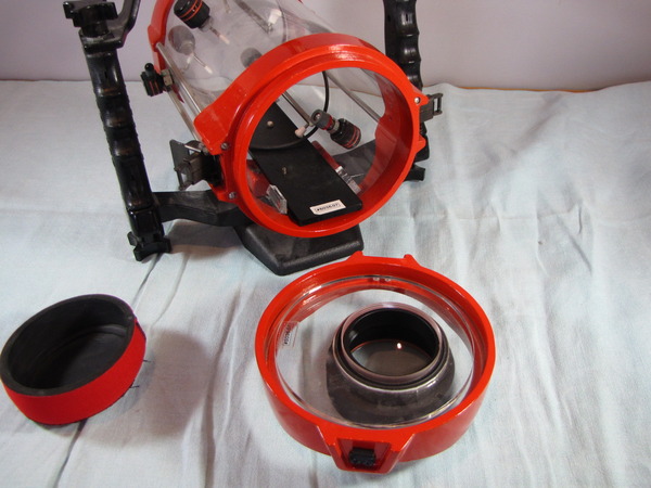

A little update, I was planning on making a custom hull, but I found a nice waterproof camera housing on eBay that might fit my bill for now.
for $75 shipped is worth a try.
- img_4334.jpg (73.77 KiB) Viewed 9414 times
- img_4335.jpg (77.83 KiB) Viewed 9414 times
- img_4331.jpg (71.68 KiB) Viewed 9414 times
