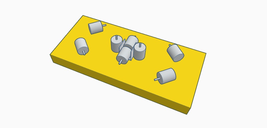

OK so I've attached a little mock-up of my ROV design, Codename...... BindoROV1
The buoyancy is Low Density Buoyancy Foam rated to at least 300msw :roll: , i managed to score an offcut, which should be more than adequate for my needs.
The "frame" so to speak, will be either wet or dry, i'm not sure yet, but it'll be made from 10mm airline and festo push fit fittings.
The thrusters are 8x 21mm 1.5-6v DC motors (£0.60 each!), they will be run in parallel, controlled topside by 4 escs, giving fore, aft, yaw, dive/surface, and lateral movement, according to my calcs based on a 10 - 15m tether, using an 8.4v supply, i should end up with more than 6v at the motors at full chat. this puppy won't be fast, but she'll have 5 axis of freedom!
i know i could have had lateral movement with just the 4 vectored thrusters, but it's more of a redundancy thing, more things to go wrong etc,
The camera will be either an £8 parking camera or a spare board camera, running to my FPV screen, or laptop USB DVR.
The obligatory GoPro camera will be mounted on top, with additional buoyancy/ballast added as required
The illumination will be a spare 5V LED module i had lying around for my quadcopter, in pipe fittings, controller by a 200k logarithmic potentiometer for dimming.
the tether will be stranded cat5e, probably 8 pairs will be needed, with closed cell foam on standby should i need it to aid buoyancy.
I'm not planning win MATE or anything with this project, just dipping my toes in the water so to speak.............For now............ 8-) :lol:
Bindo
Motor/Thruster Layout
mock motor plan.jpg (35.79 KiB) Viewed 24778 times

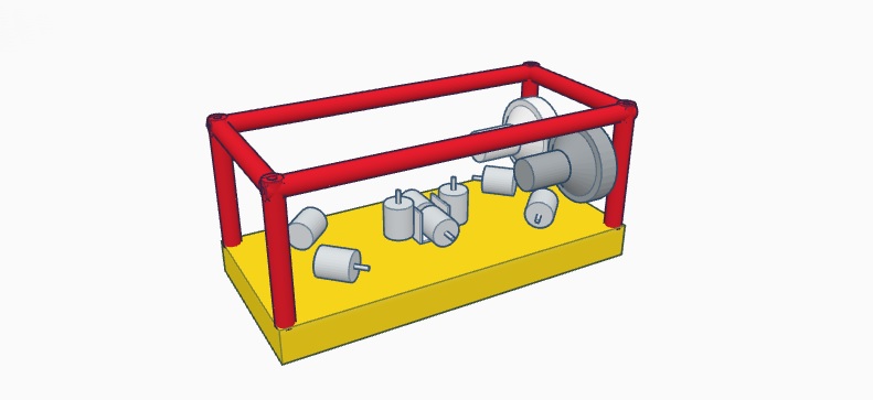

1x LED lamp and 1x camera in 1" pvc pipe fittings

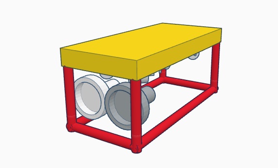

underside
underside

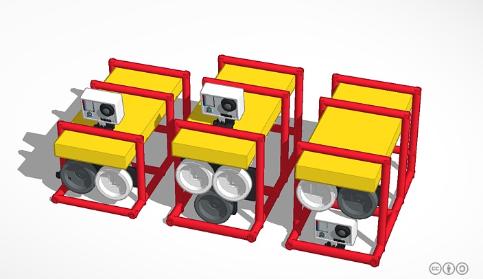

Still in the planning stages and throwing ideas around.
I reckon i'm good for buoyancy, so may have to add ballast to offset the gopro, as opposed to adding more buoyancy.
i'm swaying towards the far right, forgoing a light, for a gopro..... at least everything is contained in the crash frame that way and it keeps the COM lower than mounted on top.
another few mockups.

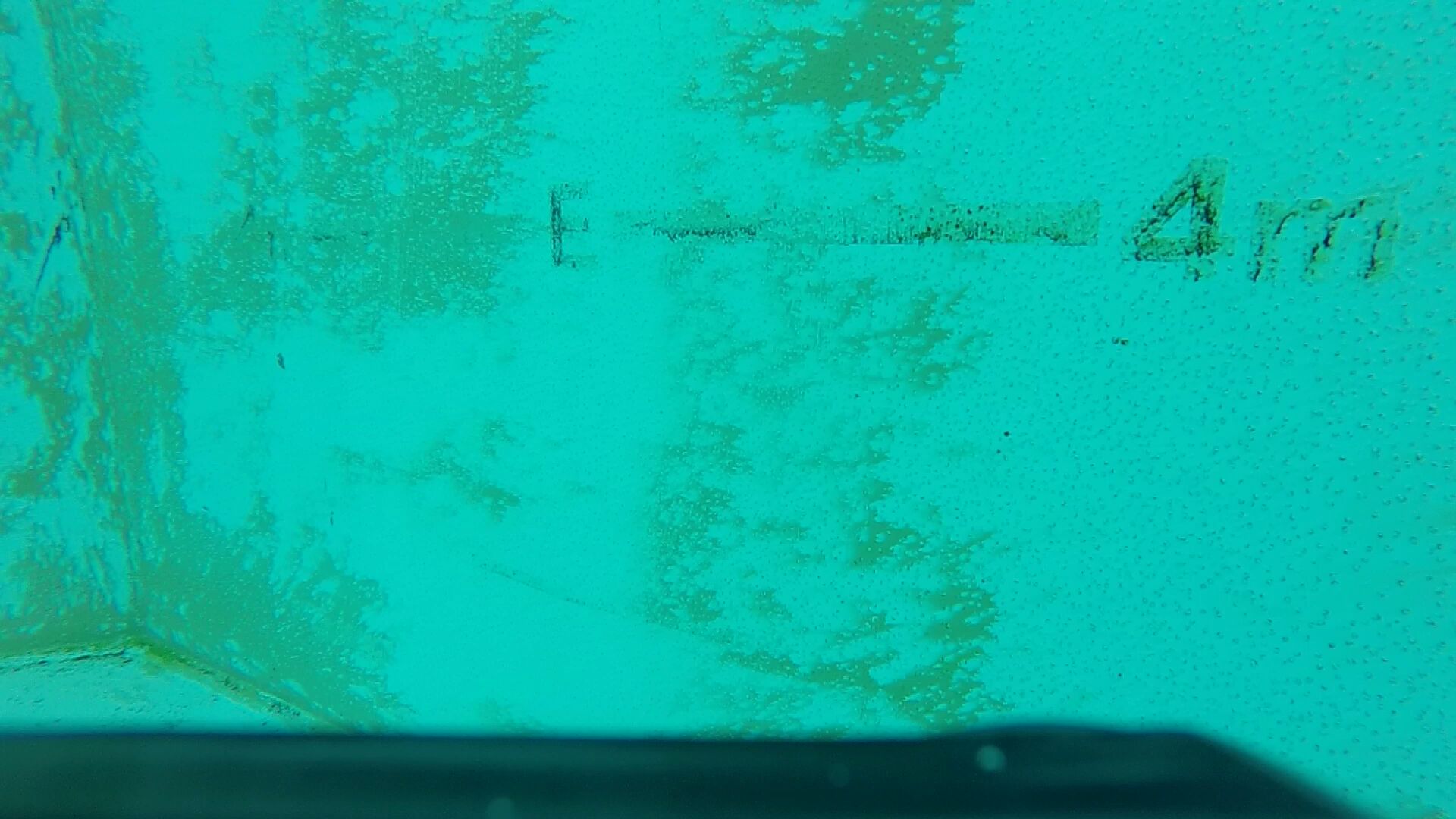

Well the build is finished. .... kind of. Still have a little tidying and finishing to do, however my first dive went well, 5m and my camera and lights held up well, couldn't find a single drop of water in either housing.
The first proper dive is tomorrow, hopefully have some nice footage for you all. I've added a little hook for manoeuvring a hook that's to be deployed from the surface with mandraulics lol, hoping to recover some junk from the local reservoir.
