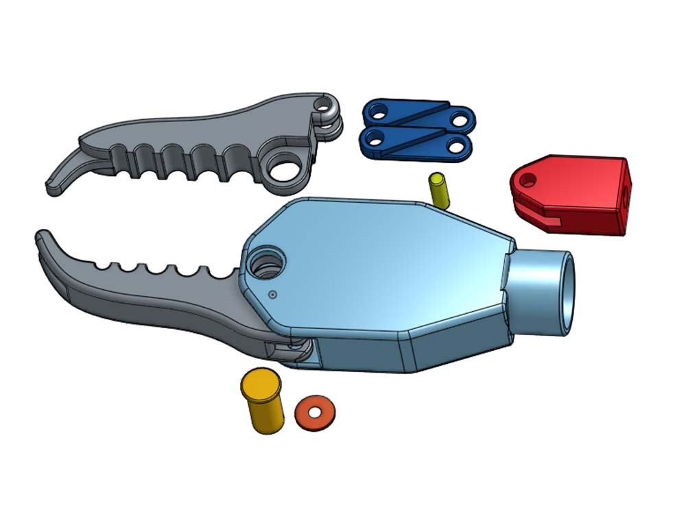

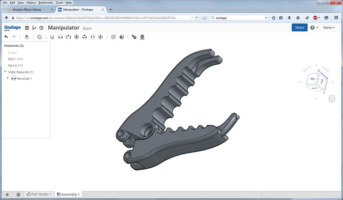

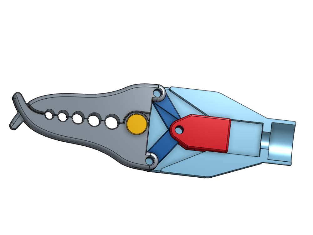

I was introduced to this new online based CAD program the other day called Onshape so I decided to design this a new Manipulator to see how well the program worked.
After a few hours of work these are the basics parts of the design that I cam up with. The hand and gripper finger portions of the manipulator will be 3D printed and attach to a PVC arm and motor housing much like some of the other manipulators that I've done in the past.

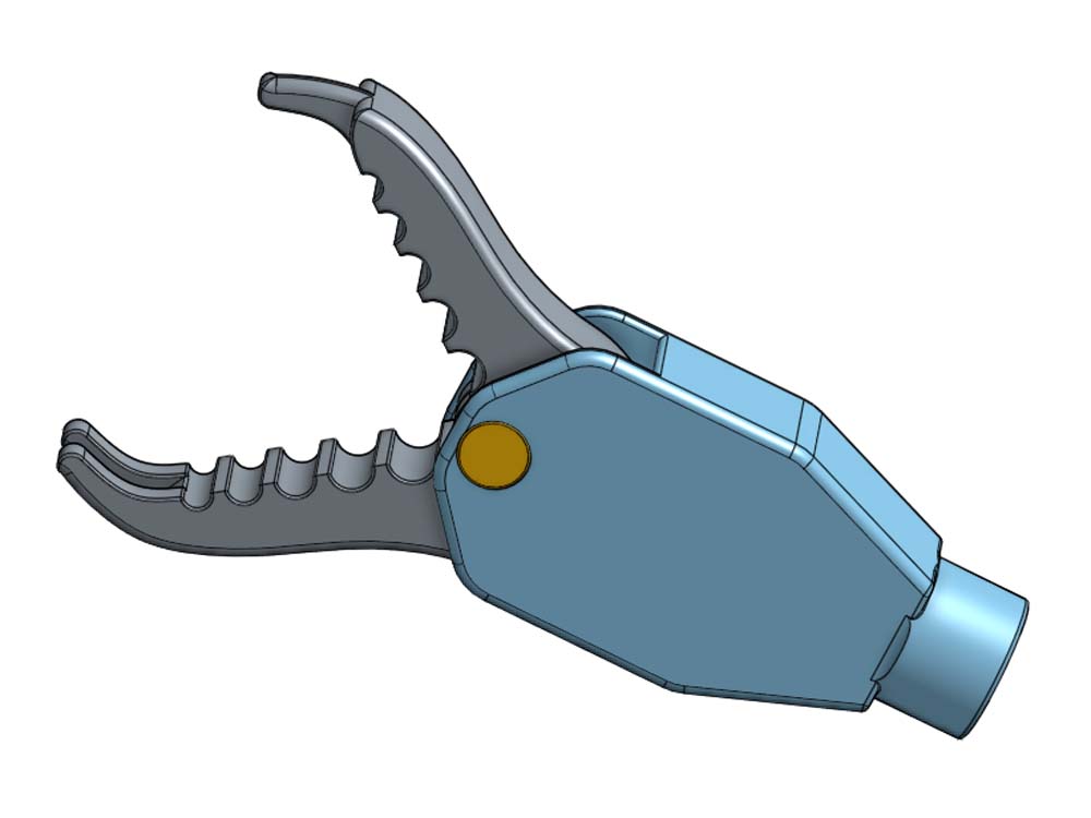

This is what the parts will look like when assembled.

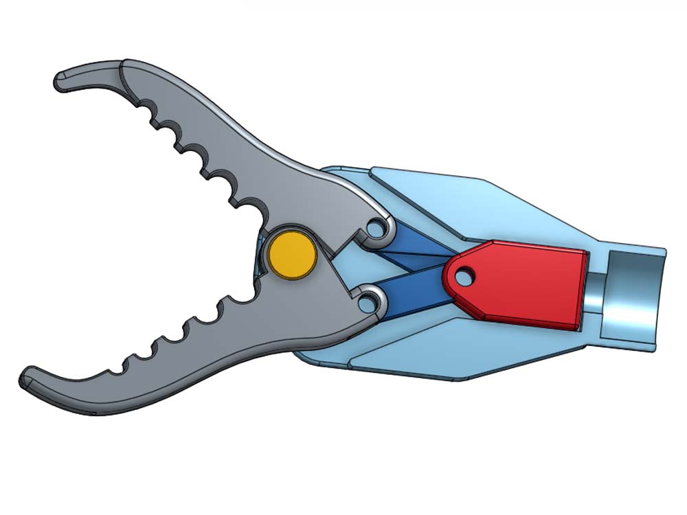

Here are a few cut away views to show how it works.
It will work of the same thread rod principle I have also used in the post. The actuator rod (not shown) will thread into the red slide block.

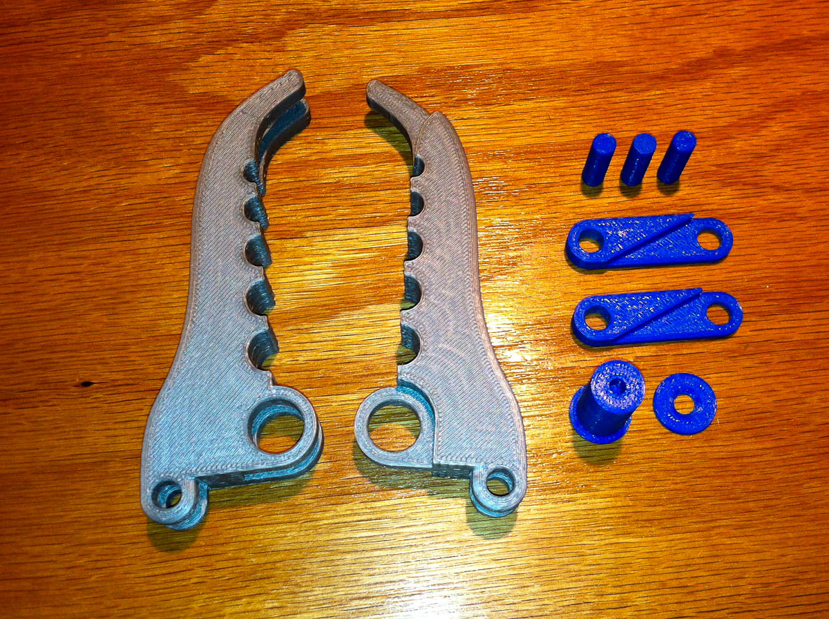

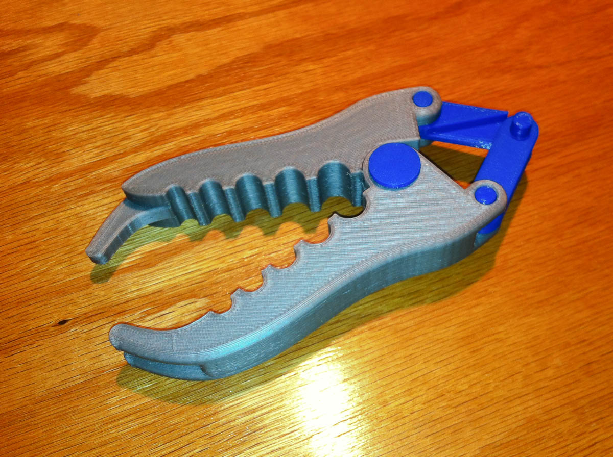

I've already printed out some of the parts at this point.
The basic mechanics seem like they are going to work I just need to print the main body of the hand. This will probably take a good 4-5 hours so I just need to find the time to do this now.

I haven't started drawing up my manipulator yet, I might steal some of your ideas ;)
I am a little concerned about the strength of those pins though. Keep us updated!

The Pins??? Hell I'm concerned about the strength of the whole thing, :lol: but yeah this will be a good test.
Updates will continue shortly...... the hand portion is printing right now. :grip:

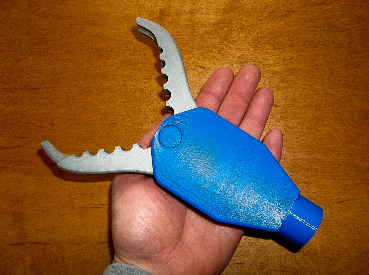

It's looking good so far. It's a little bit bigger than I envisioned though, I think it was about half this size in my head. :|
I need to print the slider next I'm just waiting on a special nut that will get imbedded into the print for the threaded rod.

I have been playing with Onshape, the free version. That also looks very good! At this time I use OpenScad for 3D Printing and Freecad for modelling. Onshape looks like it may do all those things but will need some practice to become proficient, I am a beginner in terms of 3D CAD.
