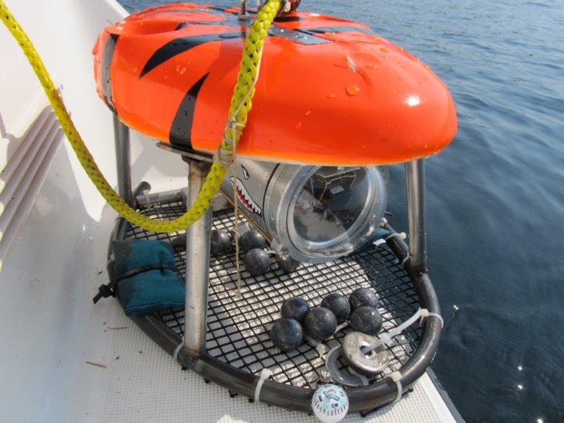

Affordable Syntactic Foam options or Macroballoon sources?
Post by TigerShark »
I thought this stuff called Last-A-Foam would work but it is only sold in full sheets 4x18x100" and that is over $1300. R-3325 is good for 1200' water depth. I need 1000' working depth.
Any other options anyone knows about for small quantities?
Another option I am looking into is making my own. I can get micro balloons but would need macro balloons as well to keep the density reasonable.

Good Find... I didn't know Blue Robotics was carrying this... I was just in the process of trying Fiberglass coated blue home insulation but this is making me rethink that as the R-3312 would definitely work. The price is not to bad either.

My fiberglass covered foam insulation board didn't make it to 65 feet without crushing quite a bit. Lots of small bubbles when I brought it back up and it was a lot heavier!
