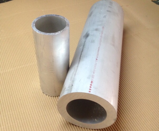

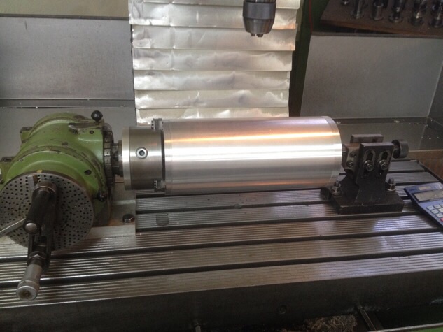

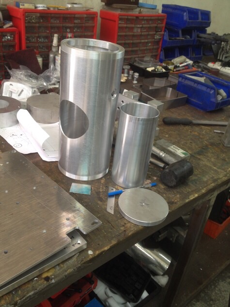

The hull is made from aluminium tube 6061 T6 with 4 mm wall thickness after working with lathe for hours

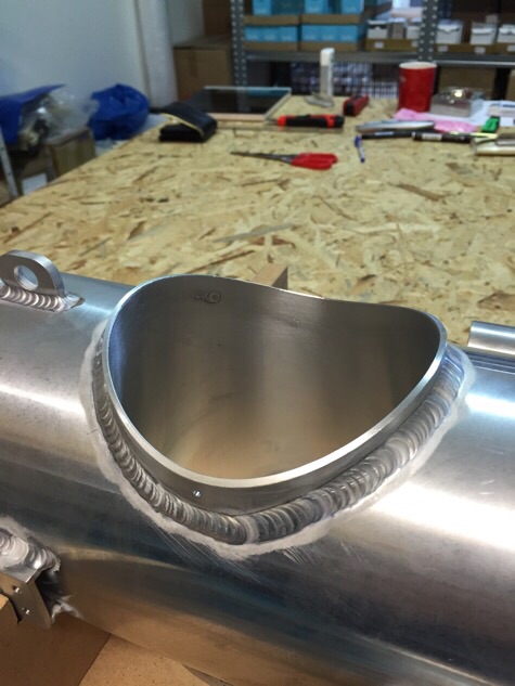

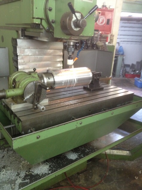

Ready to drill the hole for ascent-descent thruster

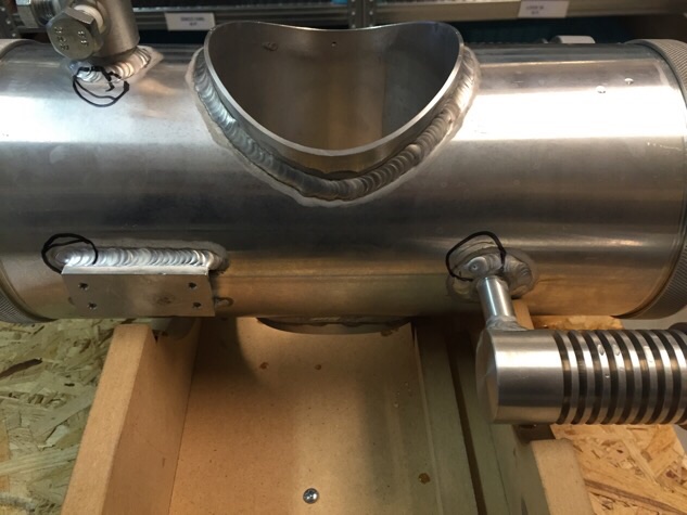

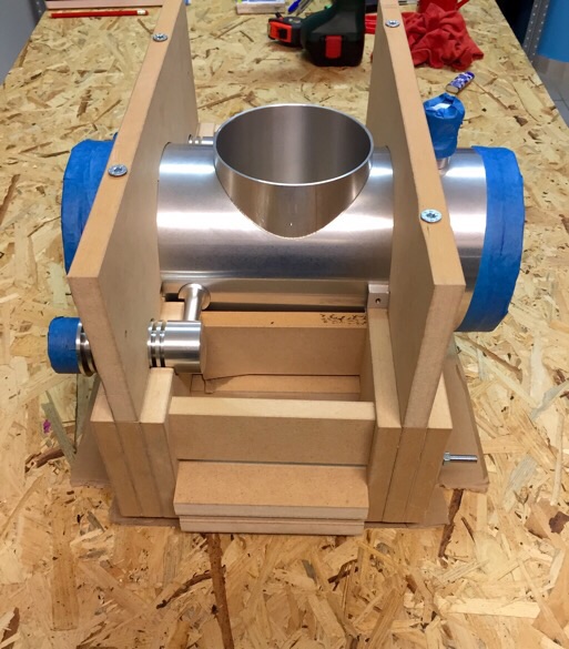

And these are the hull parts ready for welding

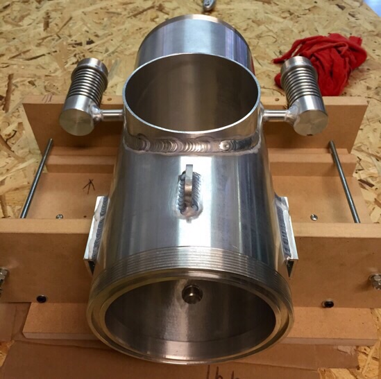

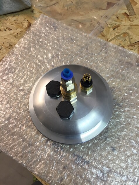

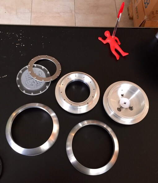

And the endcaps are finished too

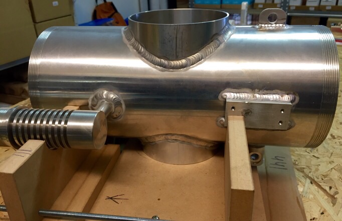

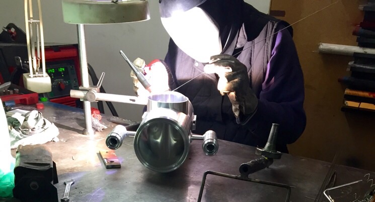

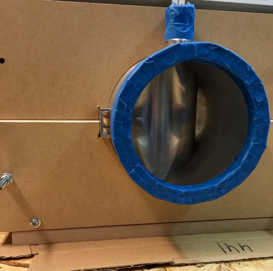

I made a wooden support frame for all pieces to stay aligned for welding and protect the oring grooves with tape
And finally the big time :D
Bubbles

And it's done
Next thing was to trim the vertical cylinder a bit

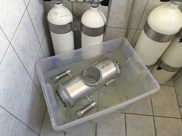

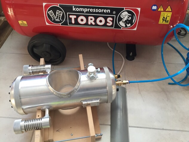

Next thing is to pressure test weddings and check for any leaks.
I assembled endcaps and fit them to the main hull and fill the hull with compressed air up to 5bar
And the moment of truth

And after an hour playing and checking for leaks I noticed tiny bubbles at three different places
:oops:
S.....t I have to fix the leaks
