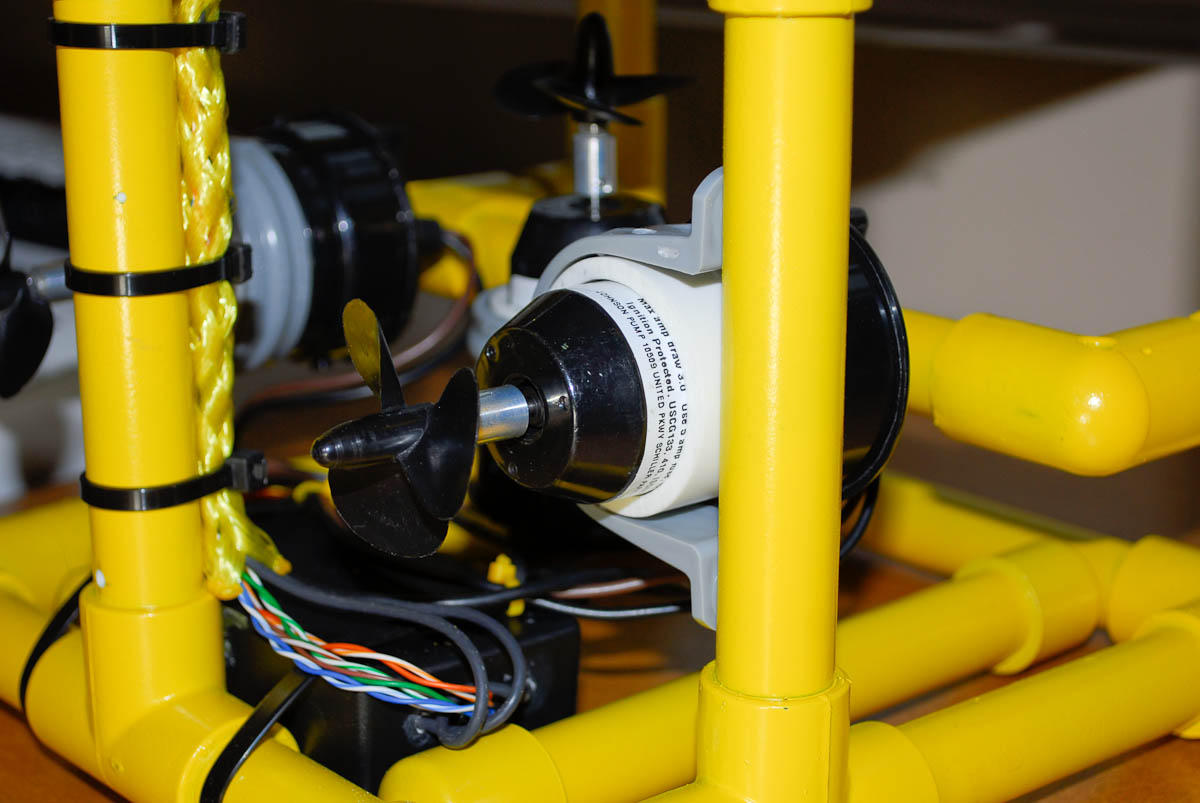

This is another project I have been playing around with again too. I tried making a few Kort nozzles back in the day out of PVC and while none of them gave me more thrust I did have a little luck with one that actually dropped the amps draw during one test. This is going to be designed around the Mairfair 750 GPH bigle pump thruster that I normal test although it could be easily changed to fit other pumps I think.

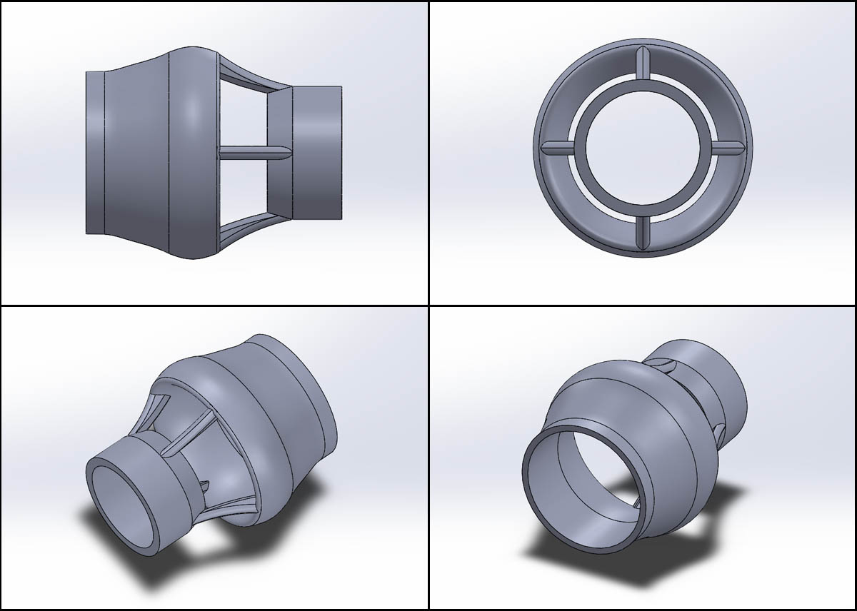

... and this my first design I'm about to print out. If it works out I might incorporate the mount right into the nozzle design too.
Off to the printer it goes....... :D

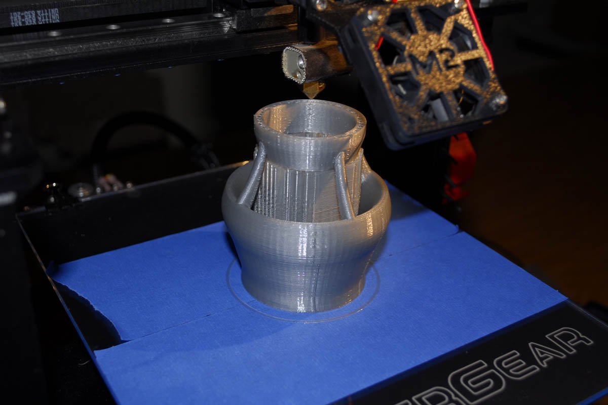

Here it is in the process of being printed....

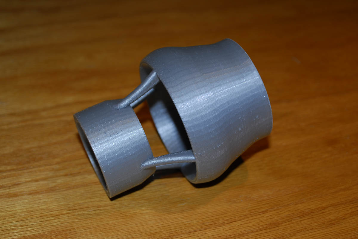

...and after about 2.5 hours here is the finished product. It's a little rough as I printed it on a fast setting and low infill just to see if it actually fits.
Unfortunately my dimensions where a little too tight and it was weak with the low infill so I broke the support arms trying to force it on to the pump. :oops: :cry: I changed a few things and printed another one but it was late by the time it finished so I didn't get to try the fit on that one yet. Hopefully tonight I'll have a little time to try it.

Looks the biz Steve, hopefully it works a good as it looks.
I've never played with 3d printing, how strong is the material you use?
Re: Bilge Pump Thruster Kort Nozzle
I really don't know how to classify the strength of most of these 3D printing materials, there so many to choose from these days. I'd say the main to materials though are ABS (Acrylonitrile Butadiene Styrene) and PLA (Polylactic Acid) ABS is probably stronger, well it's much less brittle away. These were just printed in PLA which is probably good enough for testing but I'll probably redo them in ABS or PETG (I've been hearing good things about this stuff) once I figure out if they are worth running or not.
