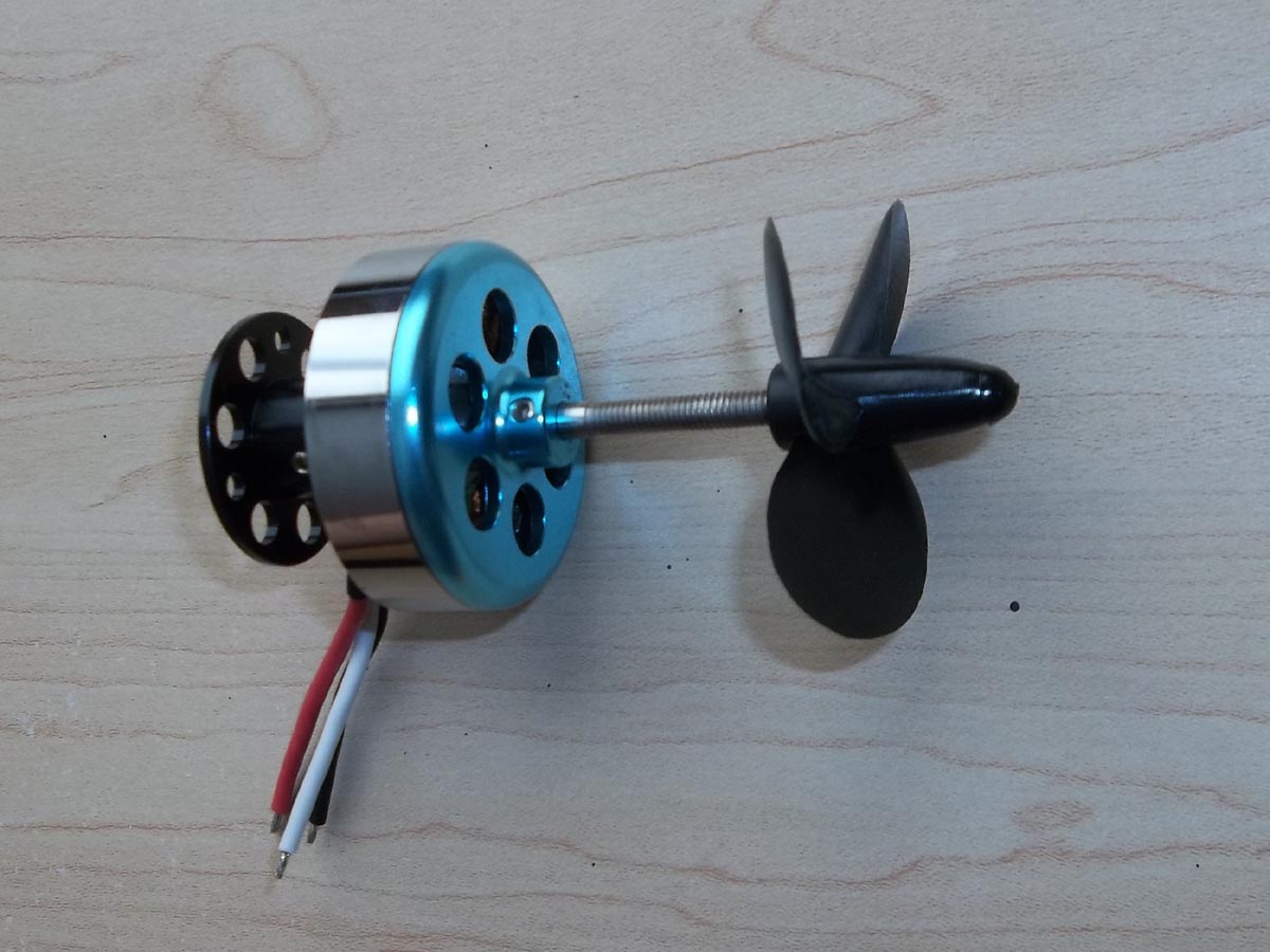

While I was testing out the BlueRobotics T100 and my Magnettice drive thruster today I though I'd quickly test this motor also hexTronik DT700 Brushless Outrunner 700kv motors I bought this awhile ago because it already had a 4mm shaft so it fits most of the props I already have.
With a 3 blade 50mm Robbe prop it put out a max of just about 5 lbs of thrust. I'm not sure of the amps at thrust because my meter is a POS, but at 3.5 lbs it was drawing around 11 amps.
I also tried it with a 60mm prop but that only put out 4.5 Lbs at a staggering 18 amps.
Running it straight in the water would probably make it disposable after a while, maybe with a little epoxy coating it might last longer but overall for a quick cheap $13 thruster the results were not to bad.

The most thrust I get out of the bilge pumps is around 2lbs (less after the voltage drop) but for normal use I find it plenty. (Keep in mind you'll hardly ever use full throttle either with a 6+ lbs of thrust)
My goal for any thruster I ever tried to do was 4lbs, which is why I was excited when I got that with the Bluerobotics thruster at a reasonable amp draw.
I think at this point I'm pretty much done trying to reinvent the wheel, I mean I still have thruster things I want to do just to see if I can do them but as far as thrusters go a simple exposed brushless setup works good enough for me. I might even build another Rov around the Bluerobotics thrusters but to go that route I would have to learn a lot more about programing to come up with control system.
