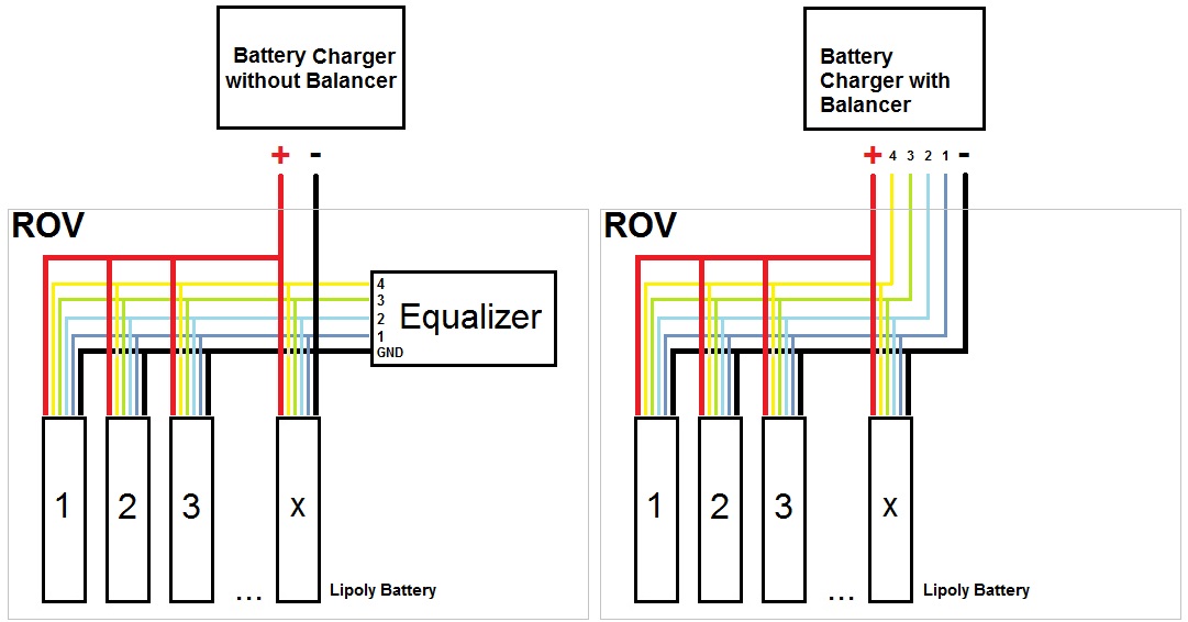

I've thought it would be better to see how to connect your (4S=14,8V) lipolys cause I was previously uncertain, too.
If you use a equalizer (not a balancer) inside the ROV you don't need to bring out balancer-outputs.
There is no need for main fuse because you need a fuse for every circuit.
Don't worry, a short-circuit (without fuse) burns until all lines before it harms the lipolys fatal. I've seen AWG 12 cable melting down and the lipoly-pack just "smile"... so you can be sure all cables gone before your lipoly will burst.
the greatest danger for lipos is (cell)undervoltage (under 3,2V). It will fatal damage and blow out your pack.
EDIT: BE CAREFUL before connecting Lipos - load them to ~3.85V per cell. If there is a high difference between connected cell they balance(load the weaker one) with HIGH CURRENT. So be aware that cells are +/- 0.10V before connecting.

Interesting. Could you post a link to what this equalizer actually is?

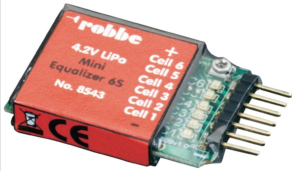

Robbe #8543 - 6Cell Mini Equalizer 130mah
Link to description PDF(international)
http://www.robbe.de/media/download//i/n ... zer-6s.pdf
Really tiny and logical module. An equailizer starts balancing cells if top-voltage exceeds 4,2V (while loading) with 130mah. LEDs show you status and balancing-mode of each channel. You cannot use it parallel to charger still have balancer (connected) Only use LIPO (not LIION) Battery charger(mode). With an equalizer it could be the charger will find no end in loading. This is caused by equalizer starts at 4,2V and if all cells at 4,2V its burns the rest of loading current to protect cells from overload. This module will get warm (not hot) but should not be used packed side by side with lipopacks.
There are only germany sellers, but will get it into my shop if youre interested.
* a balancer (which has no need to "start" manually) still working if connected will only need power all the time. Equalizer have no stand-by power-consumption.
BOTH, equalizer and balancer do not prevent cells from undervoltage!
