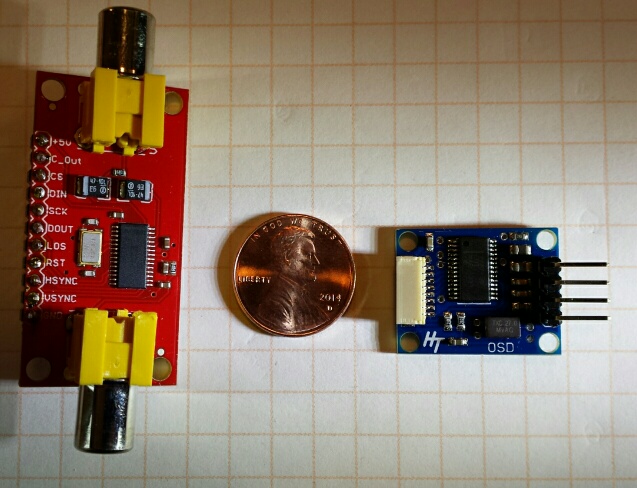

Front of OSD
Front of OSD
OSD Front Side.jpg (113.32 KiB) Viewed 56078 times
  • HobbyTronics
    PRO:
    It works!
    It is much smaller. (Better for Small ROVs!)
    It comes with holes on the PCB for mounting
    Pre-Installed 8-pin JST socket on the board for power and SPI connections, and is supplied with a matching wired plug.
    Cons:
    Less of the MAX7456 functionality available.
    (Only Video in, Video Out, SPI coms, Reset, and LOS pins are available on the breakout.)
  • SparkFun
    (Ignore the fact I never got it to work!!)
    Pro:
    RCA Jacks pre-installed
    HSYNC and VSYNC are available
    More documentation and sample codes available from seller
    Passive (Video is passed through, even if BOB is not working) (Never tested this with HT OSD)
    CONS:
    Never got it to work!!
    Requires additional tinkering (adding resistors/Capacitors) to work
    Larger form factor with RCA jacks preinstalled

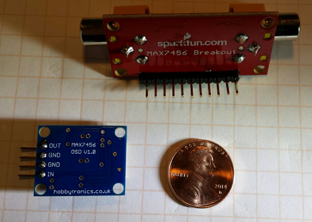

Back side of OSD
Back side of OSD
OSD Back Side.jpg (87.73 KiB) Viewed 56078 times
Worth Noting:
Both BOB come without any header pins soldered in. I have added those for my testing.
Conclusion:
With it's smaller form factor and Out of the box funtionality, I would go with the HobbyTronics MAX7456 OSD Break Out Board!

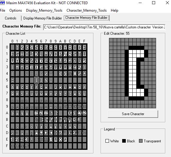

I doesn't understand how "print" function works in max7456 library! If i want to print a font like the symbol of temperature "°",
Code: Select all
OSD.print(F("/xD1"));
that is in "D1" of the font file .mcm, it appears on screen, if i try, for exemple,
Code: Select all
OSD.print(F("\x55"))
to display "[" font, "U", that is in "x1F", appears!
How are fonts mapped?
Fonts Maps_mcm.JPG (94.71 KiB) Viewed 55029 times
vinsub
Posts: 16
Joined: Sep 11th, 2015, 2:31 am
Re: OSD - On Screen Displays - Review
Post by vinsub »
Ok, i understand the code of osd, i changed "W" in mcm file by max software and i use i2cdev library to activate dmp of mpu6050. I compens compass for roll and pitch and i add a beautifull compass view!
