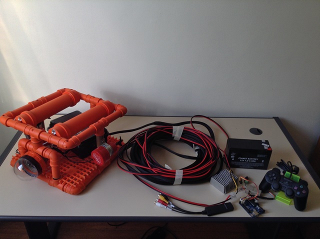

A few months later, many days and nights of work, here it is.
Soon I will be doing the test in the pool, then in the beach. More details in a few days.

Re: ROV from Brazil,
Posted: Jan 26th, 2015, 3:01 pm
It's looking great, let us know how the testing goes.
