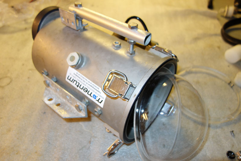

I'm Magnus AKA Kale from the southern part of Sweden. I have been scuba diving for many years now and I have carried out a lot of video filming under water. My father helped me building my first video housing many years ago (He is not with us anymore). The housing is made of stainless steel and I have always seen it as a great ground plate in an future ROV project. The future is here now and I'm looking around the web for input.
My plans are so far:
Control:
Before I found this place I was planning to control the ROV with one Arduino UNO at the surface and one in the ROV, communication via RS485. Having seen several successful projects using RC-controller via DSC (direct servo control by wire), I'm in doubt…
Thrusters:
Four unprotected brushless outrunners equipped with rc-boat propellers. Two at the rear and two on the sides for up/down.
My video housing is going to get new clothes...

Welcome,
That tube looks like a nice starting point for a ROV :) only then you cannot create any cool underwater movies of the ROV in action anymore after the build.
Have fun building.

Wow! great 'pod' how deep have you used it?
Also is it positive buoyant in water? What kind type of camera did you use (& will it be the same in the Rov?)

Hi guys and thanks!
It's more than ten years since I used the housing. It was originally constructed to contain a Canon Hi8 camcorder. The last camcorder I used in the housing was a Panasonic 3CCD DV camera. Then I bought an aluminum housing for the Panasonic camcorder and the old "Miss Piggy" was retired after a long and faithful service.
I have been down to about 45-50 meters with the old housing. It was equipped with a 10 mm flat plexi on the former rear side. As you may see I have shifted so the former rear side is now the front going to be equipped with a dome. I'm sure that the housing can withstand several hundred meters with sufficient thickness of the dome.
It weights about 5 kg and is slightly positive buoyant when empty. I will adjust the buoyancy with a some foam on top if it is necessary.
My plan is to use a high definition Full HD board camera. Like this one maybe:
http://www.ebay.com/itm/151122186572?_t ... EBIDX%3AIT
It's a HD-SDI camera. I assume that the signal is hard to transfer so I plan to record the uncompressed signal within the housing and transfer a compressed signal to the surface monitor… Well, thats the plan of today. Let's see what tomorrow brings…
