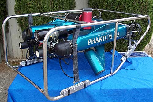

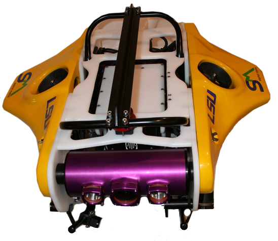

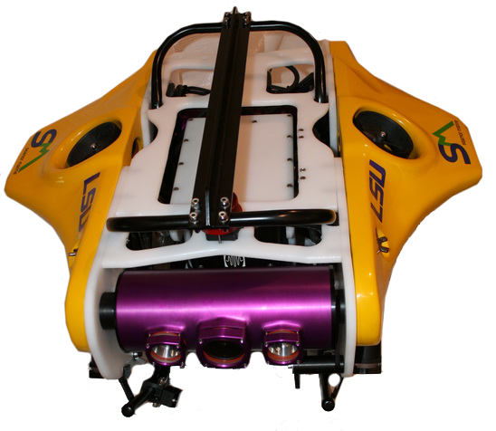

These two Rov's have two different kinds of 'Hull' & Frame.
This has a crash metal frame
This is  a hull rov.
This is a hull rov.
