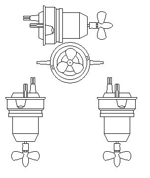

Danny I just sent you an email too but I'll reply here too....
I think you would be better off with a thruster configuration like shown above. (top of picture would be the front of the Rov) This way the duel thrusters in the rear are used for forward/reverse as well as left and right movement, (and it will give you twice the power) the vertical thrusters is for up/down, and the other thruster can be use for just lateral movement. (The Vertical and Lateral thrusters should be on the center line of the Rov and they may have to be stacked to fit or look at the placement I used on my Seafox Retrofit Rov.
If you use a standard configuration setup like shown you can you my relay and arcade joystick setup for control, seen here http://www.homebuiltrovs.com/howtorelaywiringdpdt.html you would just have to add another switch/relay for the lateral thruster.
