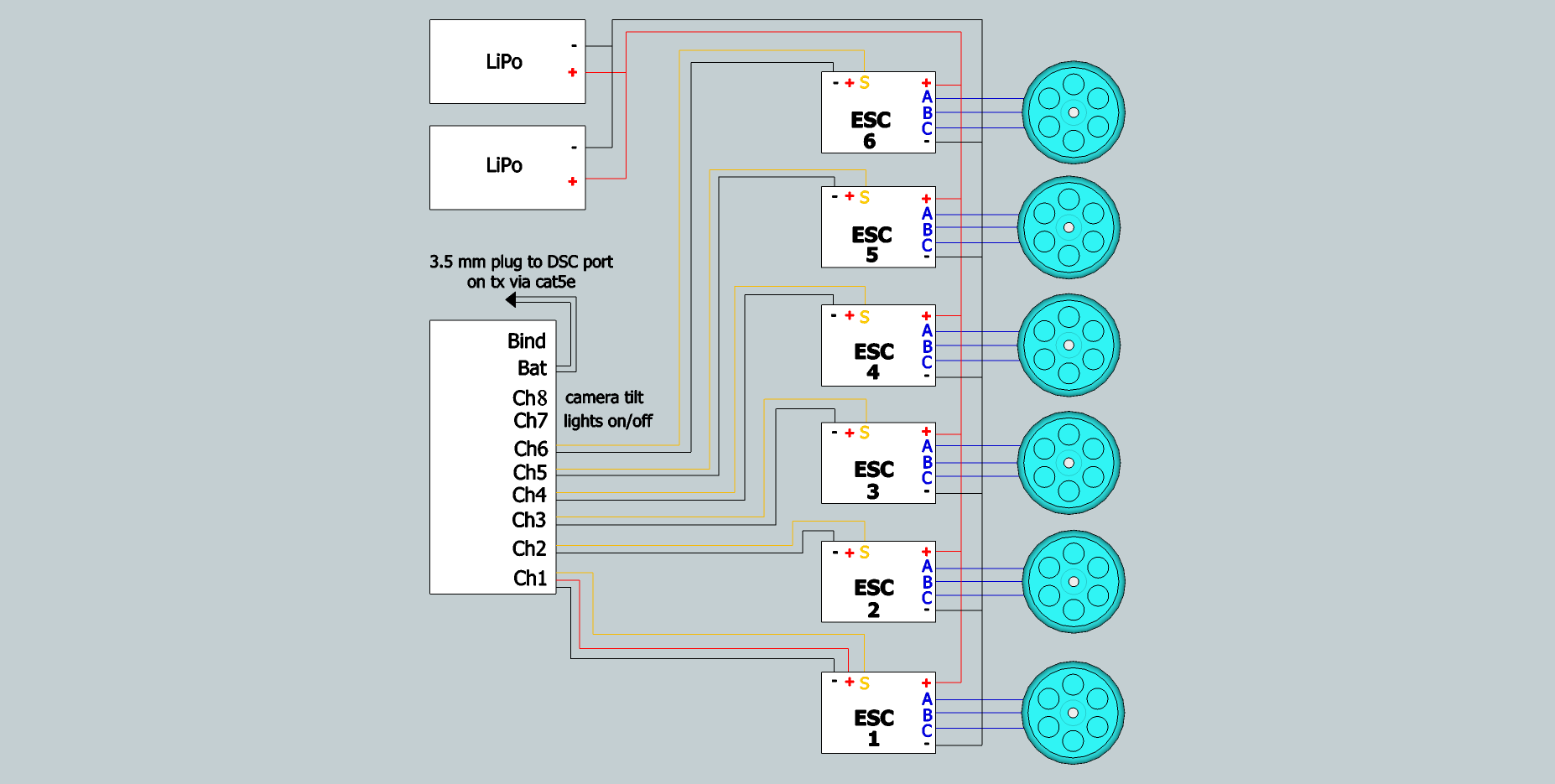

Does this look correct to you guys who know ? My set-up is :
Turnigy 9X 9Ch Transmitter w/ Module & 8ch Receiver (Mode 2) (v2 Firmware)http://www.hobbyking.com/hobbyking/stor ... ware_.html
6 HexTronik DT700 Brushless Outrunners : http://www.hobbyking.com/hobbyking/stor ... ch=dt%20ex
6 HobbyKing Brushless Car ESC 30A w/ Reverse : http://www.hobbyking.com/hobbyking/stor ... verse.html
50 mm Robbe props - 3 left and 3 right. Each set of thrusters has counter-rotating props.
wiring layout for Turnigy 9X
horizontal thrusters : 1 & 2, vertical thrusters : 3 & 4, lateral thrusters : 5 & 6
Left stick :
  • up - 1 & 2 horizontal forward
    down - 1 & 2 horizontal reverse
    turn left - 2 forward & 1 reverse
    turn right - 1 forward & 2 reverse
Right stick :
  • up - camera tilt up
    down - camera tilt down
    strafe left - 5 reverse & 6 forward
    strafe right - 5 forward & 6 reverse
I am currently looking for an OSD to connect to my laptop ( or tablet ) to display depth, heading, etc. Any ideas or comments would be appreciated thanks.
-Bob

How are you allowing for communication between the transmitter and receiver? Radio waves don't penetrate water well. I used ppm-pwm converters from foxtech for my two rov builds so I can run the signal tether from the trainer port on the tx to the converter.

It looks like he will have a 2 wire tether going from the ROV to the DSC port of his transmitter. This is the method I was looking at before I found the X3 control.

fireslayer26 wrote:It looks like he will have a 2 wire tether going from the ROV to the DSC port of his transmitter. This is the method I was looking at before I found the X3 control.
That's the plan. I have read about others on here doing the same. Here's just one. viewtopic.php?f=18&t=815
Do you have your X3 yet ? It looks great and would simplify things. Programming an arduino is not something I want to get into, so this ' plug and play ' system really looks promising.
scubersteve wrote:How are you allowing for communication between the transmitter and receiver? Radio waves don't penetrate water well. I used ppm-pwm converters from foxtech for my two rov builds so I can run the signal tether from the trainer port on the tx to the converter.
I didn't know I had to convert the signal. As I understand it, the 9X tx has a DSC port on the back that takes a standard 3.5 mm stereo plug. The plug is connected to 1 twisted pair ( 2 wires ) on my cat5 tether. The other end plugs into the BAT connection on the rx.

The issue isnt so much whether the tx has a port that outputs ppm signal (such as a trainer or dsc port) because many do, it's whether the receiver has a means to accepts such a signal (because many don't as 2.4Ghz doesn't typically use dsc functions)

You might want to consider this two wire bi-directional Arduino based system: viewtopic.php?f=15&t=1159 The author will have boards available in December and does offer them built-up except for the Pro Mini. The Pro Mini is easy to program with an FTDI cable that works off of the PC USB port and uses the Arduino IDE. I like Open Source firmware.
I have looked at the X3 and am concerned about the support from Germany. Presently there is no one on their English Forum which is not a good sign. I have worked with the Atmeg 2560 and 328 mcus that are on the X3 and use them for autonomous vehicle navigation in autopilots such as the ArduPilot Mega. Both the Pro Mini and X3 systems use a bi-directional communication system so the tether will be light weight if you put the batteries onboard the ROV.
Therefore I plan to go with njs552's Pro Mini setup for the present and wait and see how the X3 pans out especially in relation to hardware and firmware support.
