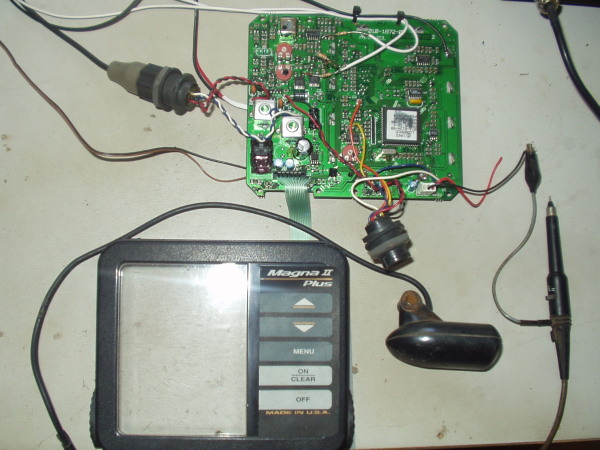

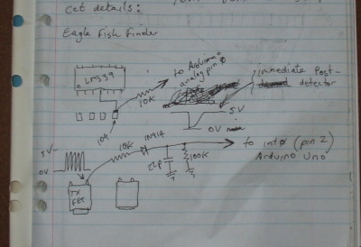

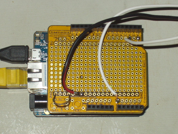

Been working on a primitive 2-dimensional SONAR that can be fitted to my as-yet-not-in-existence ROV to help with navigation and help in finding objects of interest. The plan is to show a small SONAR plot alongside the camera window. Move into camera visibility range with the SONAR, and then navigate/inspect visually via the camera.
The SONAR is designed around:
A modified (butchered) Eagle Magna 2 plus fishfinder and transducer
An EtherTen (Arduino Uno-like board that has built-in Ethernet) to get signals from the fish-finder and send collected echo data the surface
Netbook PC running the Google Chrome browser that can do graphics using HTML5 canvas
A stepper motor to "scan" the transducer over a given arc
Description of Operation:
Two inputs of the EtherTen are connected to the FF PCB via some resistors, a capacitor and a diode. One is an interrupt that lets the EtherTen's microcontroller know when a "ping" has been sent out by the FF. The other is one of the analog inputs that samples any echoes from the ping (reflections from objects). The EtherTen then sends data generated from the above process to the surface PC and displays in graphical form, much like a ship's RADAR or many commercial SONARs.
So far so good:
I was concerned that the A to D conversion time of the microcontroller may not be fast enough to capture echoes, but testing in a 2 metre tall/deep PVC pipe has given good results. What the results will be from open water and greater distance (weaker signals) remains to be seen. Calculating roughly, I think the conversion time gives about 80mm of distance resolution.
Copied then modified the code from http://startingelectronics.com/tutorial ... eb-server/ - very useful and well presented tutorial. Not the fastest way to send data, but I hope to be able to update a full 120 degree sweep once per second using this method
Display resolution at present is 16 arc segments by 64 range segments - mostly limited by the small amount of SRAM available in the EtherTen (same micro as Arduino Uno) and the way data is sent to the browser
Next job is to get some basic mechanical hardware built and do a salt-water test.

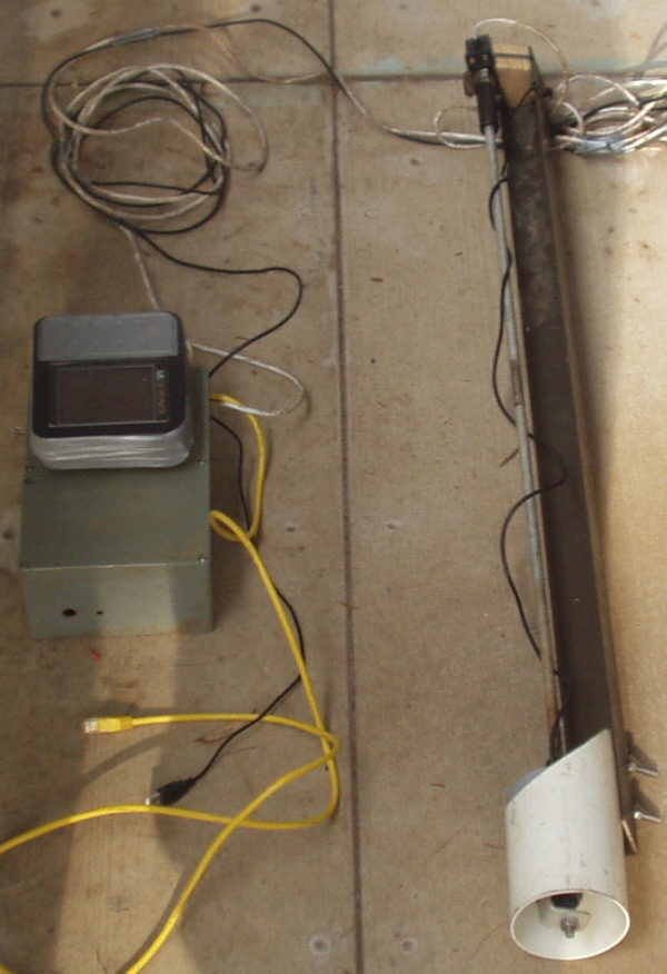

Did some testing yesterday. Rough setup at the moment but I'm pretty happy considering it's only first try outside of the drainpipe "test-tube". Really need a workshop with ocean access. Working on that.
I'm finding that the transducer beamwidth or "cone angle" seems too great. Either that or the display needs better gain control, which I plan to implement later anyway. The Fish-Finder manufacturers state cone angles but I tend to think now that the "beam" isn't actually cone shaped, but more of a flattened cone of elliptical cross-section. (We're getting into geeky waters now!) This makes sense when one thinks what a conventional fish-finder transducer needs to do. A wide swathe athwartships and narrow fore-and-aft. If this is the case then I have placed the transducer the wrong way with regards to the rotation mechanism. Next test will re-attach in housing 90 degrees and see if that reduces the azimuth beamwidth. Looking at the moulded (lens) shape of the transducer makes me hopeful this will improve things.
Some pics and rough video. A bit windy so had to jam the PC sun-shade (cardboard box) with PC in it under a table so wouldn't blow away. No stepper motor yet so used an old servo to rotate the transducer, but found the gears stripped. Connected the servo's pot to another A to D input on the Arduino and just turned the transducer shaft manually. Linear pot so angles accurate enough...The first few seconds of video shows a reflection which is probably the piling at the end of the pontoon 5-6 metres away. Then the owner of the pontoon puts the bucket in the water and it shows up closer in.
- rov sonar manual scanner.jpg (124.29 KiB) Viewed 18483 times
- rov sonar shield.jpg (121.02 KiB) Viewed 18483 times
- rov sonar fish finder mods.jpg (86.59 KiB) Viewed 18483 times
- rov sonar bench.jpg (96.07 KiB) Viewed 18483 times

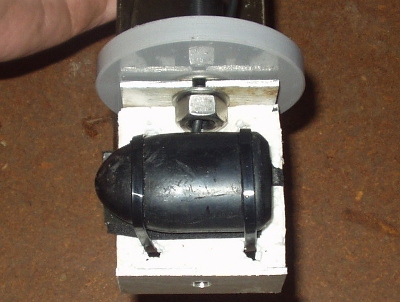

Thanks Zaibach. (edit: and SirHippy just saw your reply) Since last post made a new mounting so I could rotate the transducer. Also, the transducer now has a piece of expanded polystyrene behind it (what would be the top in normal fish-finder use) in an attempt to reduce any sensitivity from that direction.
With transducer rotated, I tested again at same location on the pontoon. The bucket showed up narrower than in the video, however there was a stronger reflection from the bottom. This makes sense with the transducer now rotated. The beam now looks to be wider vertically and narrower horizontally, as hoped.
On first re-testing, the transducer was about the same distance from the bottom as it was to the bucket. This cause me not inconsiderable alarm
and some confusion
at first, because on lifting the bucket out there was still a good echo the same distance out as the bucket. Moving the transducer assembly further into the water and so closer to the bottom separated the two echoes. Relief!
Noticed more "random" echoes than in the videoed test. I'm putting those down to small waves on the water's surface or reflections from the bottom. The transducer assembly I was holding in the water, not clamped with respect to the bottom, so movement would have been affecting things.
Probably any further testing will be with a stepper motor, not fingers, doing the scanning, deeper water, PC set up out of sun ideally inside a boat's cabin, fish-finder gain controls more easily accessible etc etc. Would like to try a transducer with a flat face, or file the current one flat to see if that narrows the vertical beamwidth so reducing reflections from the bottom or waves.
Pic transducer rotated:
- transducer rotated (400x302).jpg (100.04 KiB) Viewed 18392 times
