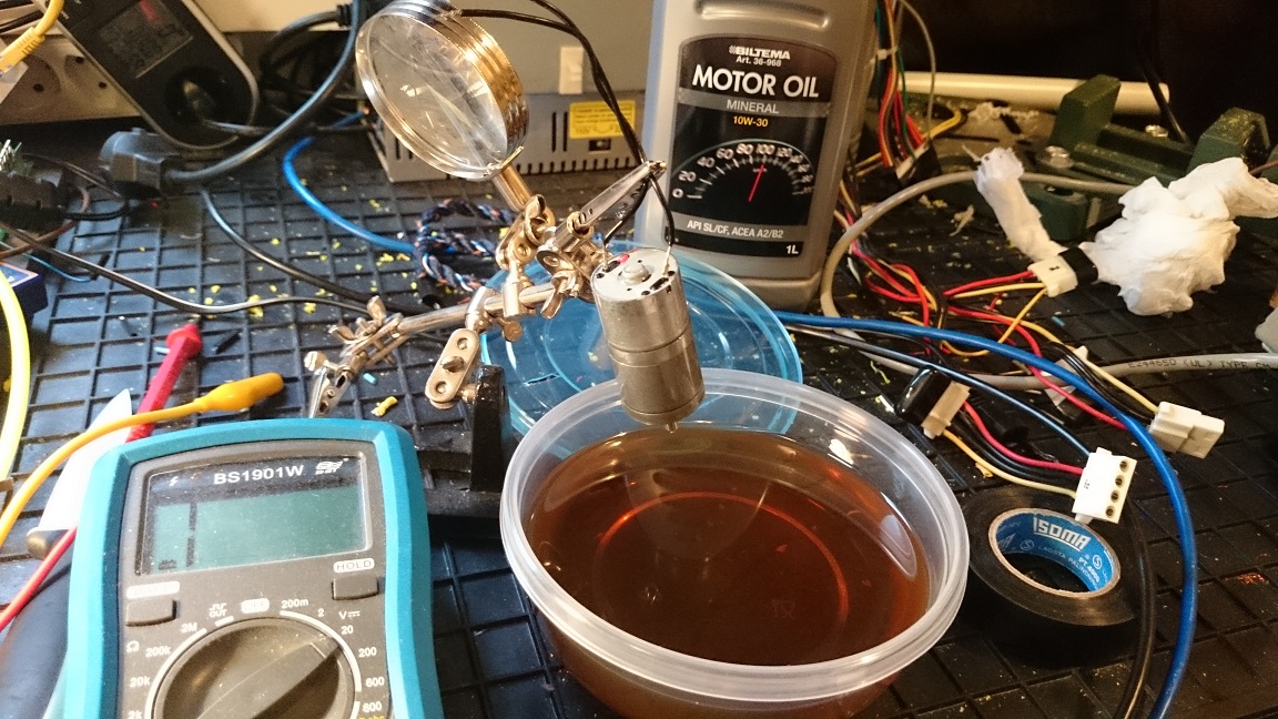

Way to wake up an old thread, but today I actually tested a cheap brushed 12v dc motor running in mineral 10W-30 motor oil.
Note that I will be using brushless motors on my rov, this was just for fun
The result?
~40mins and it was completely dead.
I have a few more of these motors if someone wants me to test with different oils?
The result?

Interesting post Olegodo. Have you pulled the motor apart yet to check out the brushes and commutator? I'm wondering whether the oil softened the brush material and caused it to clog up and short out the insulating space between the commutator segments, or if the oil soaked into the brushes and caused them to go high-resistance?
Regarding the other oils to try, i don't have any suggestions, but was interested in Dressur4's mention of glycol used in pressure-compensated pump motors (induction, not brushed). Those pump motors I think used sleeve bearings, or bushes. Not sure what material. Maybe the hard plastic stuff used in boat skeg bushes?? The motors you are testing i guess would be bronze bushed. I did some internet searching on glycol/antifreeze/corrosion inhibitor (concentrated it has an oily feel) wondering whether it could be used as a lubricant for brushless motors. No good for ball-bearings apparently, but bronze bushes?..... Maybe glycol wouldn't affect the brush material, but if conductive at all would cause corrosion problems for the dissimilar metals in the bush and shaft?

I did not pull it apart. these motors are small and let's face it, full of oil
After it died, I did measure the leads to the motor and there was no contact, so I guess the brushes burned up or something.
I should also note that these are very cheaply made motors. Also, I don't really thing they last too long running in air at 12v either.
Your glycol/antifreeze idea sounds interesting. I might try that.
If anybody else has some input, please let me know.
