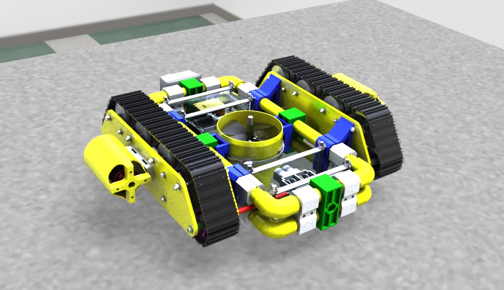

Hi All,
I am currently in my 4th year of Product Design Engineering at Edinburgh Napier University in Scotland, for my honours project (dissertation) I was given a project by my summer placement. The project is "The design of a Hull Crawling Vehicle and Production of a Representative working Prototype", the company i worked for during my summer placement was Fugro Subsea Services. Effectively what i want to prototype is a small free flying vehicle capable of moving across the hull of a FPSO (floating production storage and offloading vessel), this vehicle would be scaled up if it works and would be equipped with inspection and cleaning equipment.
I have looked into different methods of keeping the vehicle in constant contact with the hull of the ship, everything from magnets to a reverse hovercraft style using suction however i have decided that one powerful vertical thruster is the best option.
Some of the specifications i plan of having for my vehicle.
Control: Cat 5 tether connected to a Arduino Uno microcontroller, ideally with a game pad style control.
Power: 12v battery topside
Thrusters: DC Brushless motors, total of 5 motors.
Frame: PVC pipe main frame, with polyprop sections on the side of the tracks.
Control Box: Otterbox.
For my prototype I am planning on keeping the ROV fairly compact, max 500mmX500mmX500mm
I have a few questions for the you guys:
1. Firstly I have absolutly no electronic experience just a lot of CAD experience, therefore is setting an "xbox" style controller to control the ROV pretty hard to do?
2. If the ROV is max 20kgs is the following motor suitable for the thrusters that do forwards/reverse/left/right
http://www.giantshark.co.uk/product/172 ... less-motor
3. What size of motor would you think would be suitable to provide enough positive thrust to keep it against the bottom of the hull of the ship?
Any help would be grand, I feel I may have jumped into the deep end with this one. In the uploaded CAD images i'm aware the rear thursters are way to big was more for representation just now.
Best Regards
Tom.

- Hull Crawler Concept 2.jpg (730.86 KiB) Viewed 19042 times
- Hull Crawler Concept 1.jpg (742.8 KiB) Viewed 19042 times

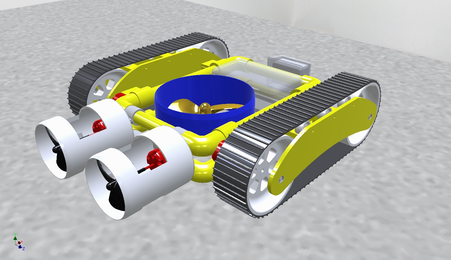

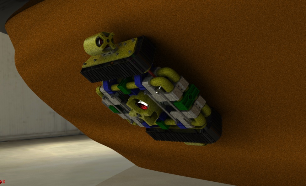

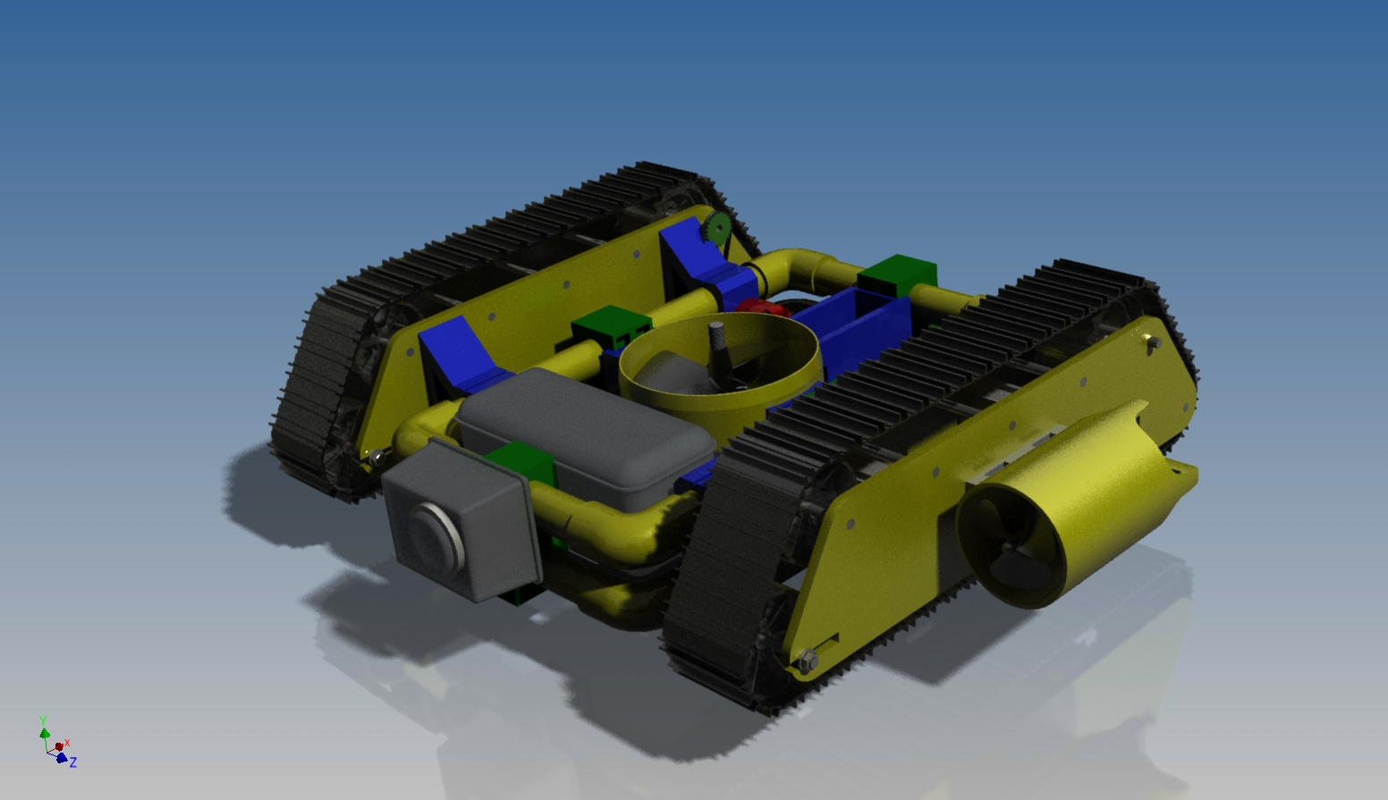

Sorry for taking so long to reply to everyone, with the Christmas period and other Uni commitments this was put a bit on the back burner although it is in full force now!
m_g I have already drooled all over my laptop looking at the stuff that seabotix have, their ROV's are absolutely amazing, if mine is a hundredth of one of theirs I will be very happy!
Mike I will get in contact with you shortly about the program, I am still at the stage of making rookie errors and buying the wrong ESC's (they didn't have a reverse function). Seems living in Britain we don't quite have the same resources for buying R/C boat and submarine components.
The Digit ROV Suite looks ideal, my project aims to create a hull crawling vehicle therefore creating my own programs is not as important. I have had almost all my components 3D printed now, motors are bought just need to get my head around the wiring of it. I have no idea if a 12v battery will be enough to be honest, just fingers crossed it will, all the motors are fairly small because they are brushless outrunner motors for model aircraft.
I have already worked on a hull crawler that uses magnets and wasn't overly impressed hence the use of vertical thrusters.
Ill please see below my update CAD drawings.
Cheers for all the input again guys, still very very new to all this!
Tom

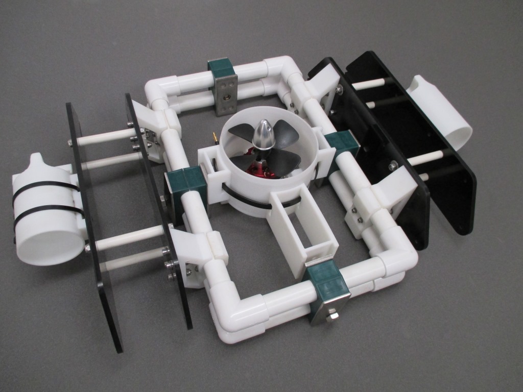

Bit of an update,
Finished my writing part of the my dissertation just finishing up my HCV (Hull Crawling Vehicle).
I have finally got to grasps with my electronics as well, I have ditched the Xbox idea as it is far to complicated for me, having had zero electronics experience before this it was a bit ambitious doing a ROV anyway let alone with all the parts I wanted to put on it. Unfortunately due to my inexperience the HCV is no longer free flying, it is only going to be capable of crawling mode, I was a bit of a dissapointment but I have struggled enough getting one brushless motor to spin let alone 3 of them and program it. I have a tamiya dual motor gearbox for powering the tracks, a brushless outrunner motor for keeping it in contact with the boat, which has a Turnigy 60A Marine ESC controlled via Arduino. The Uni only have power supply's going to 10A and my motor can draw 40A, although at 10A it is almost lifting off the table its so powerful.
It is now controlled via a single joystick topside, with an umbilical that consists of 2 seperate power cables, the USB cable to arduino and 5 small gauge wires that are the joystick control.
I was wondering if anyone had any idea of how to waterproof my connections into the box? I have gone for some cheapo "lock and Lock" food boxes as the ROV will not be going more than a 2 meters in depth. I was thinking of potting all of the wires into a single 20mm hose and then using a "gland" for waterproofing the entrance into the control box. The waterproofing of the drive shafts of the gearbox was yet another difficult part, but have done with rotary shaft oil seals and a hand turned housing.
Within the next 3 weeks I will have a full working model and fingers crossed have tested it.
Any advice, pointers, ideas are always appreciated.
Tom
Tom
