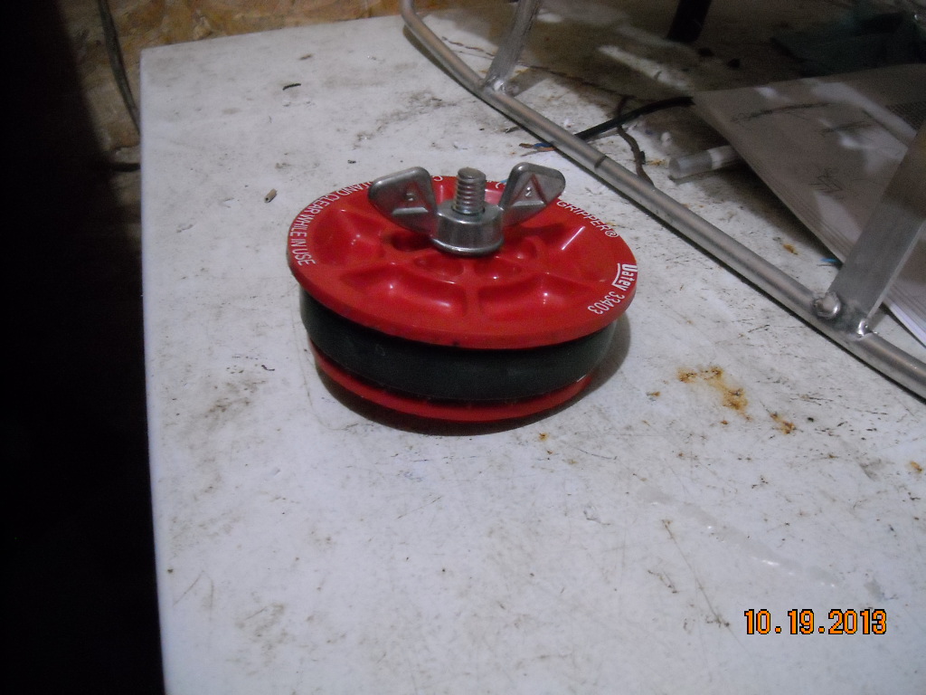

As mentioned above I am using 4" test plug to seal off the back and gain access to the electronics. I was originally going to use the standard screw in plug but it needs messy sealer on it and you have to wrench on it to get it tight enough for a good seal, this is s much easier and faster
Expanding rubber test plug
Also I have an on off switch and charge plugs at the back so I have to do is remove the plug to turn on or off and charge battery

So how well is that screw gasket seal thing working and to about what depth have you gotten it.
Been thinking about using a standard cleanout myself but the point about it being a pain to work with opening/closing etc does raise some concerns about ease of access.

I didn't mean to make you think I was insulting your design, it looks and works much better than mine (which right now is a pile of plastic parts, two circuit boards, a camera and a bunch of grand ideas still in my head).
That Cherne key at the back is brilliant and I'm think I may adopt that at least until I get my design finalized. Those things are designed to handle some pretty good pressure. Good thing about this use is that the pressure is outside pushing in, so it's going to be even stronger than the standard use which is holding water pressure IN.

Not at all I have had to many projects in the past that were picture perfect and then had to re- design or cut them back apart
Thanks the first time I pressure tested with the screw in plug trying to get it tight enough and then trying to get it lose again made me start looking for something better. I have not tested the Test plug past 5' yet but will and am not scared of it at all.
Thanks I haven't tested the plug past 5 ft yet but will, originally I was going to use both the Test plug and the screw in plug but really the rubber gasket being force against the PVC makes way more sense than a plastic thread, to me anyway

Bung is a brilliant idea if I may say so, but I too wonder just what it seals up against. Shiny plastic? A shoulder down the pipe to stop it getting pushed in too far by depth pressure?
