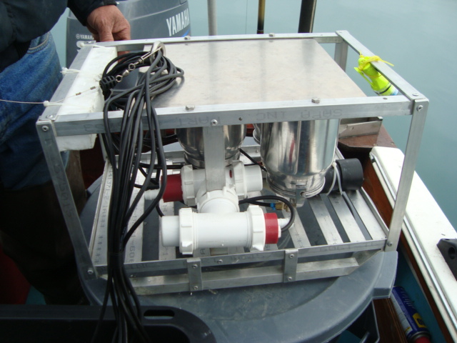

I have rule inline pumps on my ROV. I recently did a test down to 75ft and had no problem.
Here is a picture of the motors mounted on the ROV
