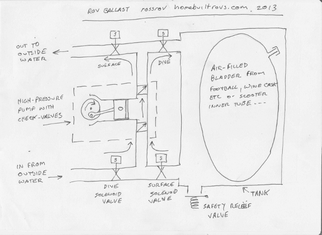

rov ballast tank.jpg (151.84 KiB) Viewed 12325 times
Probably easier to use just one pump. Here's a drawing of the concept.
The pump idea in the video Steve posted would be simpler I think for small volumes of water. How much volume do you really need to move?
