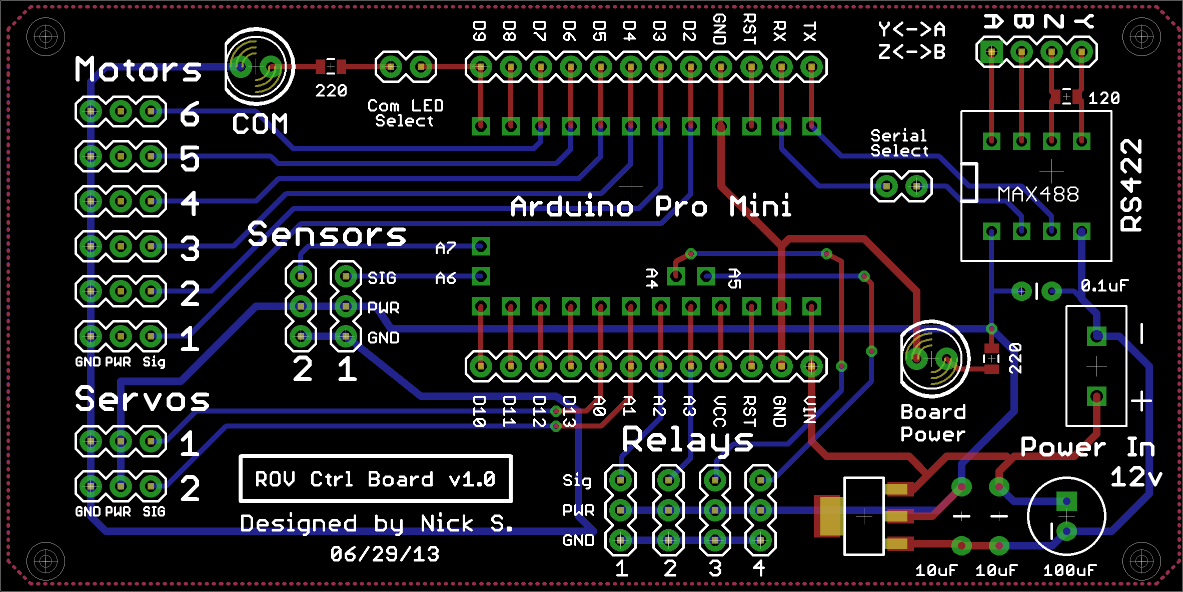

I just finished testing my brushless thrusters, and have added and LCD screen to my surface control, and a Arduino controlled Heads up Display video overlay to my video feed. I also made a custom Printed Circuit Board to make connections in the ROV easier.

- Custom ROV Control Board: Supports up to 6 motors, 2 servos, 2 analog sensors, and 4 relays or 4 analog sensors depending on software configuration.
- ROV Ctrl Board.png (99.85 KiB) Viewed 3522 times
