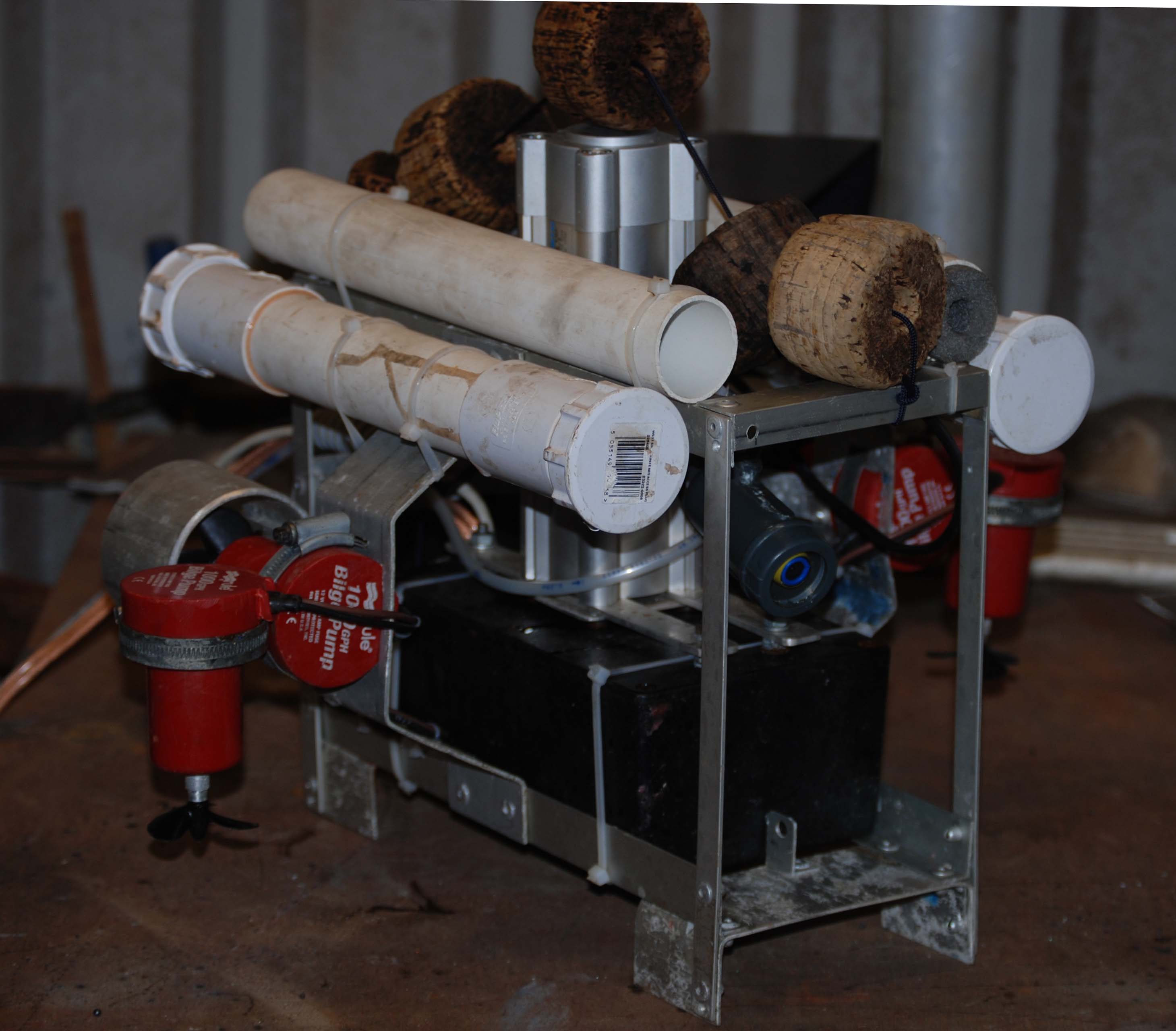

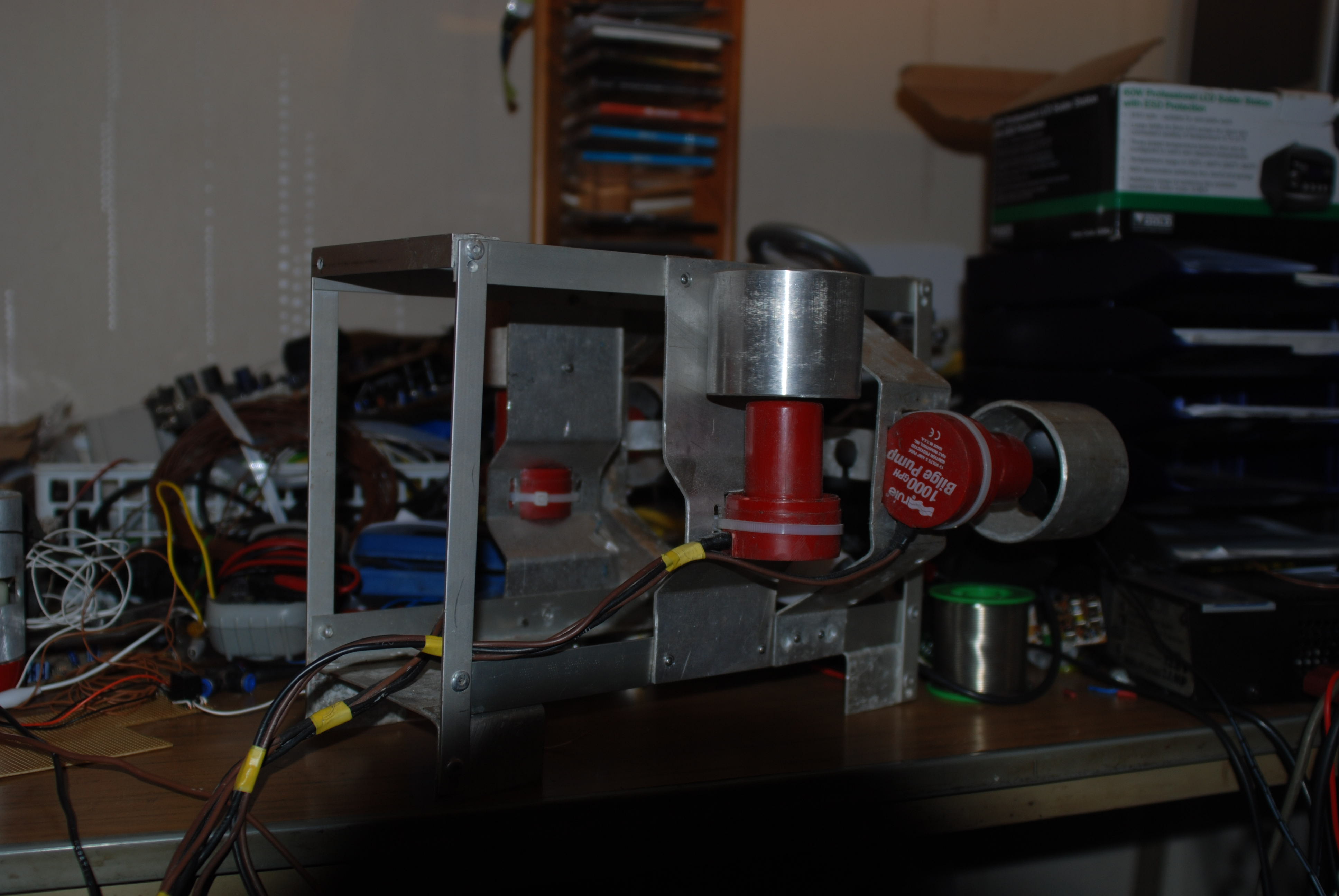

just thought I would see if I can put some pic's up off my rov, tried out me buoyancy system today and it worked well sort off!! had to retro fit more floats so it didn't sink again, but have now striped it for a re fit because the control box is leaking and half the thrusters stoped working, so am going to make a nice new aly one then try again!!
- DSC_0008 copy.jpg (311.41 KiB) Viewed 11070 times

Just though I would do a wee update,
have now ripped everything to bits made new mounts for the vertical thrust and mounted them on the frame and moved the horizontal ones back just enough to get them on the centre line, hope it doesn't upset the turning to much!! taking longer than I hoped to fab the control box and new tank I have decided to fit to try and make the thing float!! be easier said than done when 90% of the rov is aluminium!! it might have to go on a diet to lose as much wait as possible, control system is coming along nicely new bank of relays is done 10 channel kit is done just got to finish the computer end, have also made a leak detector, need to make the other light and finish the camera housing. still a long way off getting back in the water but getting there!! will add more pic's soon.

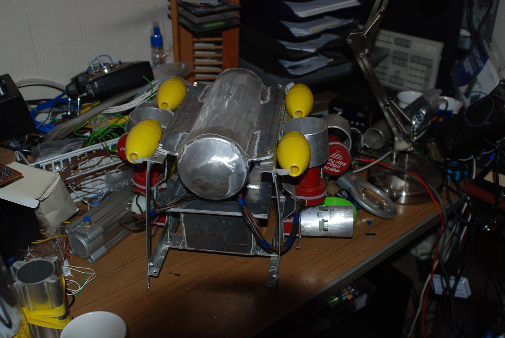

well i think the box is going to be big enough!! as i could prob fit everything in it 3 times over not really any bigger than the old one but a lot more useable space to add more stuff later, well that's the plan anyway.

- DSC_0016 small.jpg (661.15 KiB) Viewed 10964 times

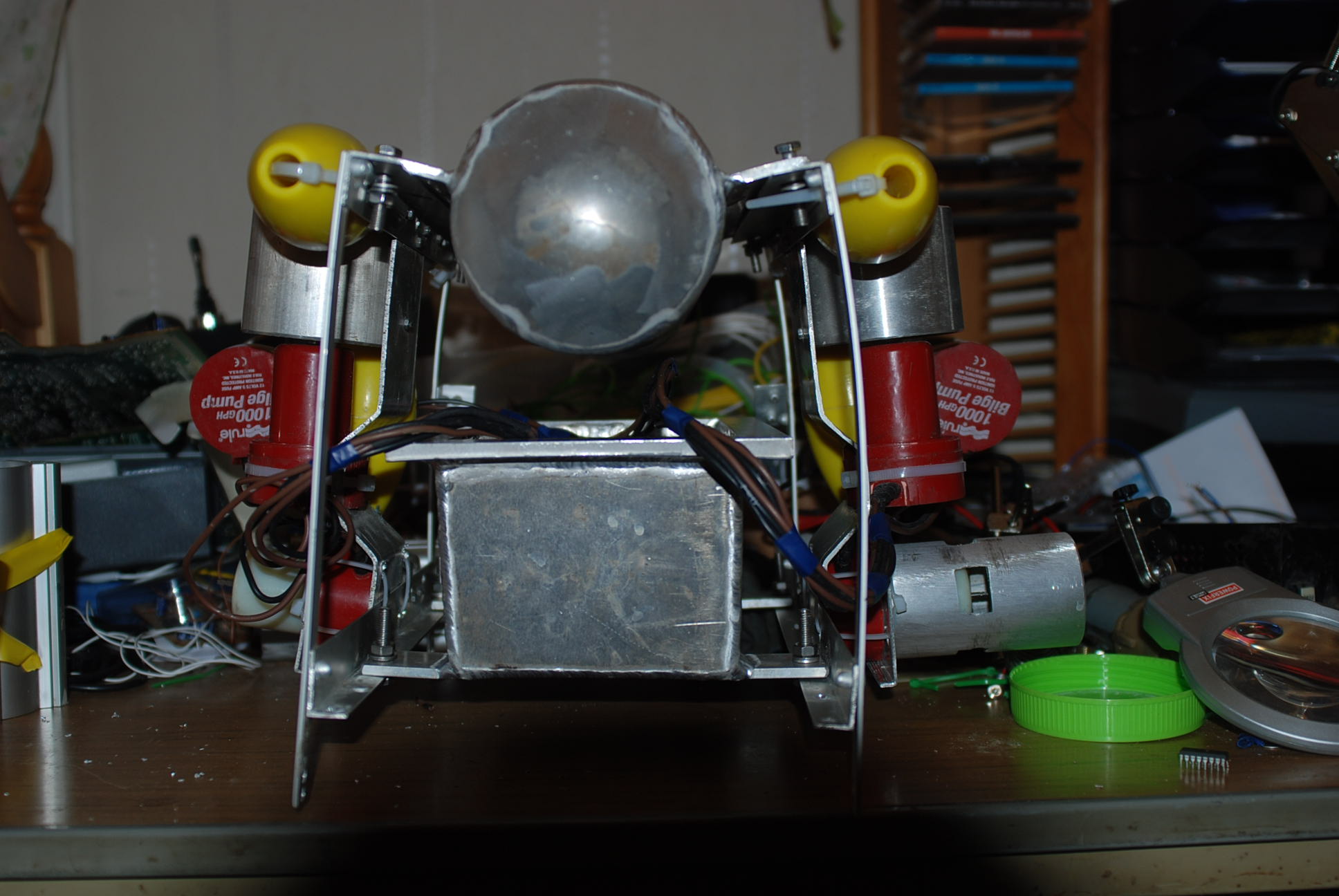

need to clean the bench again haha don't take long to get messed up!!
- DSC_0001.JPG (285.25 KiB) Viewed 10851 times

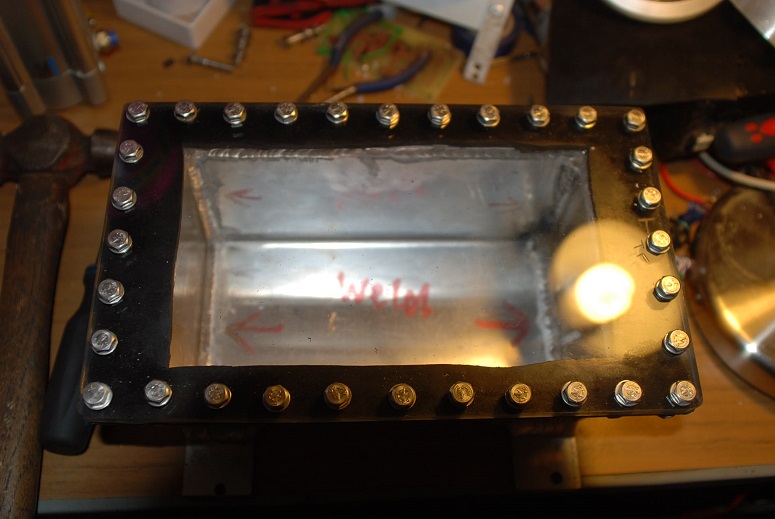

- DSC_0018.JPG (131.51 KiB) Viewed 10791 times

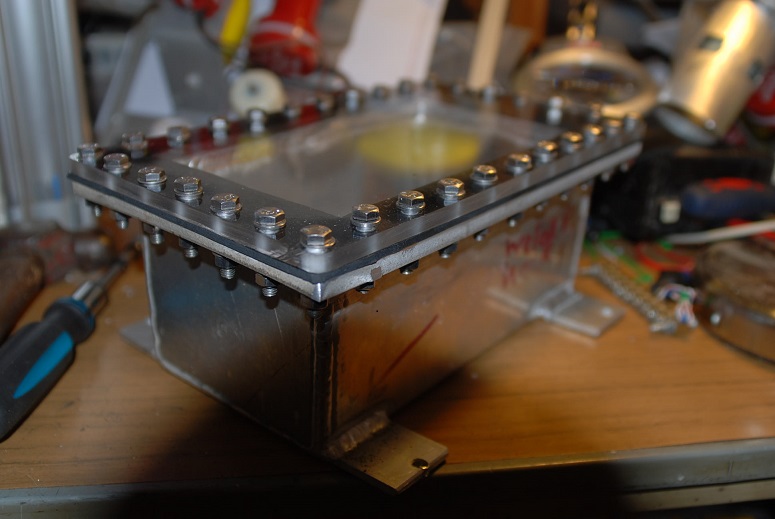

one day I will clean the bench honest!!
- DSC_0019.JPG (122.1 KiB) Viewed 10791 times

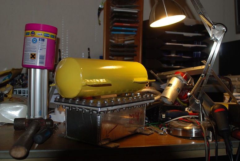

might have gone a bit over board with the bolts on the box as well but its done now.
- DSC_0020.JPG (152.38 KiB) Viewed 10791 times
