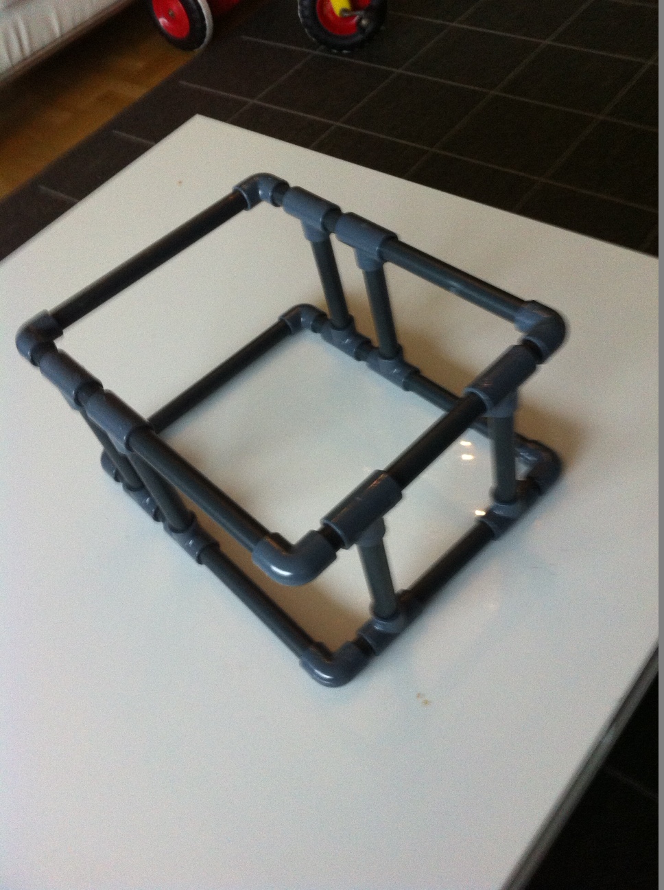

I am using PVC frame system, like many others here, see photo.

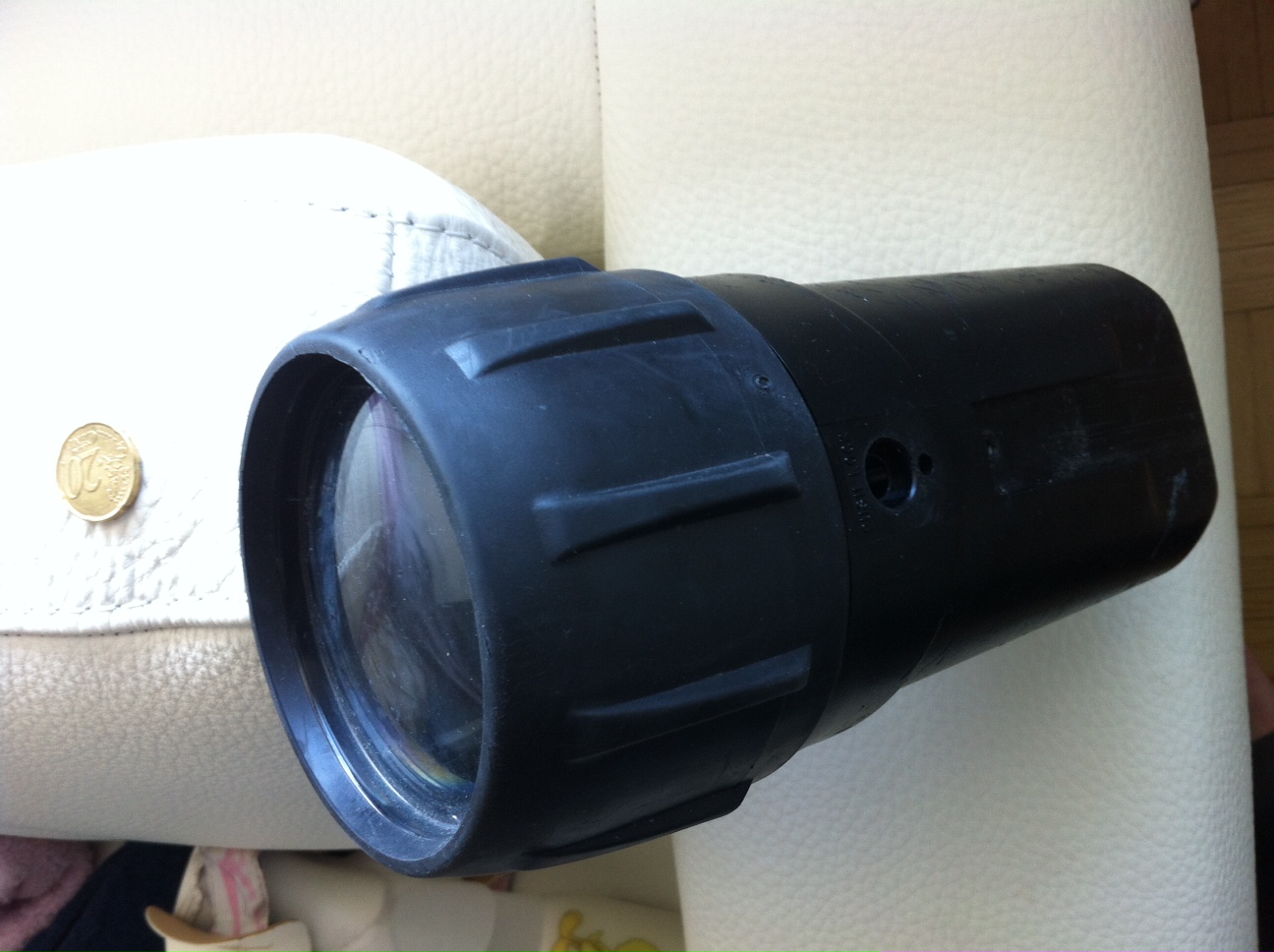

Im planning to put camera inside UK D8 divetorch housing (see photo). Battery for camera will be inside housing and videofeed
will be RCA-Balun-Ethernet-Balun-RCA style cable.

UK D8 divetorch.
UK D8 divetorch.
Frame
Frame
