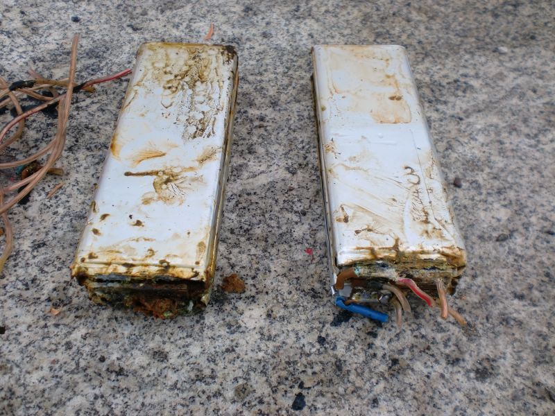

Li-pos only catch fire if they are damaged. I have been running Li-pos in aircraft for a while and have even crashed them with out a problem. They have a longer running time and less bulk and weight of batteries of the same rating. The only thing that I would recommend is that you insulate them to keep them warm. They have diminished capacity in the cold.

The image shows Lipoly Packs broken in 60m depth. No fire just damaged by shorten circuit.
