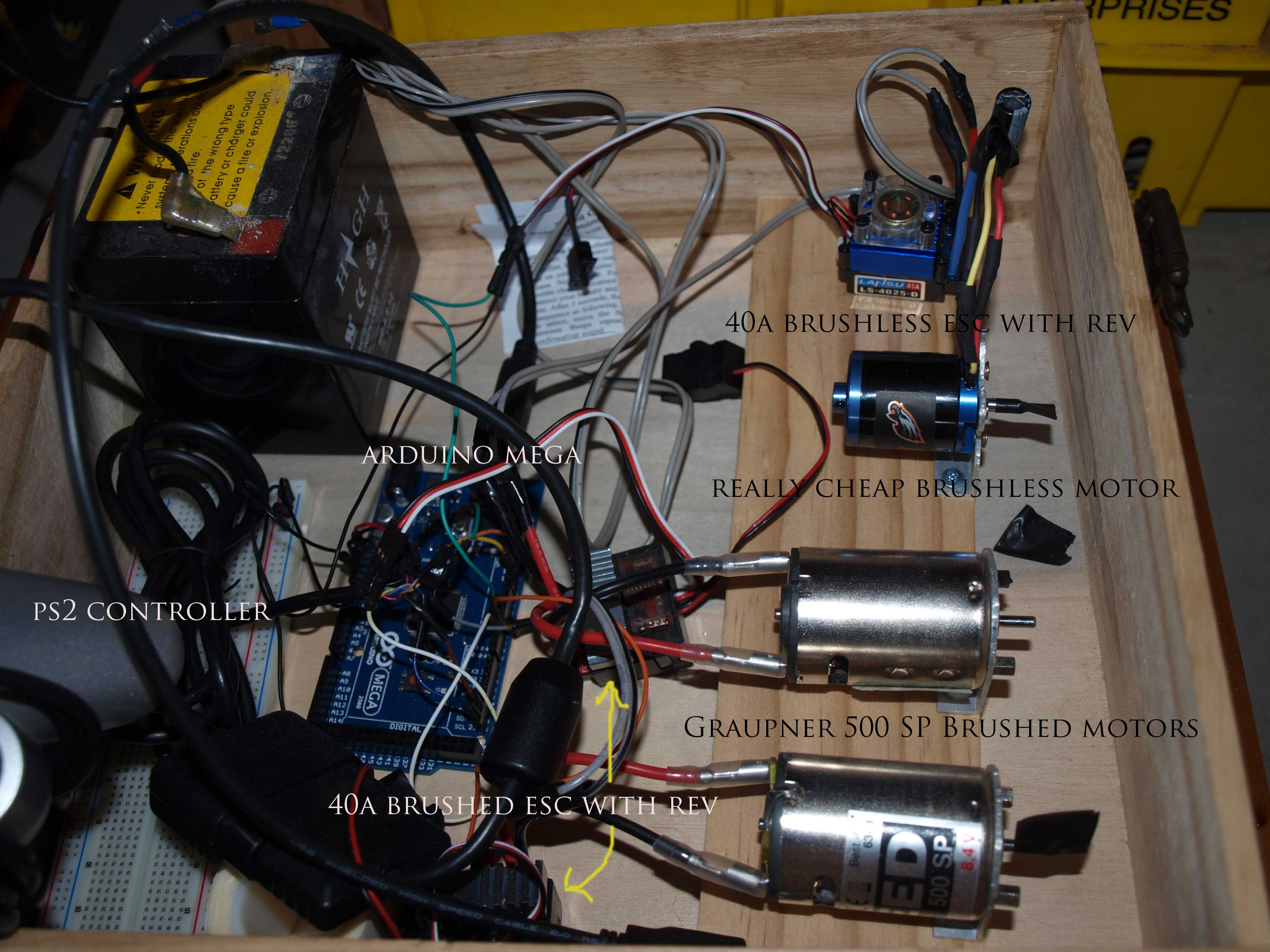

So far, inspired by Ryan (KR2 Diving), I stopped carrying all my bits and pieces in and out of the workshop in a big pile of mess. Oh, its pathetically warm and humid here, and I prefer to do most of the work I can in the air-conditioned house, and not in the kiln like workshop. So, anyway, I re-organised everything into an old drawer and found life much easier. It still looks like a mess but its better than before....
Test Bed 2a.jpg (504.98 KiB) Viewed 13365 times
Hard to see from the photo, but I made some quick motor mounts out of alluminium, so I didn't have to hold the motor's in my hand everytime I needed to test the controller :)
I've got all three motors working forward and reverse, now, using the PS2 controller. The left stick controls forward and reverse, left and right (left controls the right motor, and visa versa, like a tank). The right stick controls the brushless motor which is ascent, descent. Until I get it all mounted, I won't know if I have enough thrust to actually achieve this.
I worked out ESC values by trial and error but it just didn't seem good enough. It worked, but was eratic. SO, I set up a potentiometer and serial.print to give me the actual values, and am updating the code with these 'accurate' values. I have also done the same with the controller, as it seems that the neutral position is far larger than I imagined. So I spent some time writing out the range of values that constituted the 'centre' position of the PS2 Controller. I still need to update these values into my code as well. It felt like I was going backwards but once I had done it, I felt foolish for not doing it properly the first time. I guess I just didn't understand it well enough at the time.
So my arduino code, at the moment, allows the PS2 controller to move the motors forward, reverse, left, right, and up/down. No other controls (lights, sensors) have been coded yet.

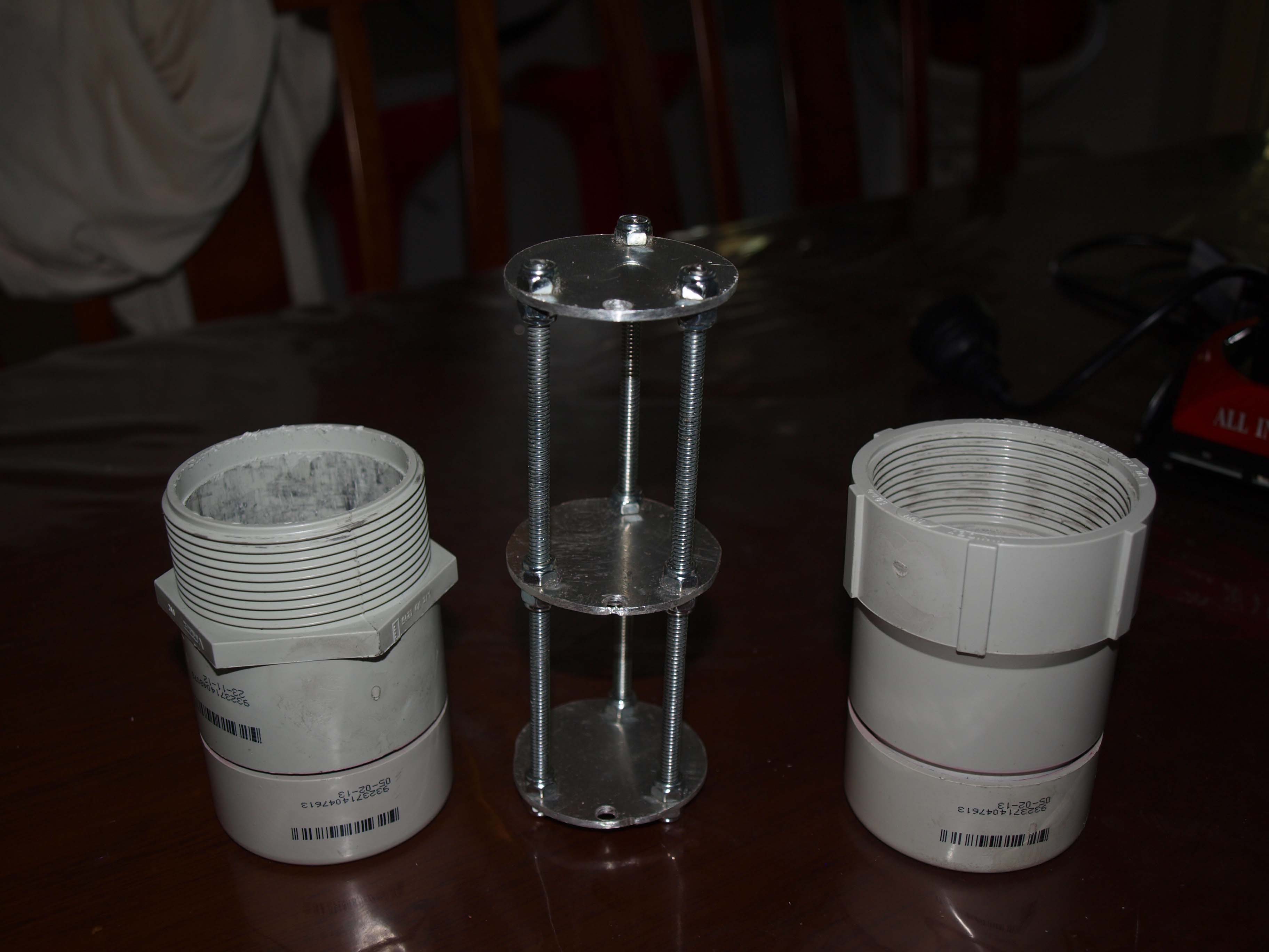

So as we all do, I jump around from one area to the next. I've also started working on the thruster housing. I've put together some PVC fittings and tried to keep the water tight area as small as possible to reduce the water displacement, although if it turns out that I need to add bouyancy, I'll feel a little silly. Did I mention I have started with no knowledge at all :P
Thrusters 3a.jpg (225.56 KiB) Viewed 13365 times
So the idea was to have the PVC watertight compartment with an alluminium chassis, that slides out, that I could mount the motor to.

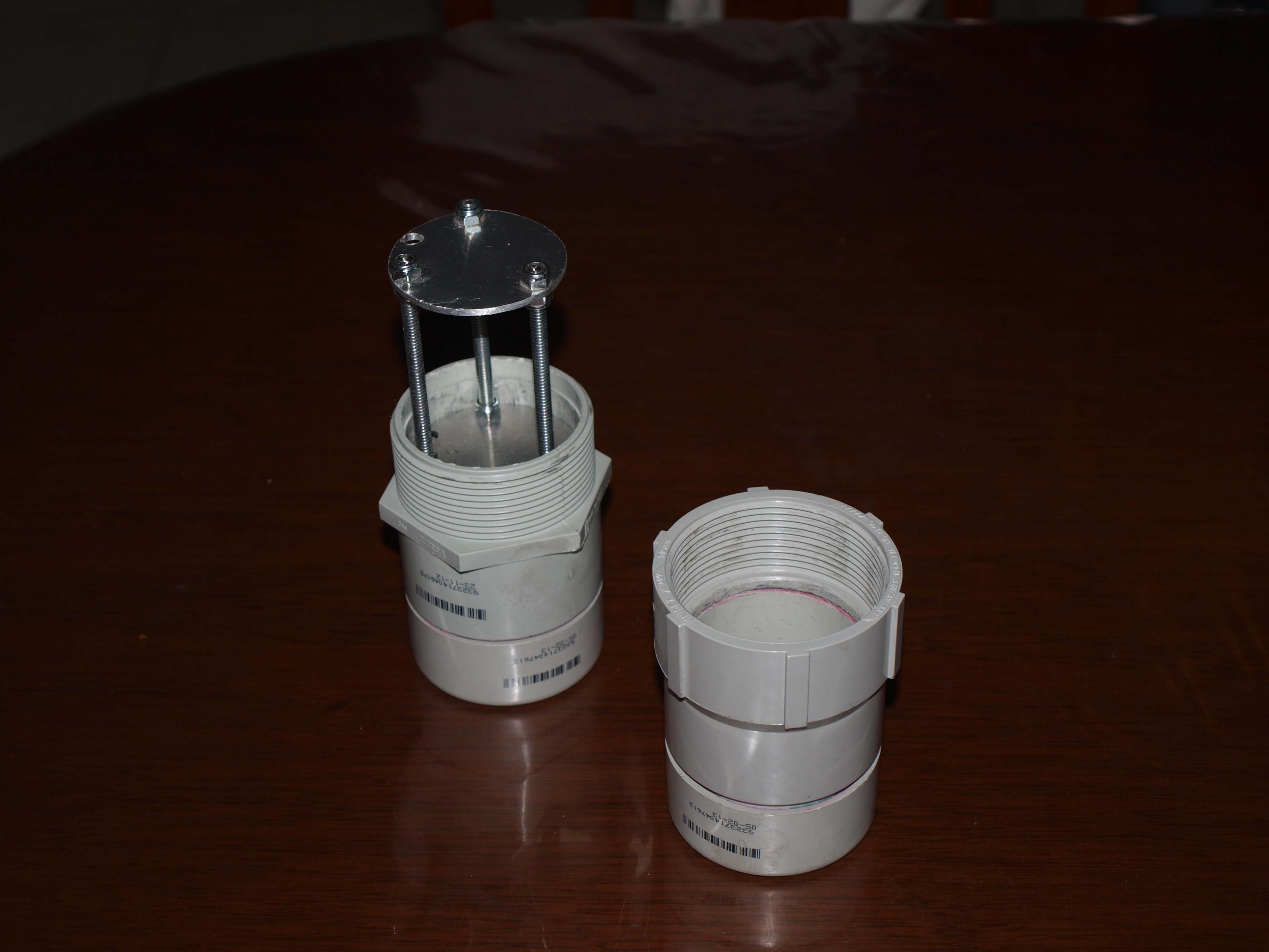

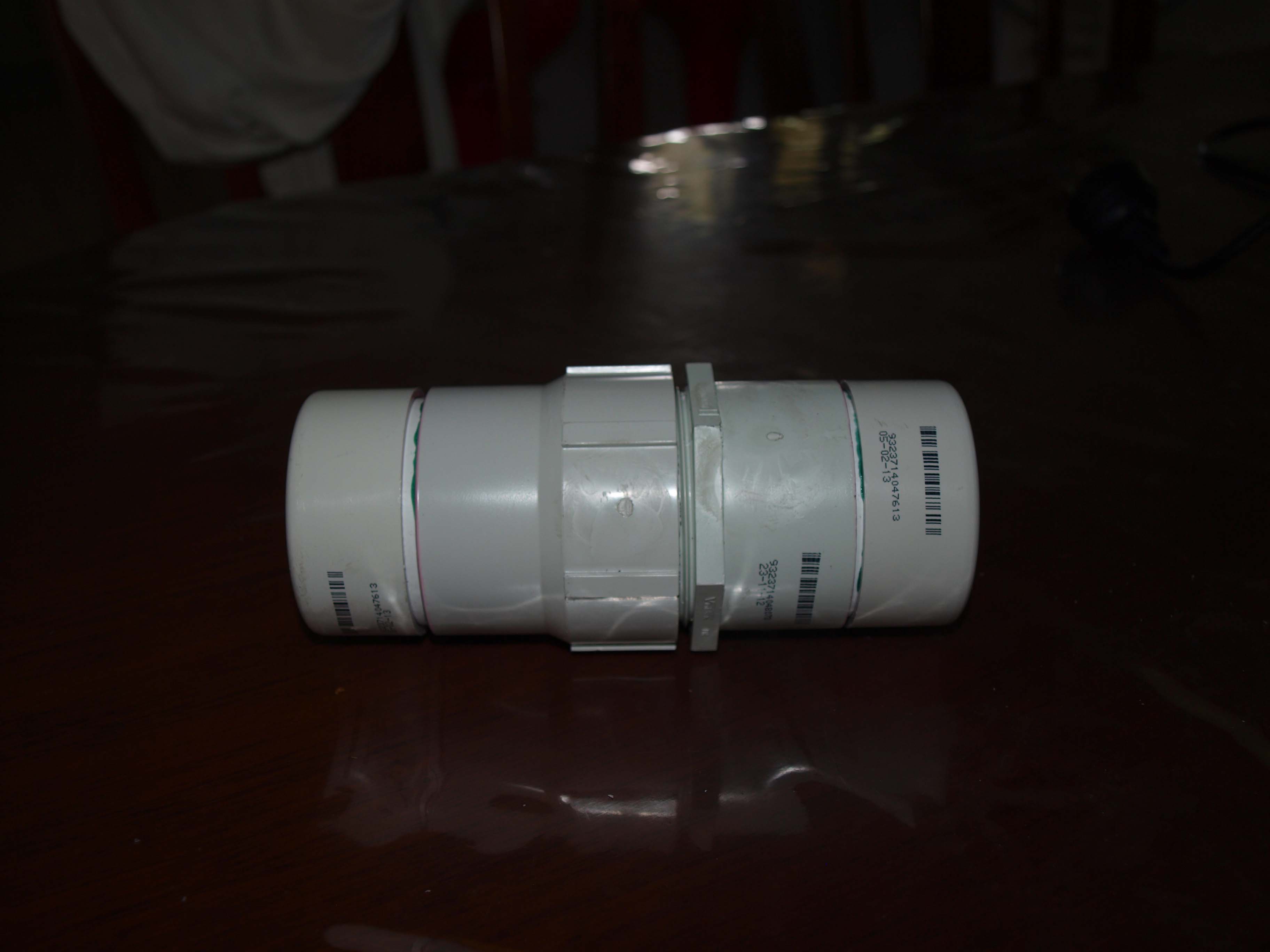

I haven't made any decisions on the power connection, between the chassis, and the inside of the pvc (obviously I'll pot the wires from the outside and have them run to the main watertight compartment with the arduiono inside) but have sorted out some of the shaft assembly and props. I'm waiting on parts too, but will put this in another post.
Thrusters 5a.jpg (155.82 KiB) Viewed 13365 times
Not tightened completely but you get the idea. I haven't started on an o-ring yet, or done any testing on the effectiveness of the unit but will post it when i do.

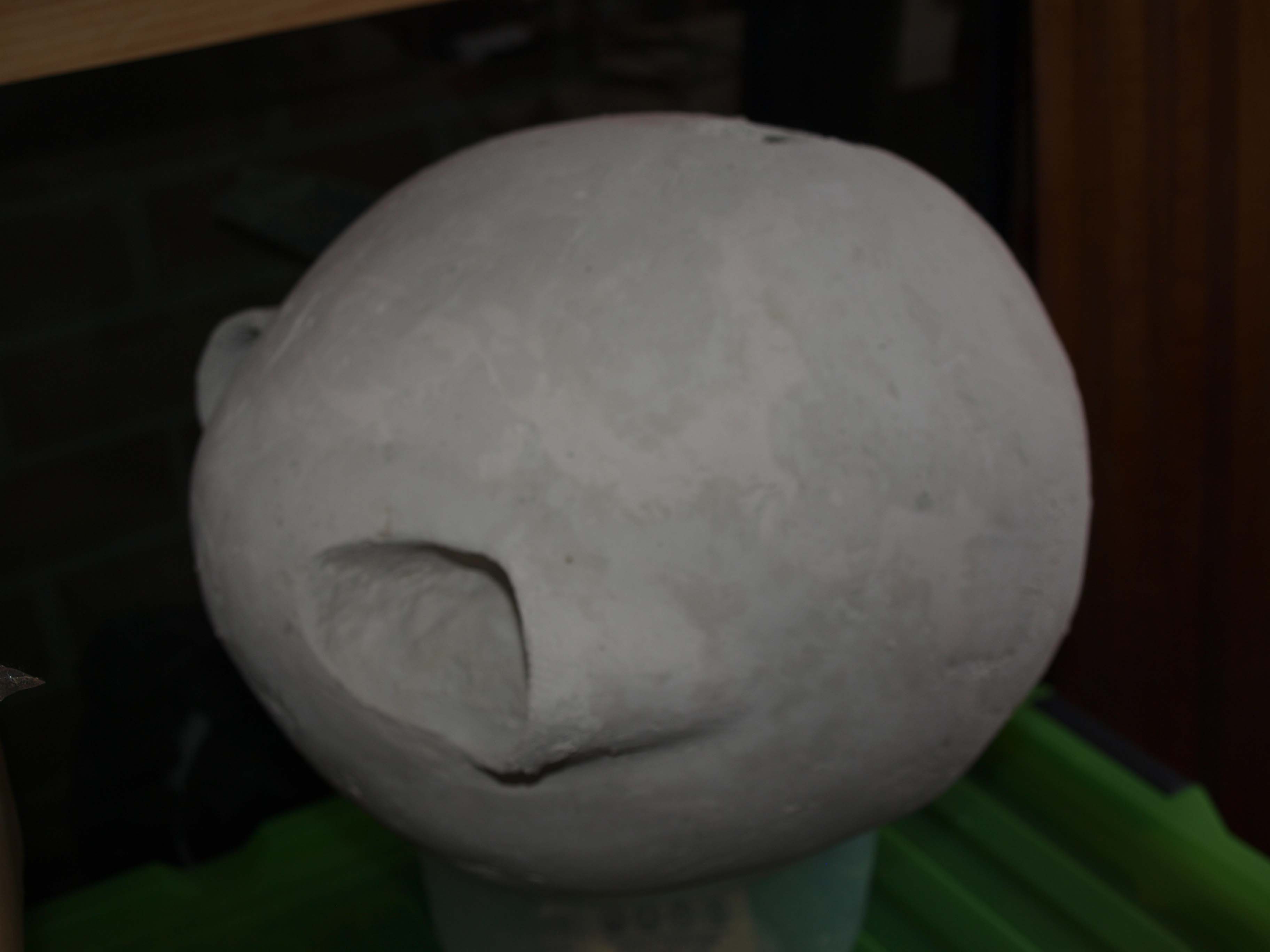

So I really liked the idea of having something that looked the part as well, although the photo might convince you otherwise. I kind of started backwards, I suppose, with the cover and have worked backwards to design an ROV that'll fit within it. It not exactly how it was meant to be, and if I need to make massive changes, then so be it.
Shell 1a.jpg (133.5 KiB) Viewed 13365 times
I've basically started with paper mache' and then started coating in plaster. I've left it for a couple of months as I realised that i'd probably need to make some changes to the body as the ROV developed. Once I've got the chassis (frame) completed, I'll revisit the body and make any final changes. I intend on fibreglassing it and having it join along the centre, horizontally. It will only be a cover and thus, will be a wet area.
I know it looks a bit rough, but if you squint, and really use your imagination, you might get a very brief glimpse of what I'm striving for :)

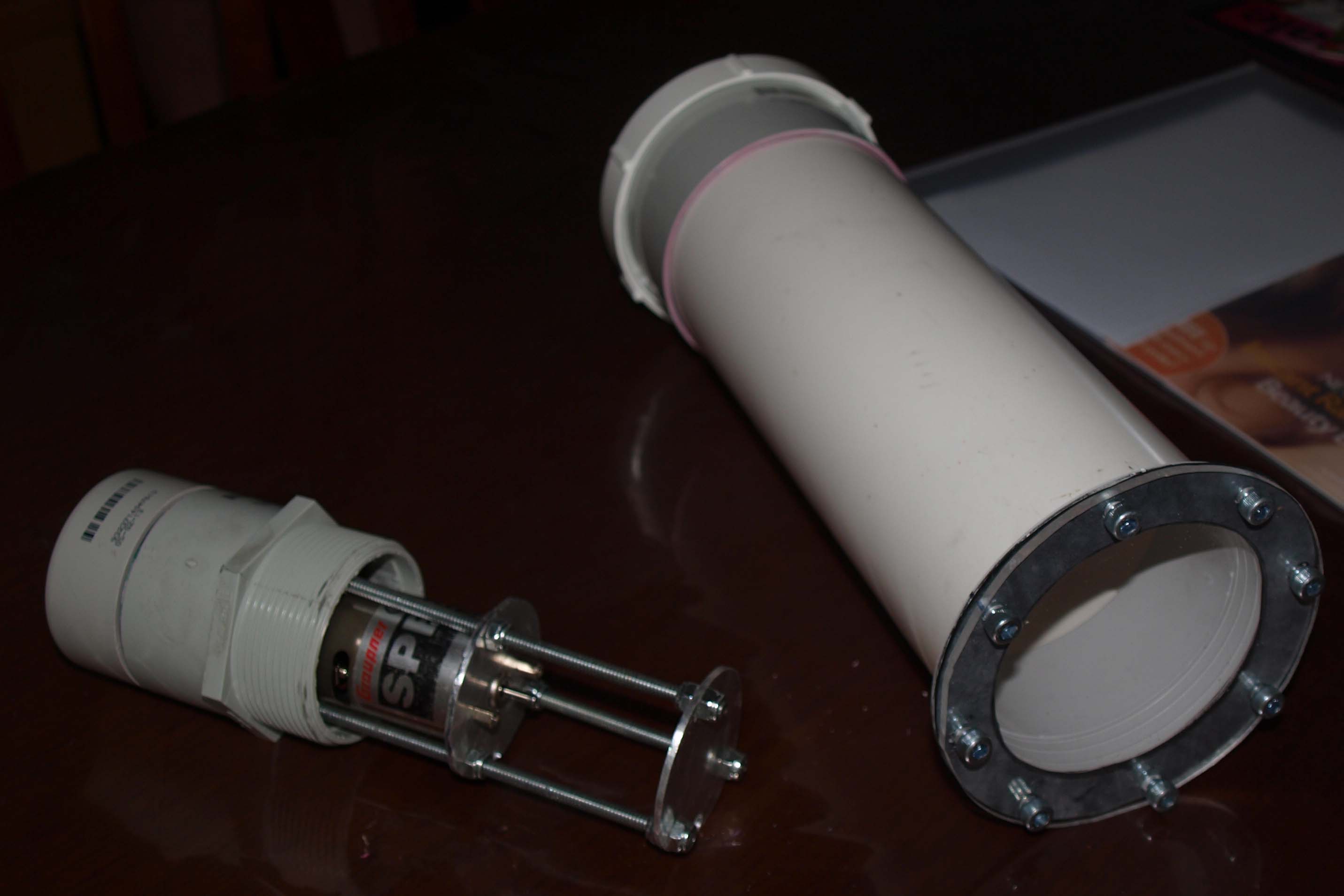

Main Body 1a.jpg (136.15 KiB) Viewed 13307 times
So I've got the basics of my housing exterior started. One end is threaded with a cap (no o-ring yet). The other end started with a PVC flange. I've cut out some clear acrylic (3mm) and made a gasket out of an old car tyre tube. I haven't completed assembly but once it's done, I'm hoping to put together a water sensor inside the housing, and conduct some testing.
On the thruster assembly, I've now started the motor mount and will need a couple of holes for cooling.
