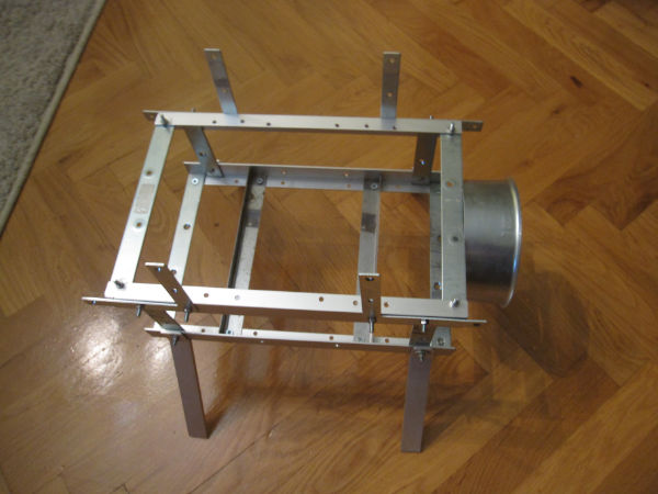

Here are some pics:
Basic aluminum frame

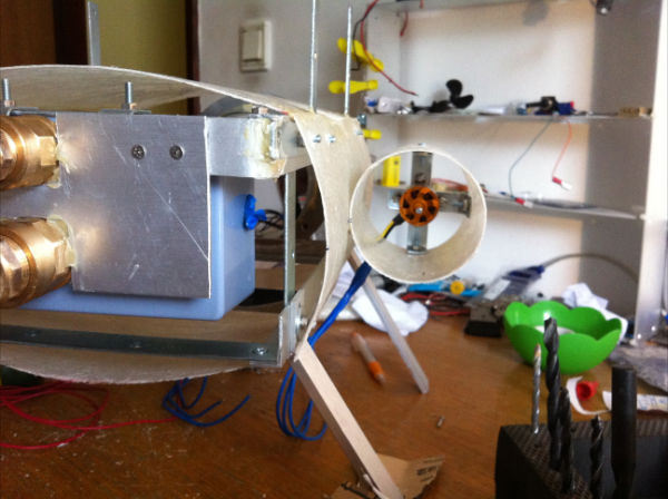

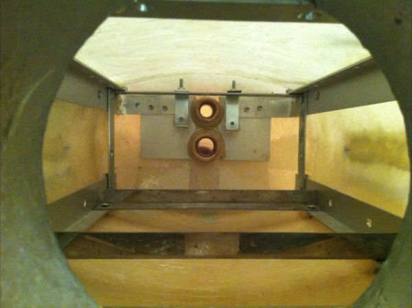

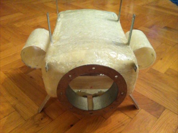

Phase 2

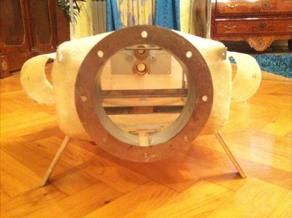

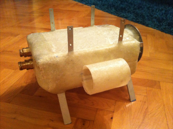

Back side of the ROV with epoxy segment
Inside of the ROV, all the electronics and the batteries go inside
sideshoot
sideshoot

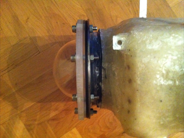

Iron flange for plexyglass dome
finished epoxy housing, layer 1

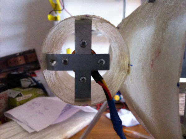

Mounted motor
Mounted motor

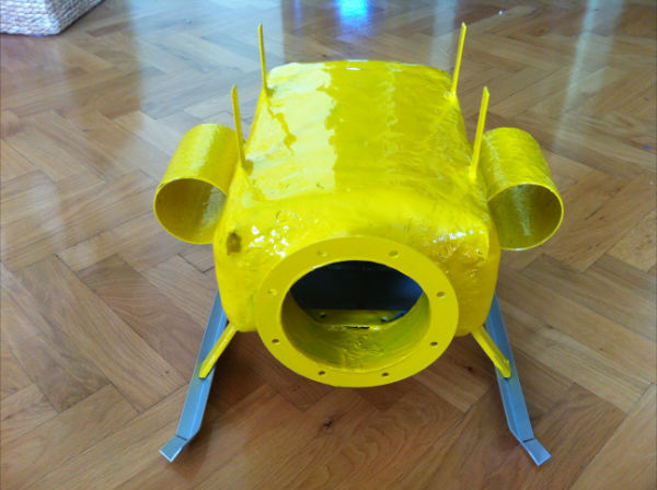

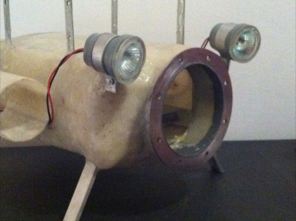

Phase 3

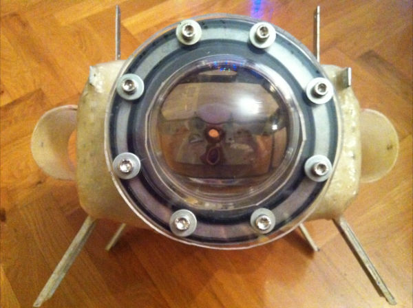

The dome
The dome
mounted dome
mounted dome
mounted LED lights
mounted LED lights
Mounted dome
Mounted dome
Paint job, first layer
