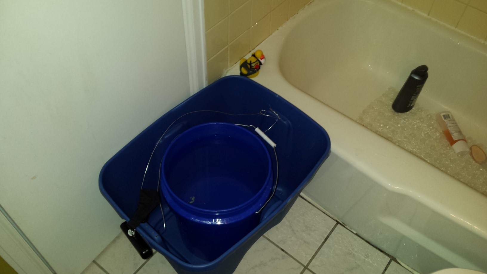

I proceeded to place a 5 gal bucket inside an empty storage tub.
The Double Bucket Set Up
dbl bucket.jpg (174.03 KiB) Viewed 23203 times
I then filled a 5gal bucket to the brim with water.
Filled to the Brim
Filled to the Brim
full 5gal.jpg (173.88 KiB) Viewed 23203 times

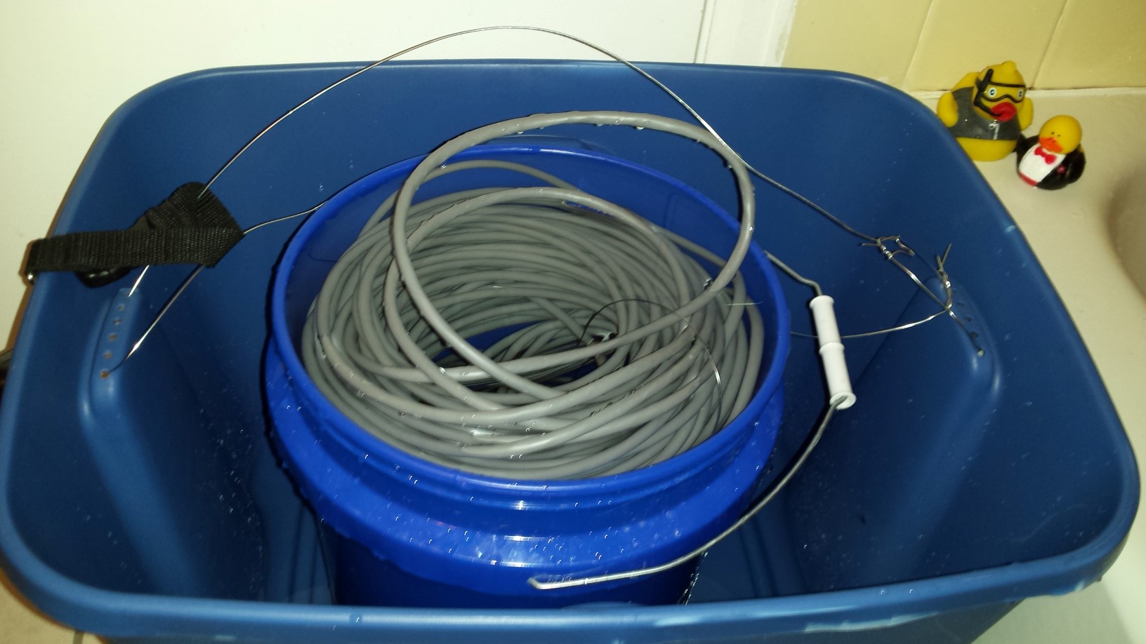

Once full, I carefully submerged my tether in the 5gal bucket, allowing all the displaced water to pour over into the storage tub.
Wire placed into bucket. (best as possible)
wire in.jpg (244.33 KiB) Viewed 23203 times
Once my cable was fully submerged, I carefully removed the 5 gallon bucket containing the water and my cable from the storage tub.
Overflow is caught by the tub
Next I weighed the storage tub containing the overflow water and subtracted the dry weight of the tub.
Code: Select all
(Tub with Overflow water) - (Weight of tub Dry) = (Weight of water displaced by cable)
         9.90 lbs         -     2.60 lbs        =       7.30 lbs (3.31kg)
Based on these numbers, the volume of water that my tether displaced is 202.8 in^3 (3310 cc).

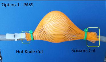

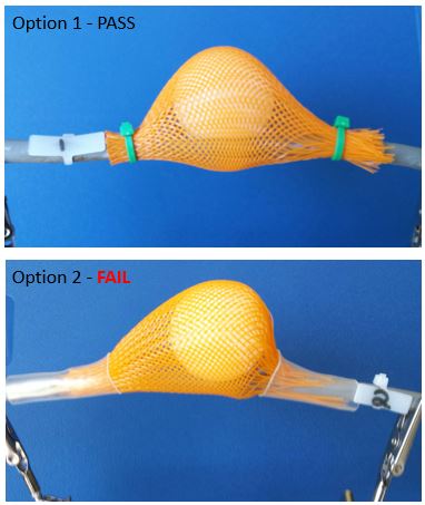

Today I did some more trial and error testing to find out the best way to attach my ping pong balls to the tether... and I think I have a final plan.
Here were the two version I tried.
Two Options
Two Options
ROV ball attach.JPG (34.08 KiB) Viewed 23132 times
Option 1 used small zip ties and the polyester sleeving.
Option 2 used heat shrink and the polyester sleeving.
After trying them both, I decided to go with the zip tie method.
When working with the polyester sleeving, I did make one additional observation that is going to require me to get a new toy. I noticed that the end cut in the factory with a HOT KNIFE had significantly less fraying then the side I cut with my scissors.
Cut Methods
Cut Methods
ROV ball attach ends.JPG (20.14 KiB) Viewed 23132 times
So with this in mind, I am going to hunt down a hot knife that i can use to cut my poly sleeving!

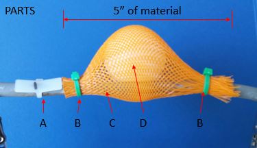

For those of you that are curious, here is a part breakdown of the components I am using:
Parts Breakdown
Parts Breakdown
rov ball attach parts.JPG (19.32 KiB) Viewed 23132 times
A.) McMaster Carr part #7568K11
Nylon ID tag Cable Tie $6.75/Pack (50pcs)
(Great for marking length on tether so I know how much tether is in the water!)
B.) McMaster Carr part #71295K62
Colored Nylon Cable Tie $2.20/Pack (100pcs)
C.) McMaster Carr part #9284K6
Expandable Polyester Sleeving $10.16/10ft roll
D.) Ping Pong Balls from AMAZON.
$10.45 for 144pcs (See Note Below)
Note: These balls are CRAP. This particular listing is full of lies. I have complained about it to Amazon, and in turn, they did provide a refund. For the moment, I am proceeding with these inferior balls, only because I have already begun the assembly process. I might change my mind before i am finished... I will let you know...
My plan B for balls is to buy from my local Dick's Sporting Goods.
These balls work out to be $0.53 / each, but are a FAR superior quality to those I got from Amazon at $0.07/ball. (And I can pick them up on a whim!)
