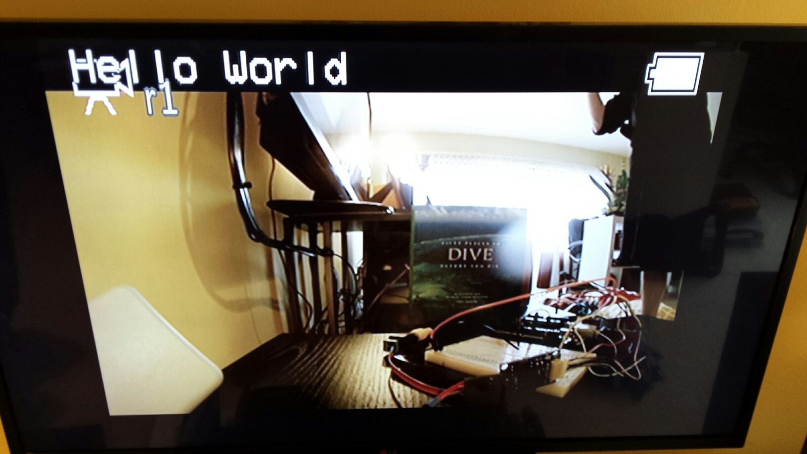

Tonight I tried out (with a HIGH level of success <>< ) my onboard video selector switch. I plan on having 3 cameras onboard my ROV, and this little gadget will do the trick for selecting which one to show on my topside display.
I found this trinket on this site.
The RCCC v2 allows me to select one of 3 video feeds to display, as well as control a flash and the shutter on my GoPro.
The GoPro live feed, power, and shutter control are all controlled via the dock connector on the back. The same site had this cable preassembled and ready to go! I have not tested the shutter, but the power and live feed out work great!
I also tested my video quality when transmitted via my tether. My tether is approximately 75m of 1 core, twisted pair, shielded cable. It "fell of the back of a truck" and my buddy thought I might like it!
Here is the layout that I have. The image is not great...
System Configuration
Here is a quick video.
The three cameras feed into the RCCC. The RCCC then feeds the selected video through the tether to my TV. Baluns are used throughout. I picked up a bag of them from Amazon for peanuts. [url]Here [/url] is the link.
The RCCC determines which feed to transmit based on the signal from the Arduino. The code is so simple!

This little gadget saved a load of time and money and SPACE in the hull of my ROV! A HUGE thanks to the guys at ReadyMadeRC!

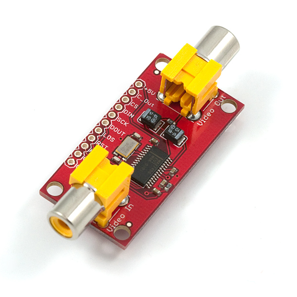

FIRST MAJOR HICCUP:
Well, last night I thought I would hook up my OSD and test it... well.. that turned into a 5hr session of pulling my hair out and overall frustration... I cant for the life of me get the thing to work... I am beginning to think I might have a faulty unit...
Anyone else use the SparkFun OSD breakout board? (I am sure someone on this forum gave me the idea!)
SparkFun OSD Breakout Board
OSD BOB.jpg (107.97 KiB) Viewed 28369 times
https://www.sparkfun.com/products/9168
I have managed to get my video to pass though it... but I cant get ANY characters to display on the screen... I've tried a number of libraries and sample codes... nothing. ANY thoughts? Anyone?
"KR2_Diving"

by kenl
I did get it working Ryan and as you have there was a lot of hair pulling.
I will see if I can dig up what I did, I can't seem to find it right now.
Try this Sketch to see if you have it wired up correctly

Posted: Nov 22nd, 2014, 11:17 am
by KR2_Diving
GREAT NEWS!
Finally got an OSD to work!!!
Hello World!
Hello World!
OSD HelloWorld.jpg (321.02 KiB) Viewed 28135 times
I scrapped the one I got from SparkFun and went with the MAX7456 OSD breakout board from HobbyTronics in the UK.
MAX7456 all wired up.
MAX7456 OSD.jpg (469.93 KiB) Viewed 28135 times
(I use to live in the UK and these guys are great!! Highly recommend for anyone living in the EU! I still order from them occasionally, even though I am now in the States.)
I used the same code I used on the SparkFun OSD, and the HobbyTronics OSD worked right away! No issues... no fumbling... no guessing... just worked!

  //  FDTI Basic RXI                 <---  Arduino  RXI [PD1](TXD)
  //  Max7456 +5V   [DVDD,AVDD,PVDD]  ---  Arduino  VCC      (AVCC,VCC)
  //  Max7456 GND   [DGND,AGND,PGND]  ---  Arduino  GND      (AGND,GND)
  //  Max7456 CS    [~CS]            <---  Arduino  10  [PB2](SS/OC1B)
  //  Max7456 CS    [~CS]            <---  Mega2560 43  [PL6]
  const byte osdChipSelect             =            10;
  //  Max7456 DIN   [SDIN]           <---  Arduino  11  [PB3](MOSI/OC2)
  //  Max7456 DIN   [SDIN]           <---  Mega2560 51  [PB2](MOSI)
  const byte masterOutSlaveIn          =                      MOSI;
  //  Max7456 DOUT  [SDOUT]           ---> Arduino  12  [PB4](MISO)
  //  Max7456 DOUT  [SDOUT]           ---> Mega2560 50  [PB3](MISO)
  const byte masterInSlaveOut          =                      MISO;
  //  Max7456 SCK   [SCLK]           <---  Arduino  13  [PB5](SCK)
  //  Max7456 SCK   [SCLK]           <---  Mega2560 52  [PB1](SCK)
  const byte slaveClock                =                      SCK;
  //  Max7456 RST   [~RESET]          ---  Arduino  RST      (RESET)
  const byte osdReset                  =            0;
  //  Max7456 VSYNC [~VSYNC]          -X-
  //  Max7456 HSYNC [~HSYNC]          -X-
  //  Max7456 LOS   [LOS]             -X-

    OSD.print( "Hello World!" );                // The '!' will not display
                                                //   because it does not come
                                                //   in the factory font.
    while (true);
  // loop()
I have put more info into a thread in the CAMERA section of the Forum.
Now... time to play with it to get it to do what I want it to do...
