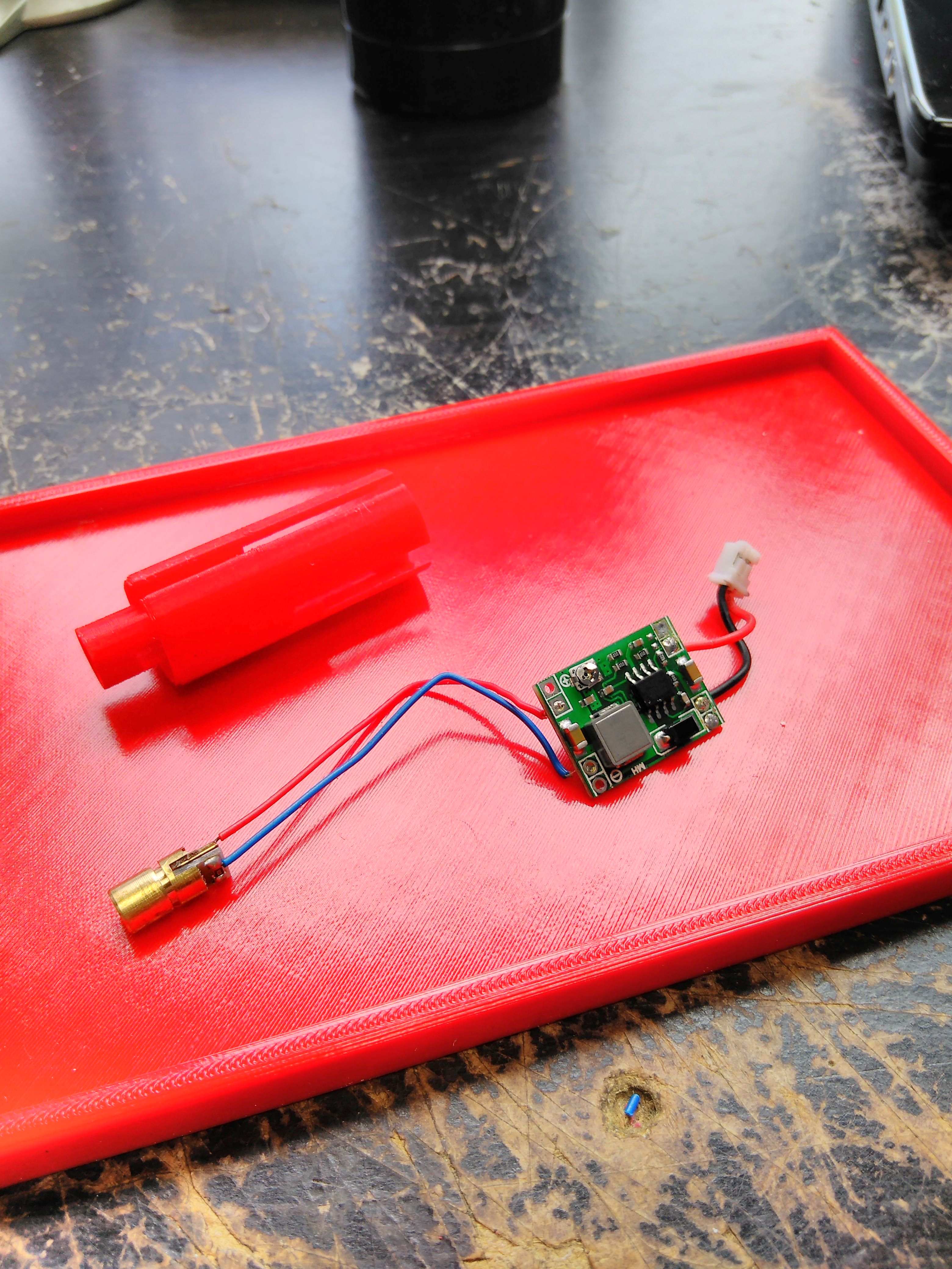

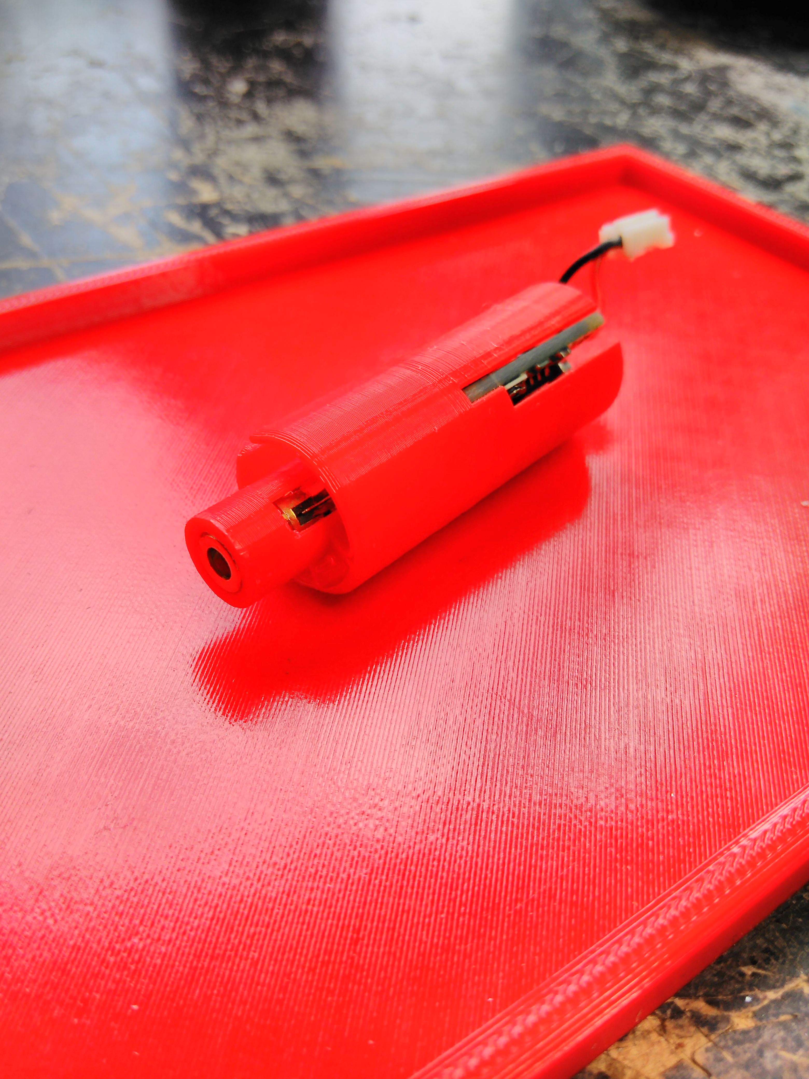

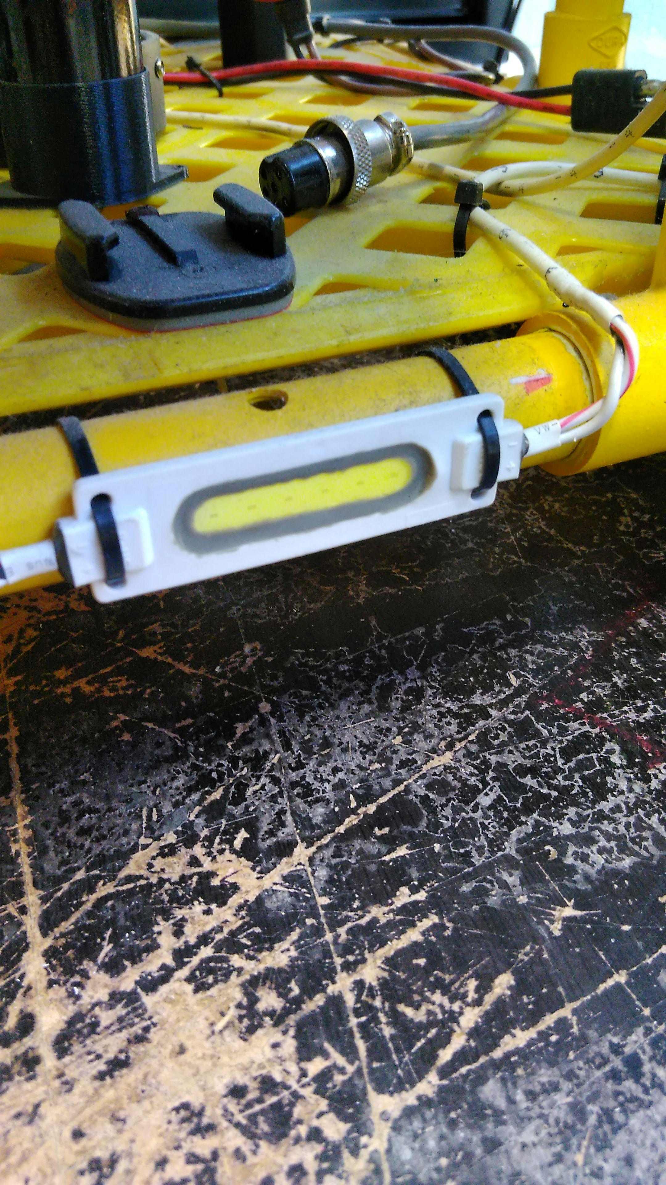

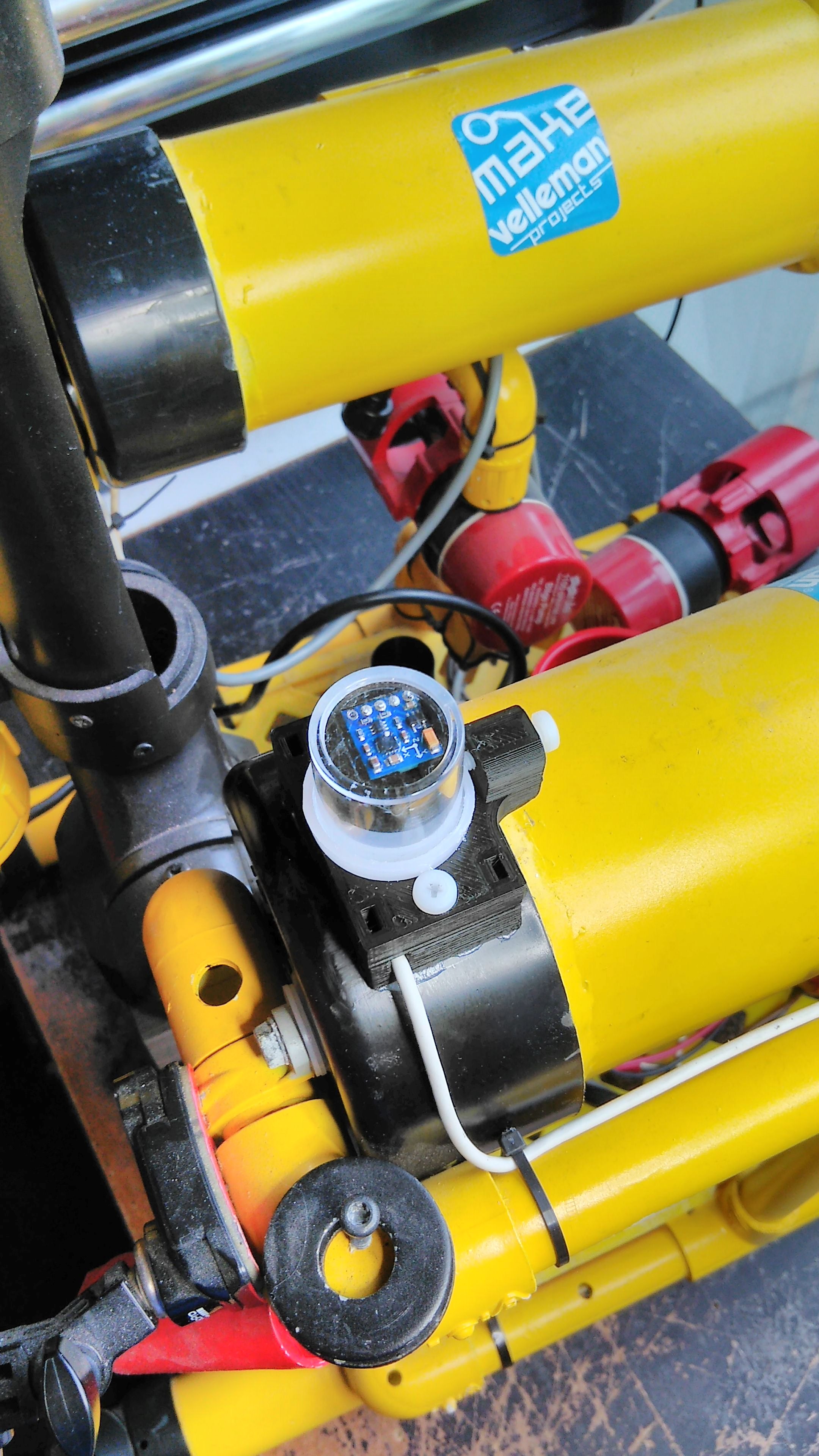

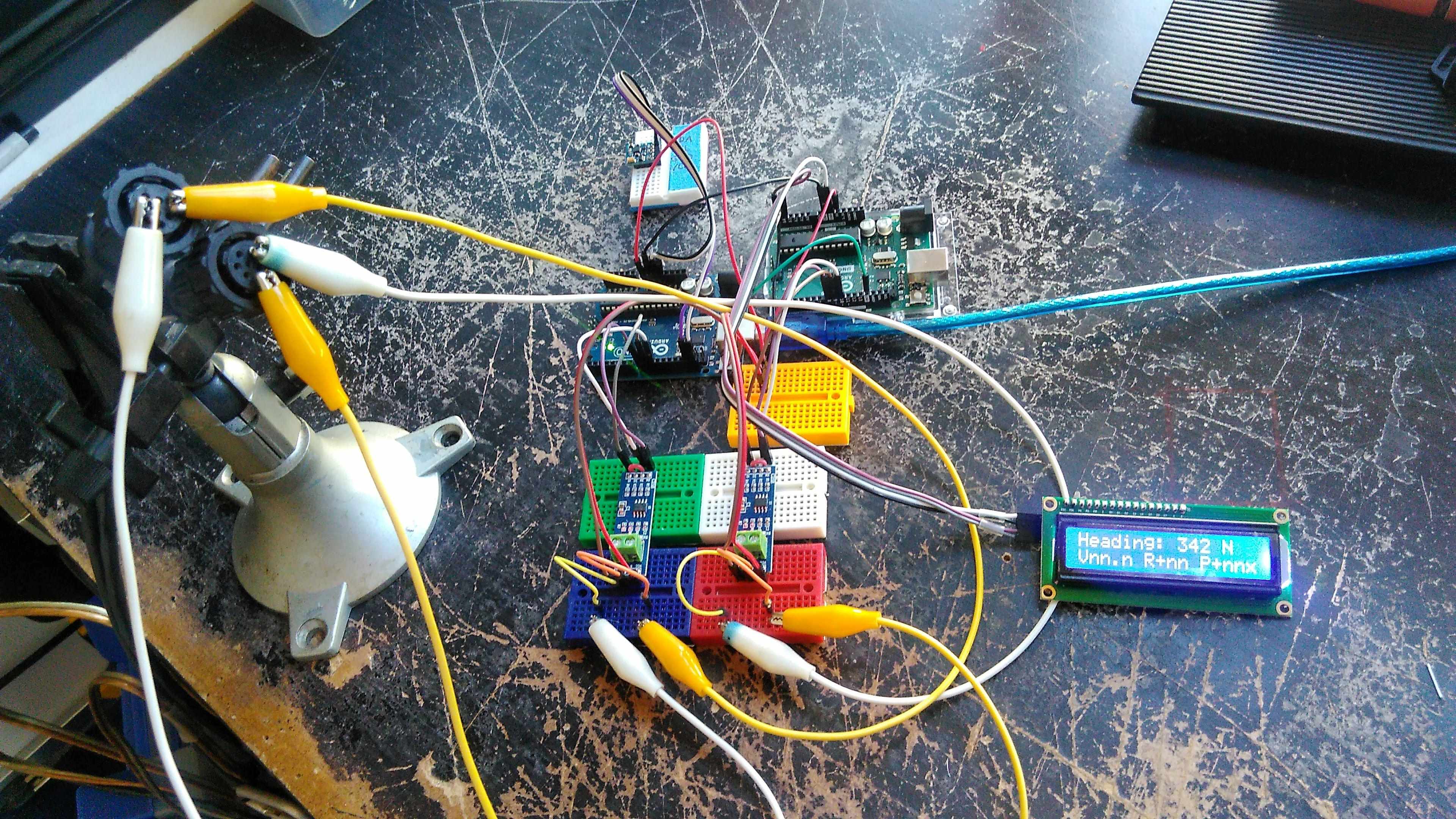

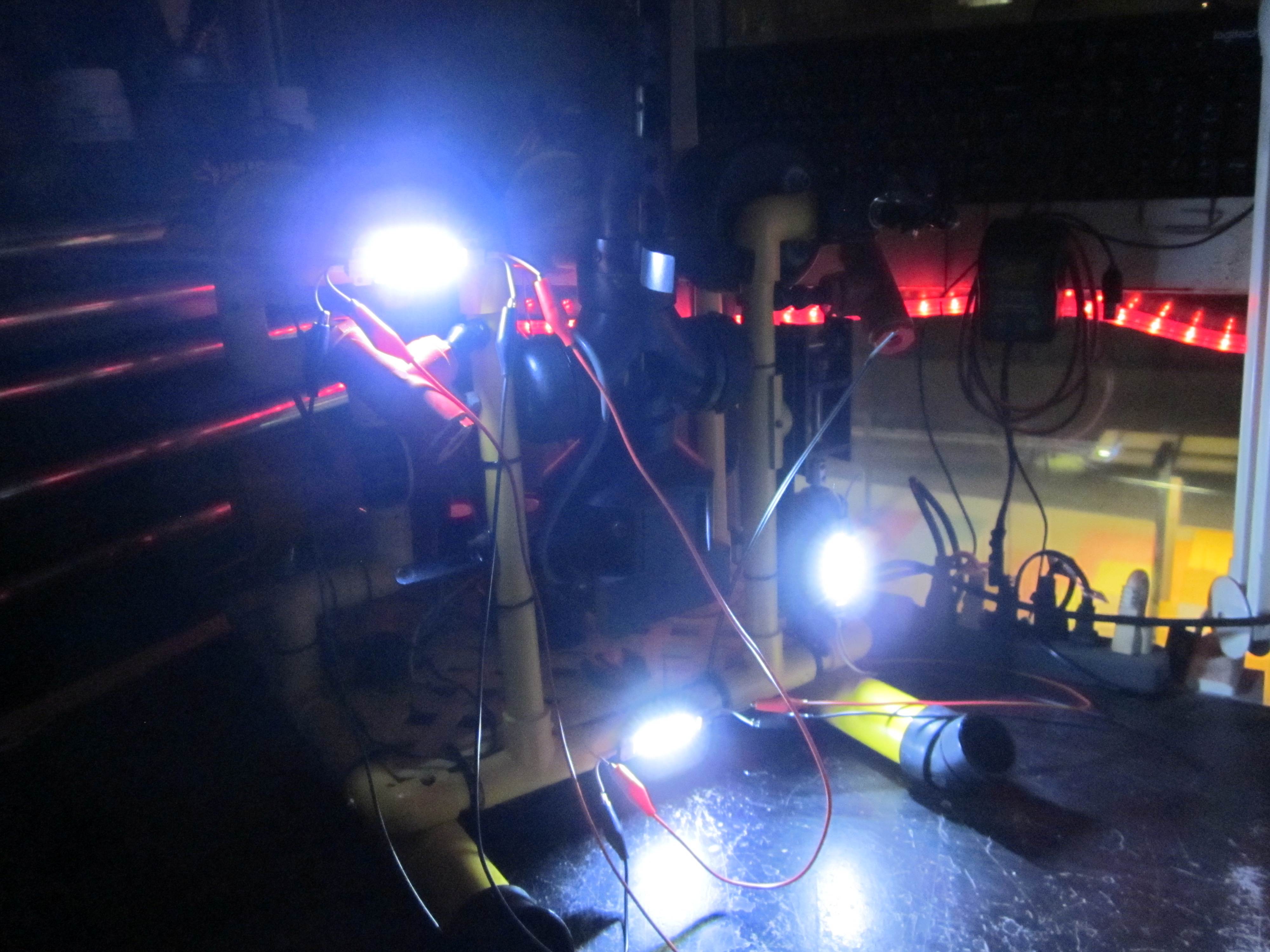

Time for an update. I replaced the big, ugly LED light with 3 small, multi LEDs. Hopefully the epoxy will keep them dry. I also rebuilt the lasers. Got rid of the laser pointers and replaced them with 5v laser modules in 3d printed holders. And the big update is a digital compass. I haven't been back in the water since these changes, so fingers crossed they all work in the water.
