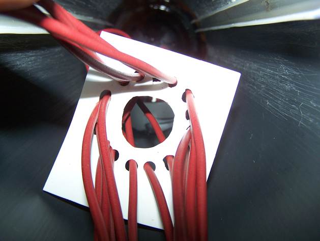

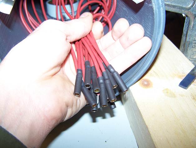

I finally managed to pot the wires on the inside of the ROV. With the help of a styrene guide to keep the conductors evenly spaced and up right while I poured the potting compound to the top of the ”potting well”. I also received more female banana connectors ( they took forever to arrive ) They are now soldered on the wires and insulated with heat shrink.

How do you stop water getting inbetween the external connections?
- bikerbones1968
- Posts: 374
- Contact:
Re: ROV progress
They run wet exposed to the water as do the brushless motors.
