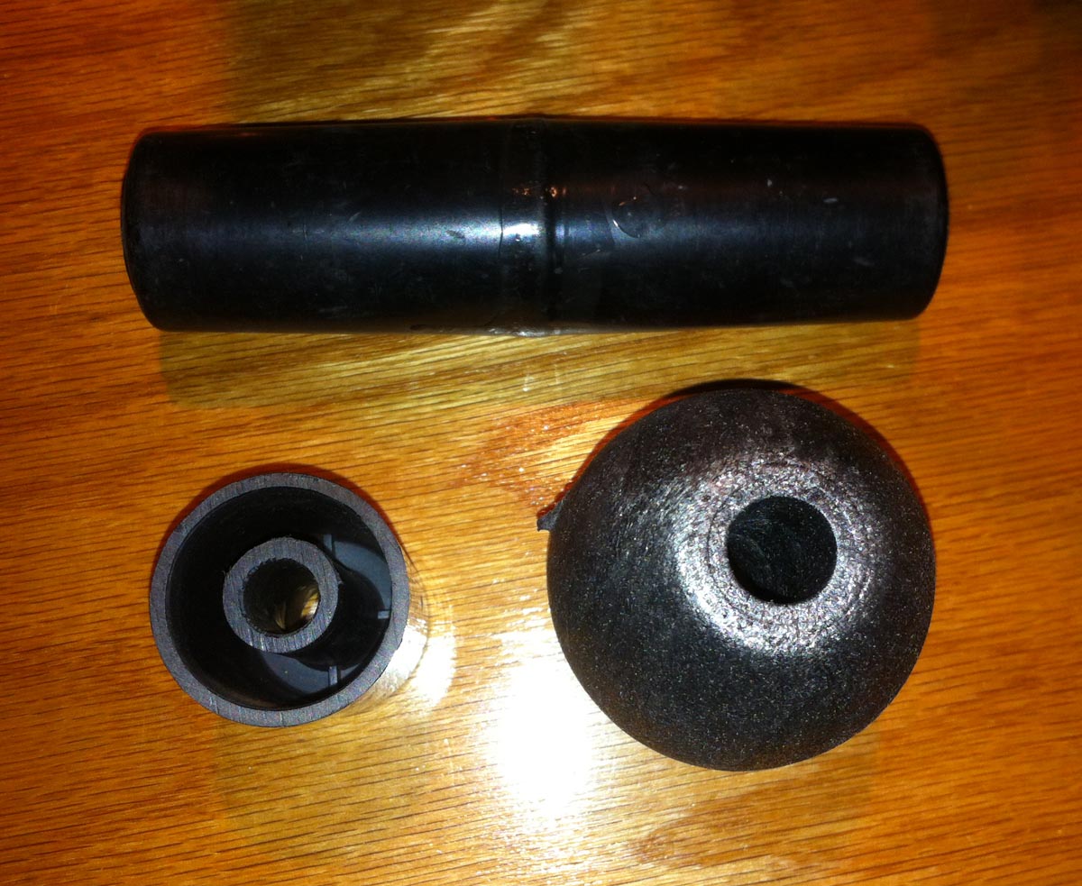

sthone wrote:
So I received my order of floats from Memphis Net & Twine Company, I ordered a few of each, the top row is a variety of the Hard Plastic Floats, first one in the second row is a 2" Dia Standard PVC Sponge Float, and then we have a few Hard Foam Floats.
I haven't actually pressure tested any of these but I'm guessing from there make up they will all be good for the depths most of use are looking to achieve.
The Hard Plastic Floats are pretty solid, they are made in two halves and joined together so they have a center cross section. They are hollow but have a wall thickness of about 1/8" (I cut one in half and will post a picture of it later) the down side is .... the hole through them is only 5/16" (for some reason I was picturing a 5/8" hole when I ordered them.) so you wouldn't be able to fit much more than a ethernet cable through them.
Both the PVC Sponge Float and Hard Foam Floats are pretty solid too, they are not what I expected at all, I figured they would be somewhat squeezable, they aren't. Which is a good thing, I think they should withstand some good depths, but I still have to test them. I still want to hack a few up to see in they can be cut down smaller (to be less bulky) and maybe see if the hole can be drilled bigger, because they too only have a 5/16" center hole.
I'll post more as I continue with my tests.

sthone wrote:Sorry, I still haven't had a chance to test the floats yet.... It's been a busy year for me and I haven't had time to work on many of my Rov projects :(
I will update the forum as soon as I get around to it though.
-Steve 8-)
Did you ever get a chance to test the floats? It's tether time for me and I haven't found a good float yet.
Re: Tether buoyancy idea.
Posted: Jun 8th, 2015, 8:48 pm
I still haven't tested them. :|
But to answer your email the hard plastic ones have a hole a bit bigger than 5/16 where I cut it in half (see pic.) it mics out at about .385, the wall thickness is only about .09 so I'm not sure how much you could drill out. The hard foam ones might be easier to drill out. I was planning on just trying to make a hole saw type bit out of a piece of brass tube and cut teeth in the end. I think the foam ones (I really wouldn't call them foam as they are rock hard) should hold up to some good depths and are what I'm eventually going to try and use.
