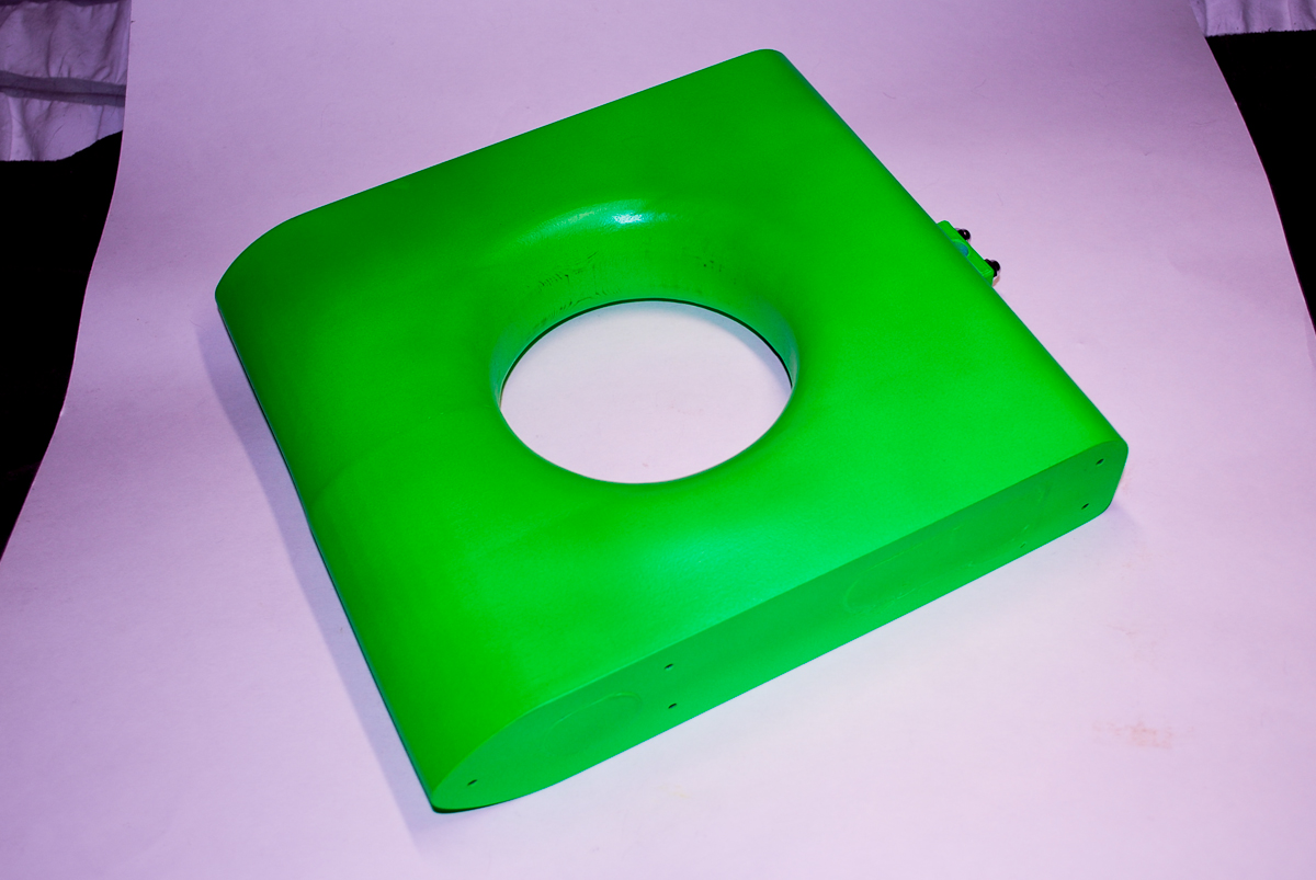

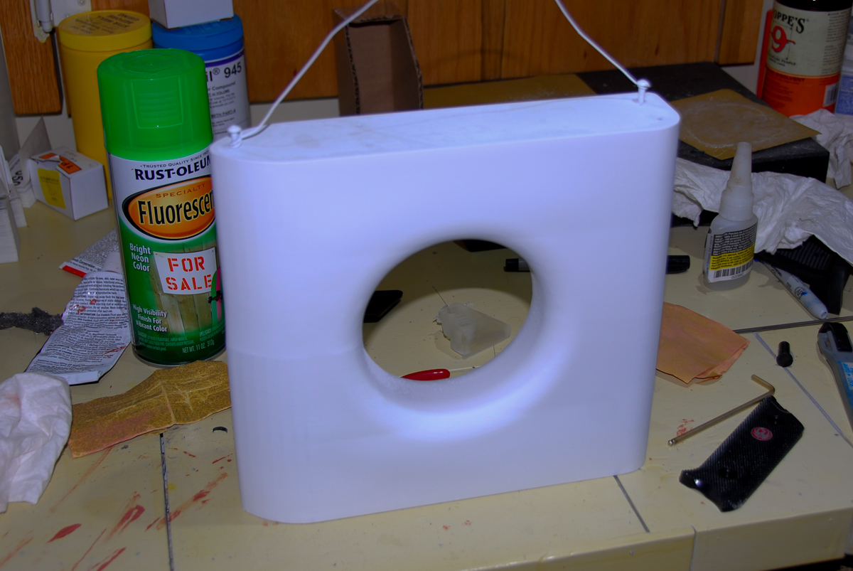

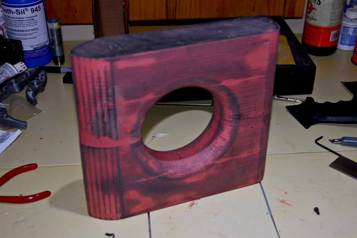

Not much of an update but I've been prepping the float for a quick paint job. I gave the float a rough sand, then covered it with spot glazing putty to fill in some of the imperfections of 3D printing and to try and hide the joint, then a bit more sanding. It's far from perfect but better than nothing I guess.
A few coats of primer and some more sanding and it's ready for some paint. It looks a lot smoother in the picture than it really is but over all I'm happy with it. I'm going to go with a Florescent green for high visibility. :lol:

Here is the finished and painted float pod. It's hard to get a good picture of the true color and the seam still shows but overall I'm happy with how it came out. I have still yet to test how much buoyancy it will provide (I'm kind of scare to find out at this point) but I'll get around to it sooner or later.

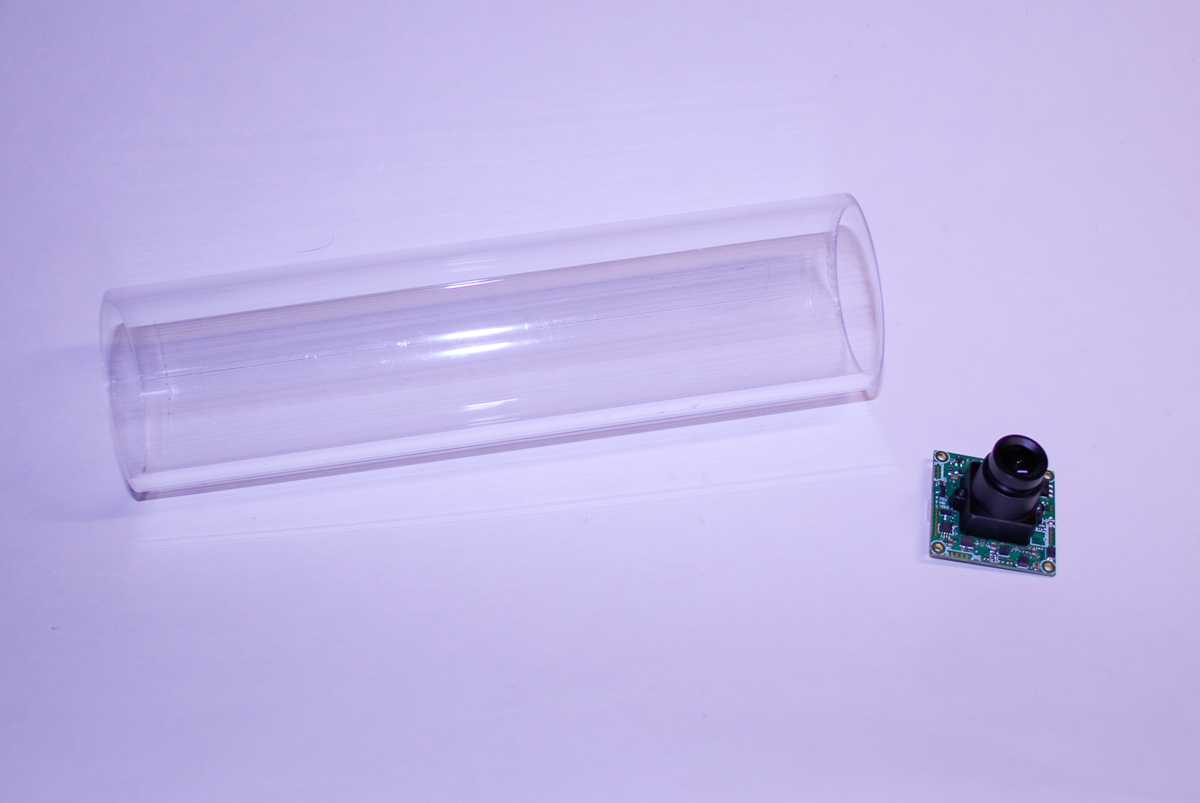

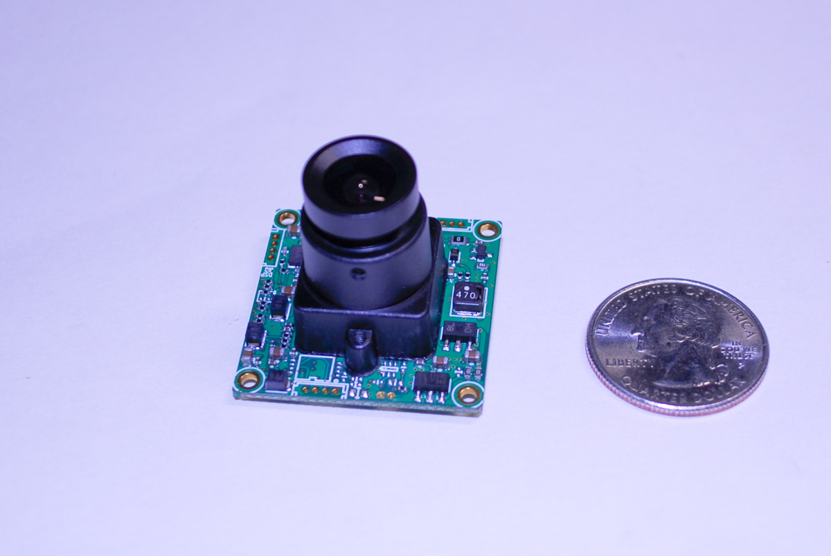

This is the camera I bought to test out. Its a PC600XS Day/Night Color Board Camera from Supercircuits. It boasts 700 Lines of Resolution with a 1/3" 960H Sony ExView Super HAD CCD II imager and a 0.0001 Lux Rating. I've only briefly tested it out so I don't know how well it's going to work yet. It's suppose to produce True Color Images but I think it's only color and then switches to B/W at night so that might be a little disappointing. At $90 it wasn't overly expensive but still not a cheap as some other small board cameras that are around. Hopefully the low Lux rating is worth it.
I had this 1/8" thick clear tube laying around for years and while its a little scratched up it should work for a camera tube for now. I need to make some endcaps for it on the lathe but I don't have any stock to make them from yet so I next I will be designing the camera mount for inside the tube. I think I have a small geared motor somewhere too so the mount might incorporate a tilt mechanism into it too.

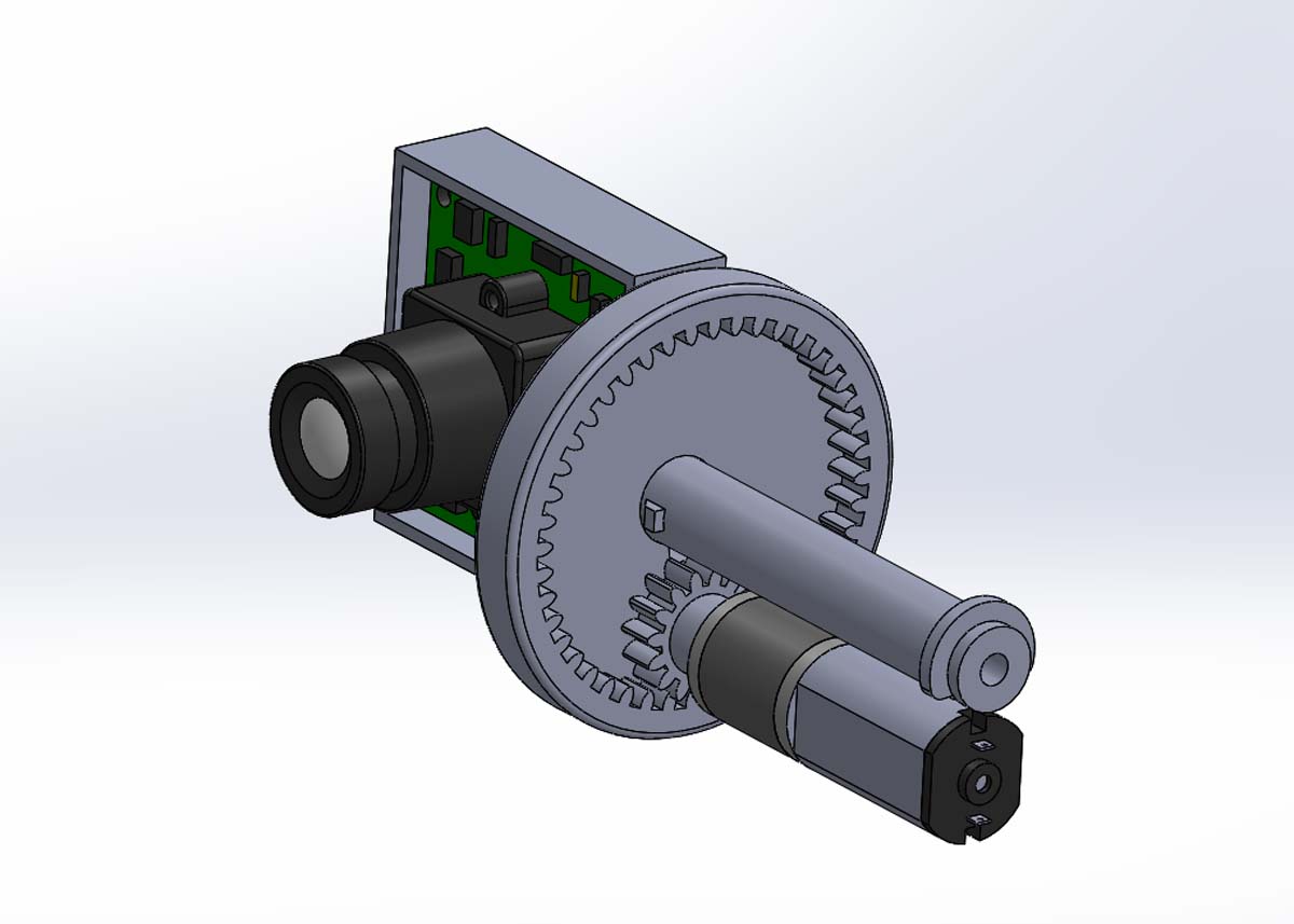

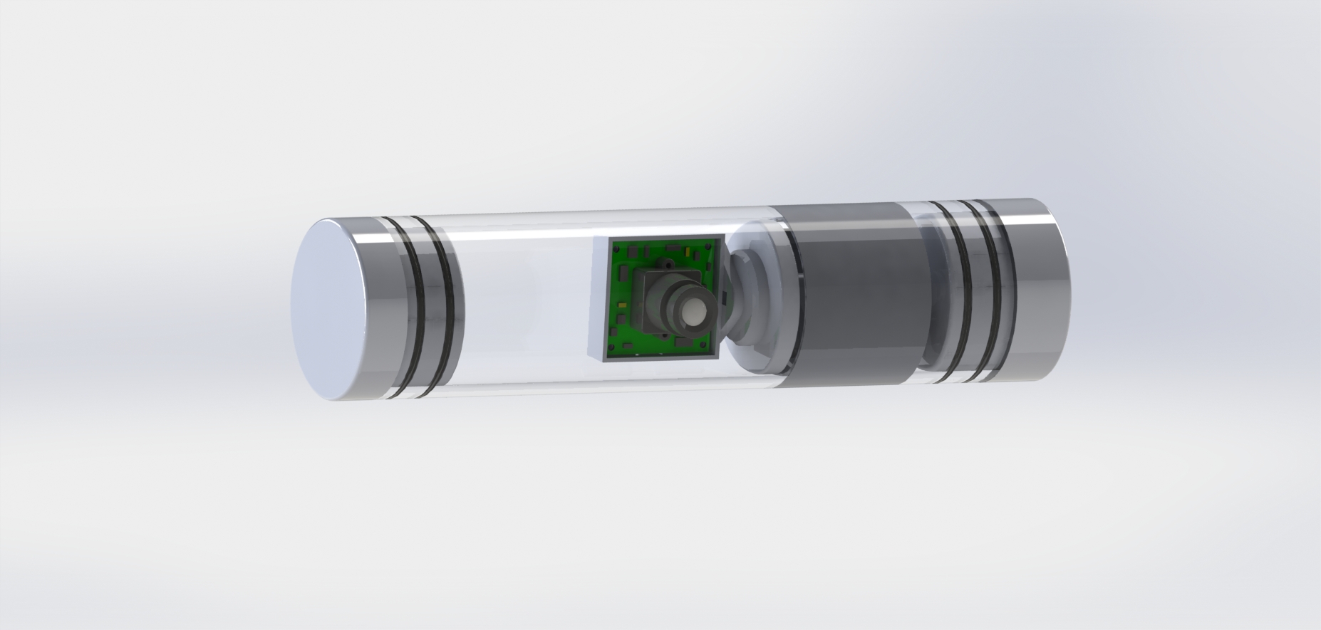

This is a quick rendering of the first prototype of my camera pod for the Rov.

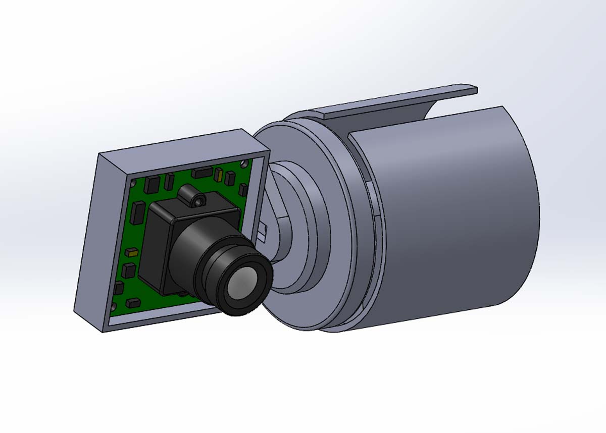

This is what I came up with for the inner working of the camera mount. I was able to incorporate a tilt mechanism into it and the pieces will be 3d printed (of course). I designed the mounts base piece so just slides into the camera tube and is just held in place by spring pressure of the base side walls on the camera tube.

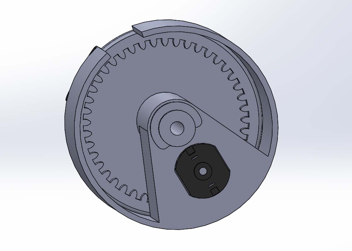

The camera wires are all going to run through the center of the pivot tube...
Camera Tube 06.JPG (83.52 KiB) Viewed 103124 times

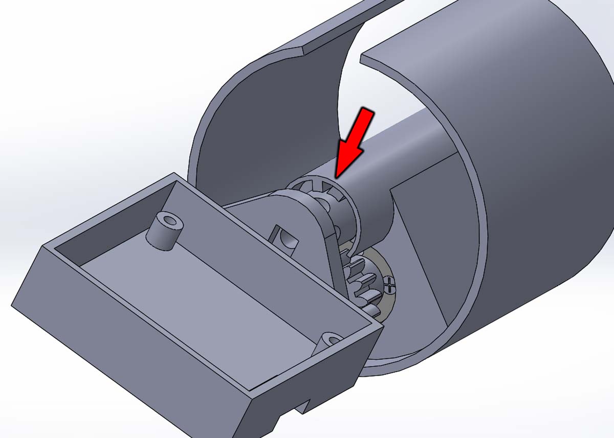

... so to keep the wires from ever being twisted too much if the camera was ever tilted around in one direction to many times I added a stop to the pivot shaft to eliminate that possibility.
Camera Tube 05.JPG (103.55 KiB) Viewed 103124 times
There's no way to put limit switches in here so I used a ball and dent on the shaft to incorporate a clutch like mechanism into the outer gear. When the stop on the pivot shaft hits the ball should just compress the spring and jump to the next dent allowing the motor to keep spinning with out breaking or stripping the gears.

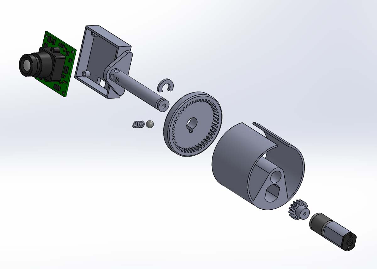

Camera Tube 03.JPG (70.26 KiB) Viewed 103124 times

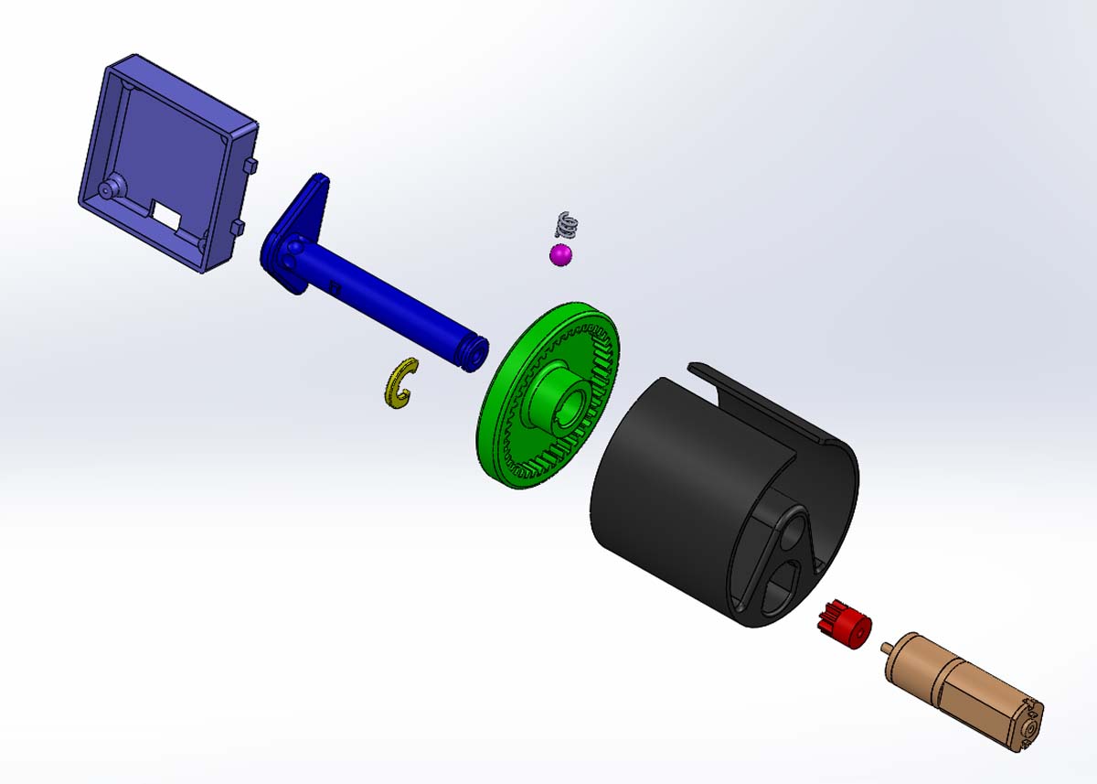

Last but not least and exploded diagram of all the bits and pieces.
Time to fire up the printer and see how well I did..........

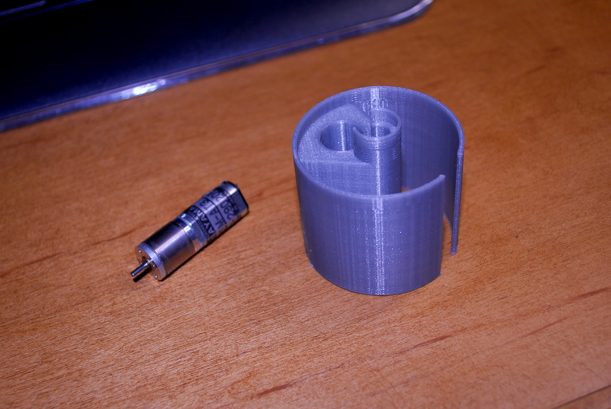

Camera Tube 08.jpg (700.08 KiB) Viewed 103110 times
I printed the base piece first to make sure the motor would fit and the base would fit well enough in the tube.

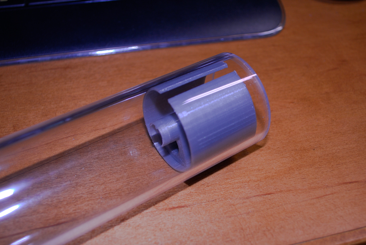

Camera Tube 09.jpg (612.76 KiB) Viewed 103110 times
Everything fit pretty well so far and the spring action walls seem to hold the base in the tube well enough.

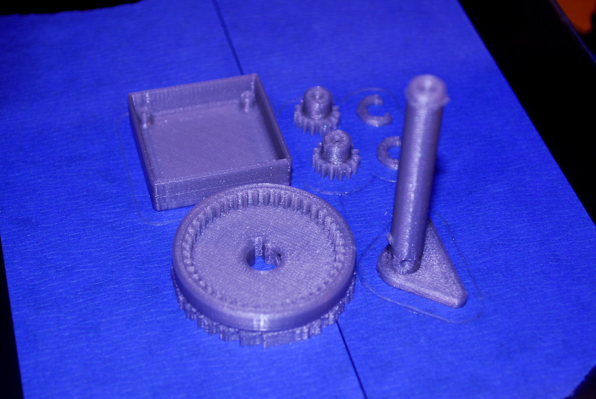

Camera Tube 10.jpg (730.97 KiB) Viewed 103110 times

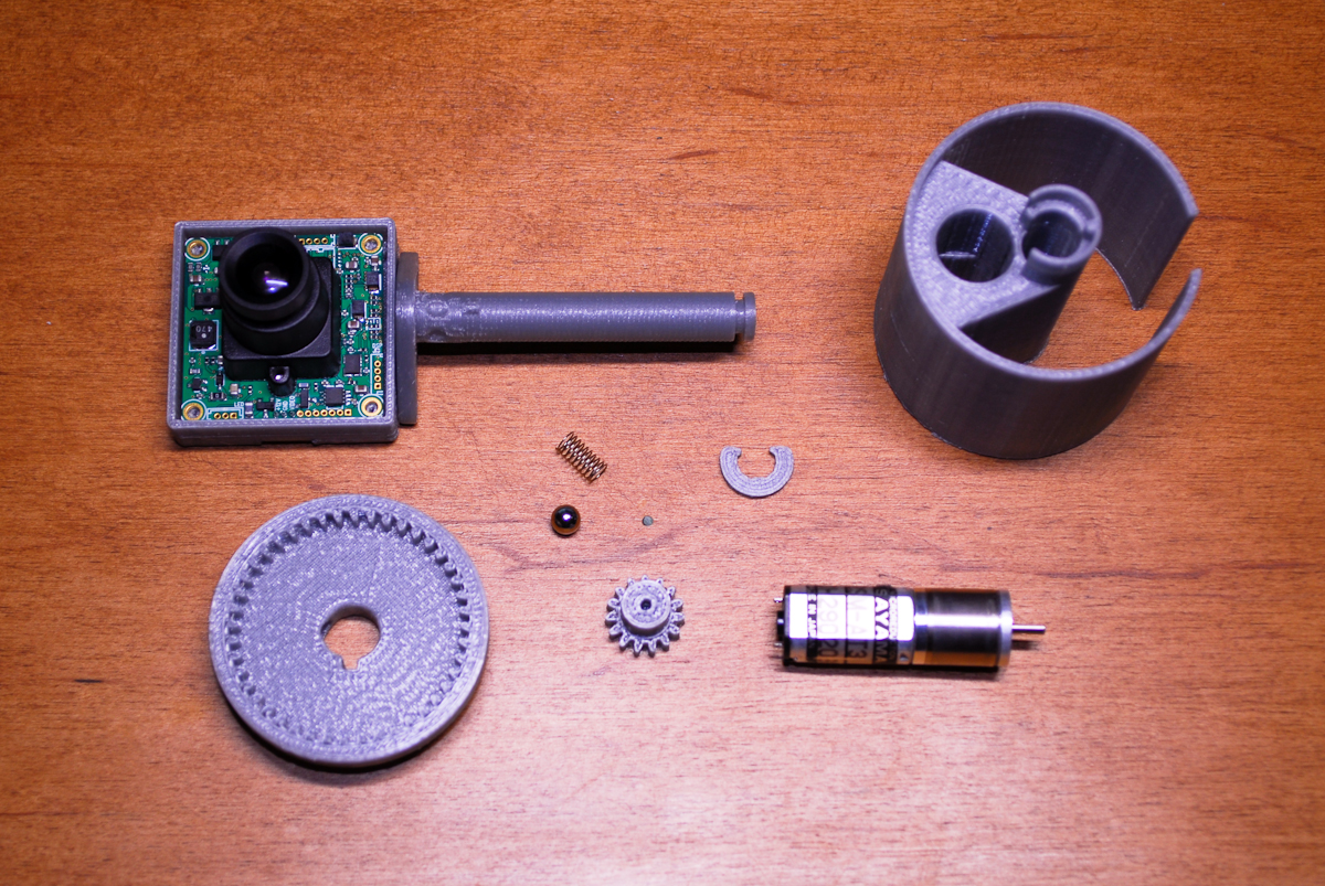

The rest of the piece where printed in one go. I printed the camera arm and pivot shaft in two separate pieces to make it easier to print and I will just glue it together later. I also printed an extra gear and e-clip just encase they needed a little fitting.
Camera Tube 11.jpg (1001.72 KiB) Viewed 103110 times

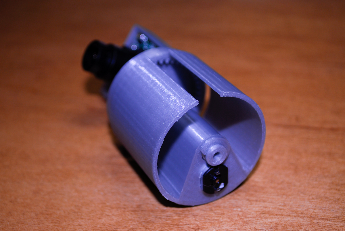

After a little clean up all the parts ready to be assembled.
Camera Tube 12.jpg (751.52 KiB) Viewed 103110 times
Here is the assembled camera mount... so far everything is looking good.

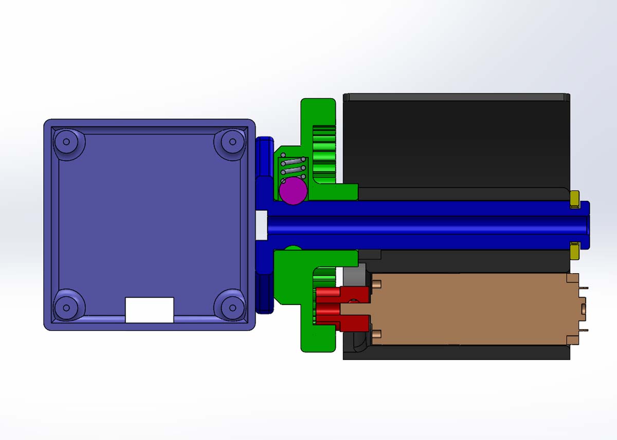

I made a few small design changes today to try an improve things a little. I added a few more dents for the clutch ball on the pivot pin for smoother transitions, added a bit more shaft support to the clutch gear, and the big change I made was to make the drive gear a little smaller so hopefully that will slow the tilt down just a bit.

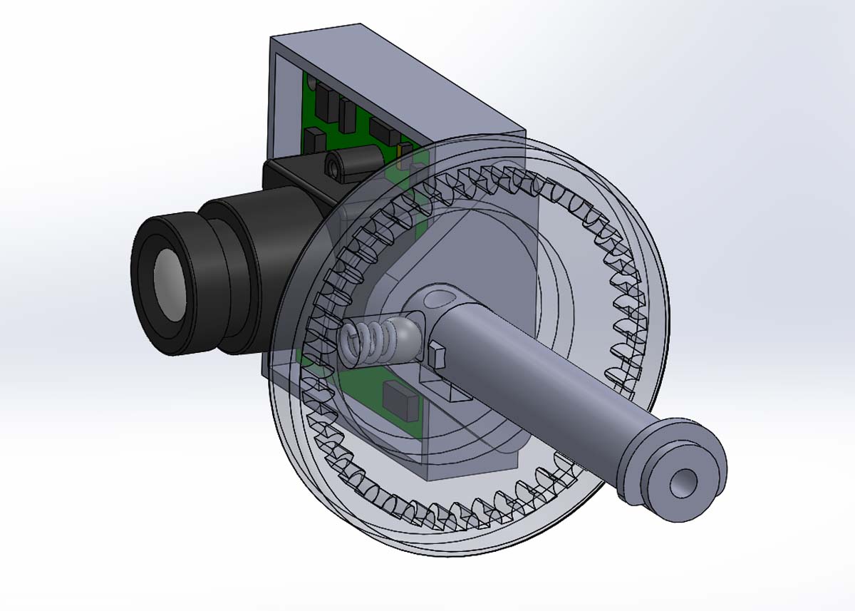

Camera Tube 16.jpg (67.23 KiB) Viewed 103103 times
Here's a cut away picture just to show how things mesh.
Back to the printer for round two.....

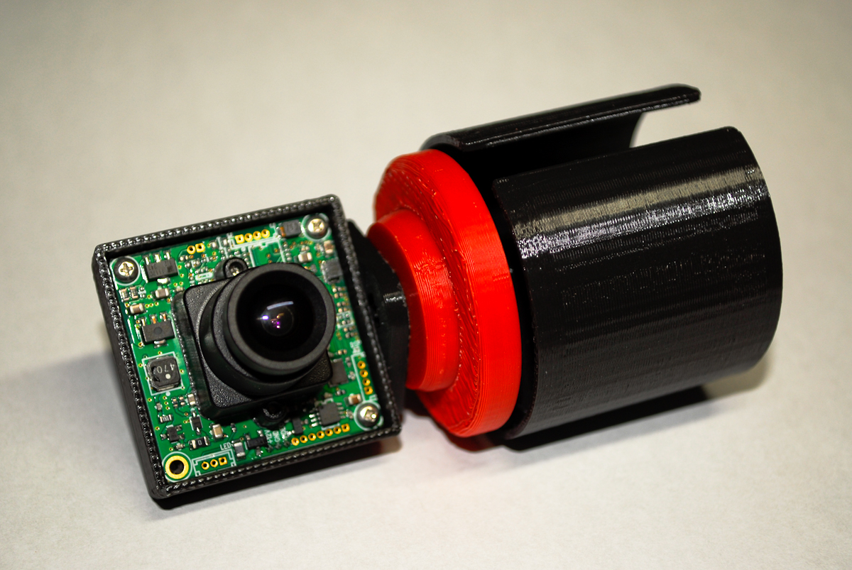

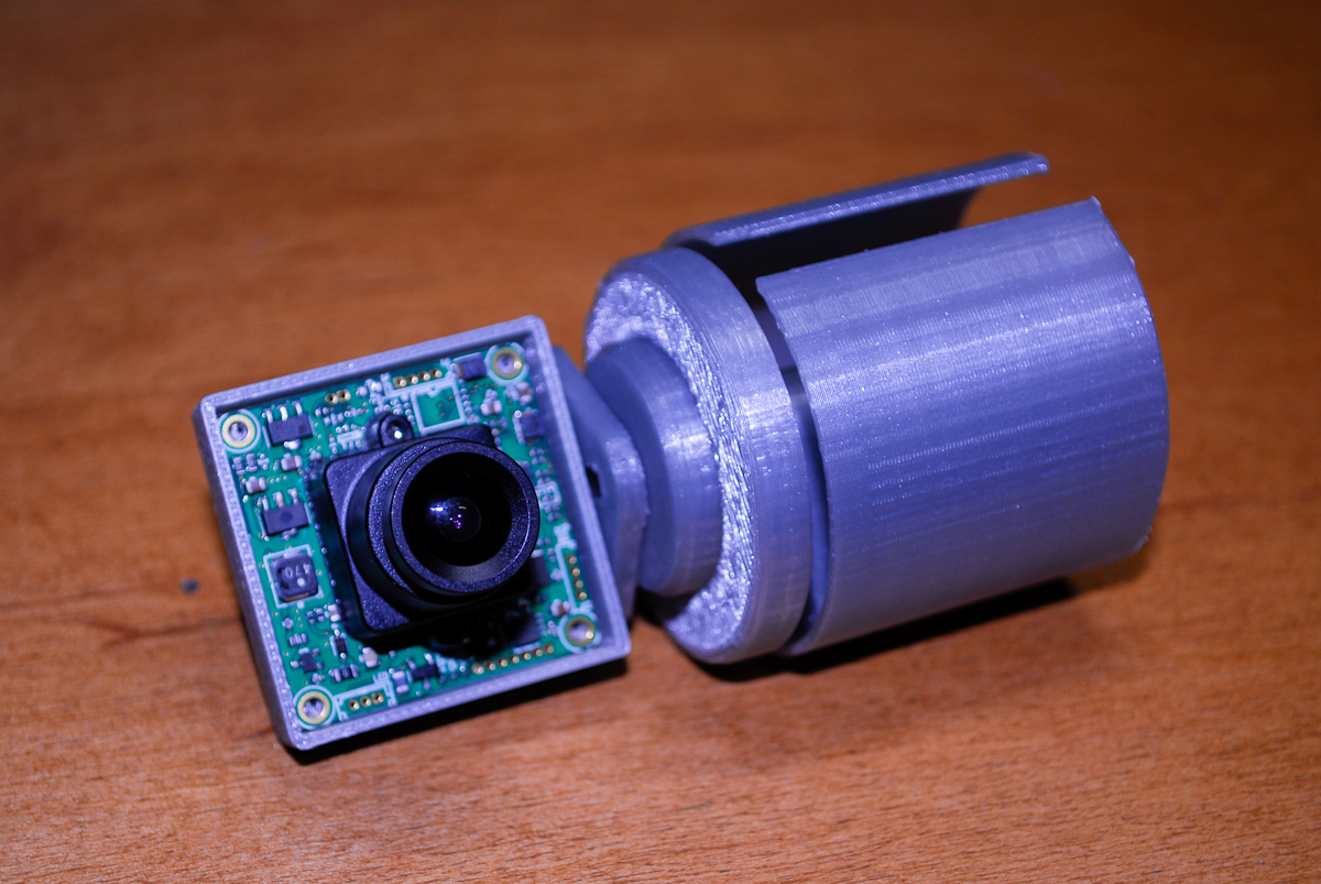

Camera Tube 17.jpg (657.62 KiB) Viewed 103072 times
Here's the finished Camera Mount... with the exception of one of the camera screws not lining up (I drilled the holes off I guess the screws are so tiny) everything works great. The tilt speed with the new gears is perfect now and with the added shaft support I added to the clutch gear the gears mesh up perfect too. I'm very happy with how everything came out. I was a little concerned with how small the teeth were and whether or not they were going to print right but everyday this Makergear printer just amazes me.
https://www.youtube.com/watch?v=QqKdrQoMw6g
A not so exciting video of it in action...
Now I just have to order some stock to make the end caps.. and then continue on with the design.
