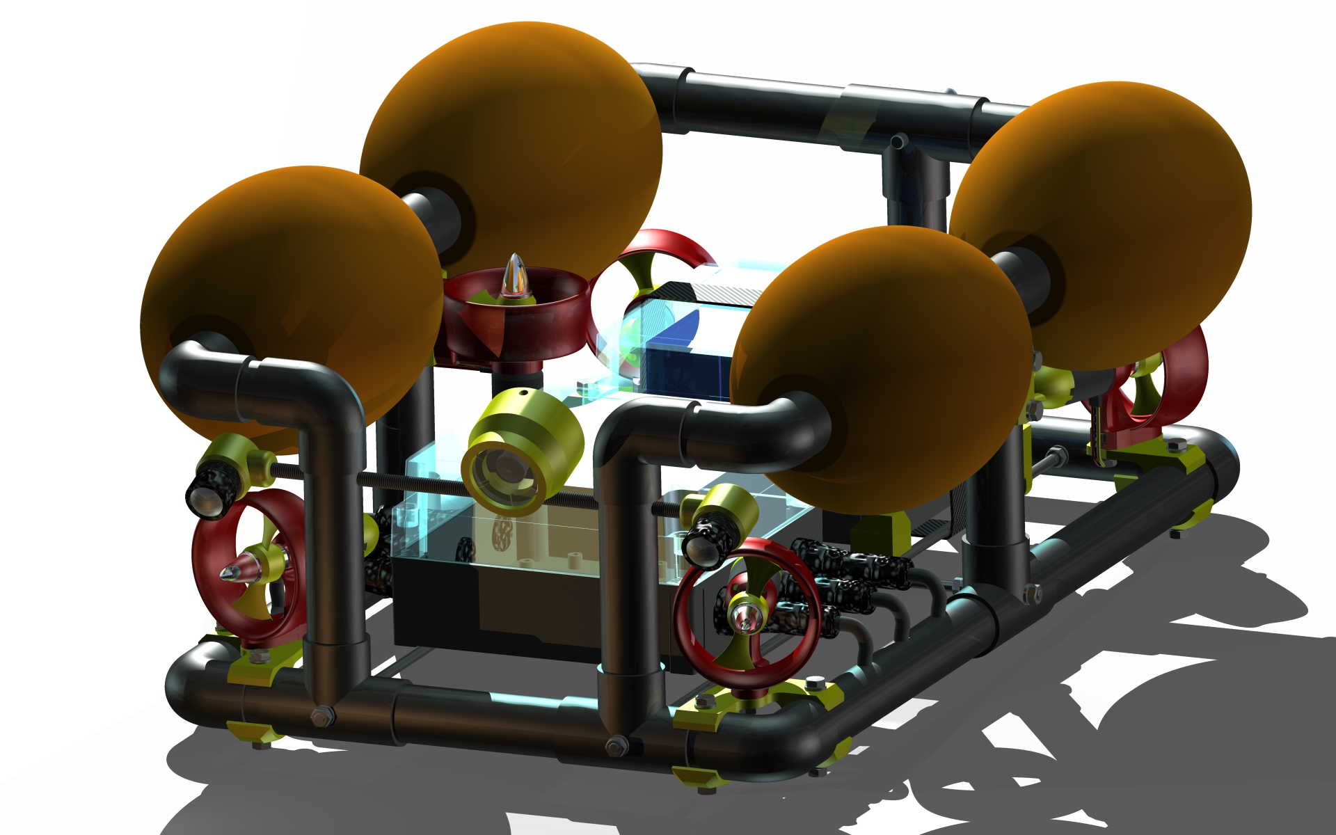

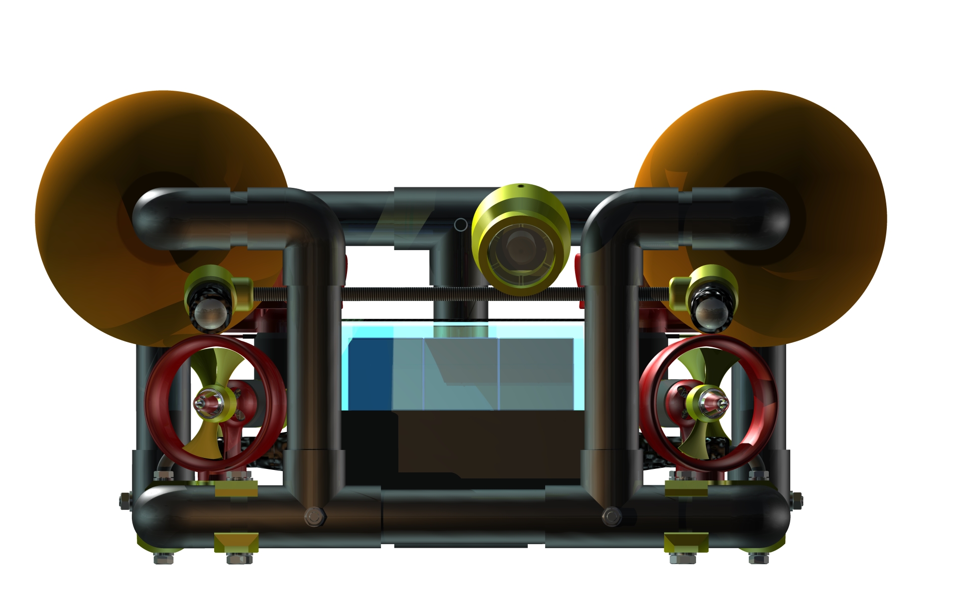

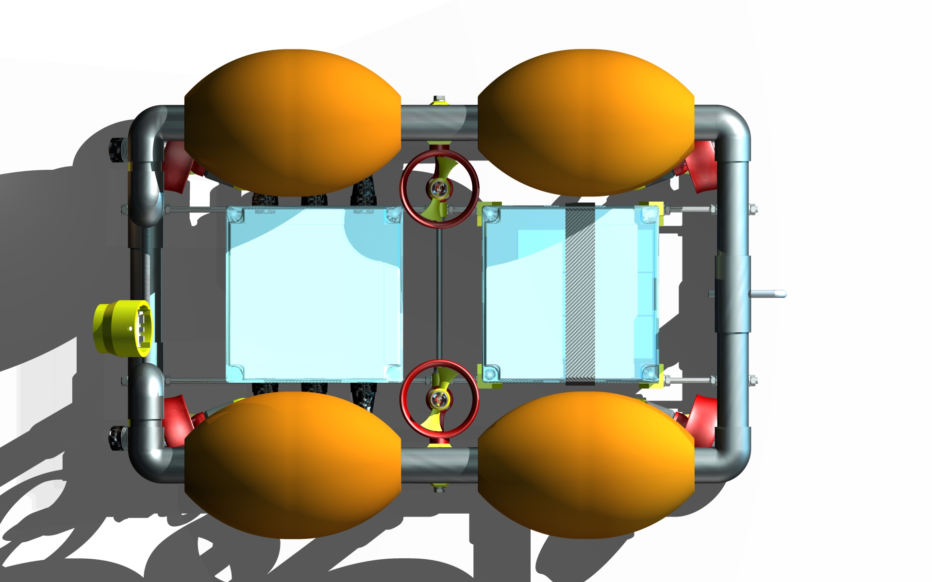

No further testing done yet :roll:
But I have spent some time modeling all the mounting pieces for my thrusters.
It's a lot of nuts and bolts, but shouldn't be a big problem.
Horizontal thrusters are angeled at 20degrees, but can be rotated to 30degrees.
All yellow and red parts in the pictures will be 3d printed. including the camera housing.
Still missing a bunch of details including the arm, el components and misc other things.
Not yet decided if I will run the motor cables through the frame or just ziptie them to the outside of the frame.
All comments and suggestions are more than welcome! ;)

Nice thrusters! I was wondering if you could be so nice to post the cad files of your thrusters. I might 3d print some for my new ROV I'm working on!

Looks like you're making some great progress on your design. I just got some parts that should help me make some progress on my mag-couplers. Looks like lots of new developments in the thruster department (like that Kickstarter campaign Steve listed a couple of weeks ago) will make homebuilt ROVs as lot more available and affordable to many people.
Keep up the good work!
Mike

ltdcruze: Look at my first post in this thread. Updated with links to the files needed to make one of these thrusters.
a_shorething: Yes, the new developments, especially the BlueRobotics thrusters are very exiting stuff. Great work by them! If I had not already invested so much time and money in my own thruster ideas I would definitely invest in a set of BlueRobotics thrusters! Looking forward to see updates from your side!

Very nice Cad work on the thrusters. I started printing out a few of the pieces today and everything fits together very nice. Thank you for sharing your files.
