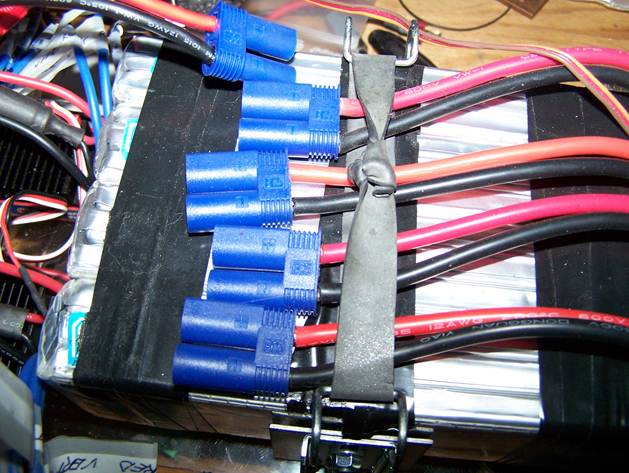

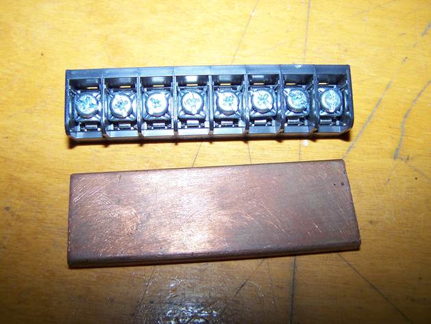

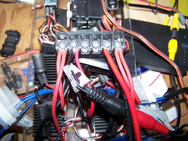

Here is a few pics of the new EC5 battery connectors. I was getting intermitent power loss from the factory deans style plugs so I cut them off and used these instead. To make my terminations for all batteries and ESC's I used a terminal strip salvaged from an old siemens system 3 fire alarm panel, a copper bar with holes drilled in it for the posts and soldered the terminal strip to the bar. The black residue on the back of the completed strip is from electrical tape I had around it for insulation.
terminal strip and copper bar.jpg (45.49 KiB) Viewed 13500 times
terminal strip front.jpg (61.97 KiB) Viewed 13500 times
terminal strip back.jpg (37.64 KiB) Viewed 13500 times
