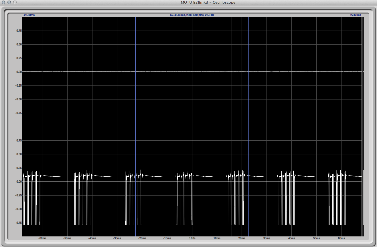

Unfortunately my system doesn't have DSC capability, at least as far as I can tell. It does output ppm, which I've been able to read on my sound interface oscilloscope. I've posted a screenshot of that for the interest.
I'm currently using a Futaba TY4F with a R2004GF receiver, but it seems I need to take a different approach and either get hold of an affordable 4ch (or more) rig with DSC or figure out a way of using the PPM from the trainer port. Any suggestions gratefully received!

Is there a trainer port on that rig? If you have already found the PPM out of the TX then all you need is a RX and locate the PPM input for the ciruit. I will dig around for some information for you.
