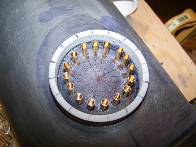

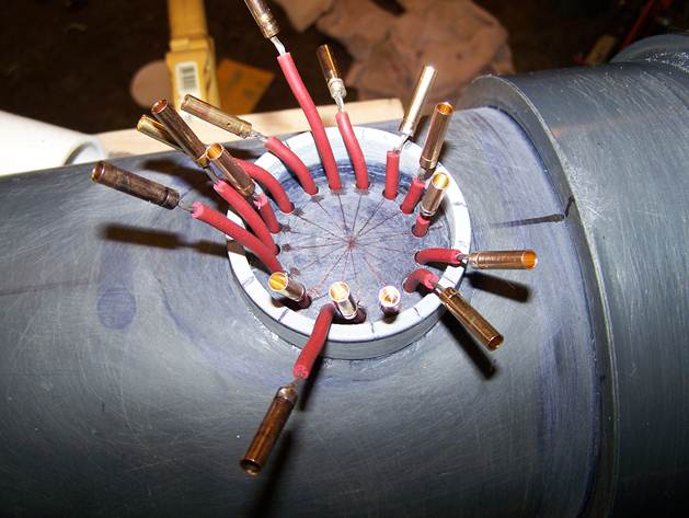

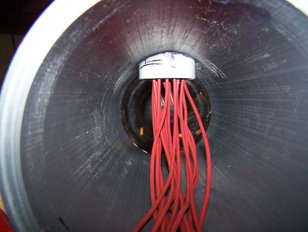

Now the female Banana plugs, with wires pre soldered are slipped through the holes. A little touch of epoxy on each one and push them into the hole. Actually they fit so tightly in the holes I had to use a common nail and a rubber hammer to drive them in the right depth. Once the epoxy has had time to setup and fully cure. I will fill the "well" with QSIL 216 two part silicone sealant just to the top of the plugs. On the inside "well" I will first pour a thinned down firberglass resin this should lock everything in place around the solder joints and down into the holes. When that has had a chance to cure over night I will fill the remaining 1" interior "well" with more QSIL 216. If all goes well its back to the lake for another submersion test to verify I am still leak free.

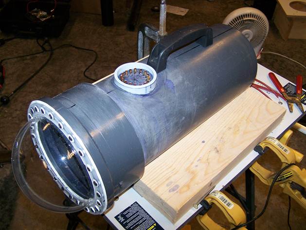

Thought adding a easy way to carry the ROV with a handle would be good. I may laminate a 1/2" thick piece of PVC directly on the top of the ROV to give lots of material to attach the handle to.

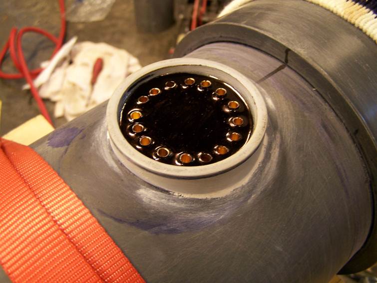

The first bit of sealing is done sealing the brass sockets in the exterior "potting well".
