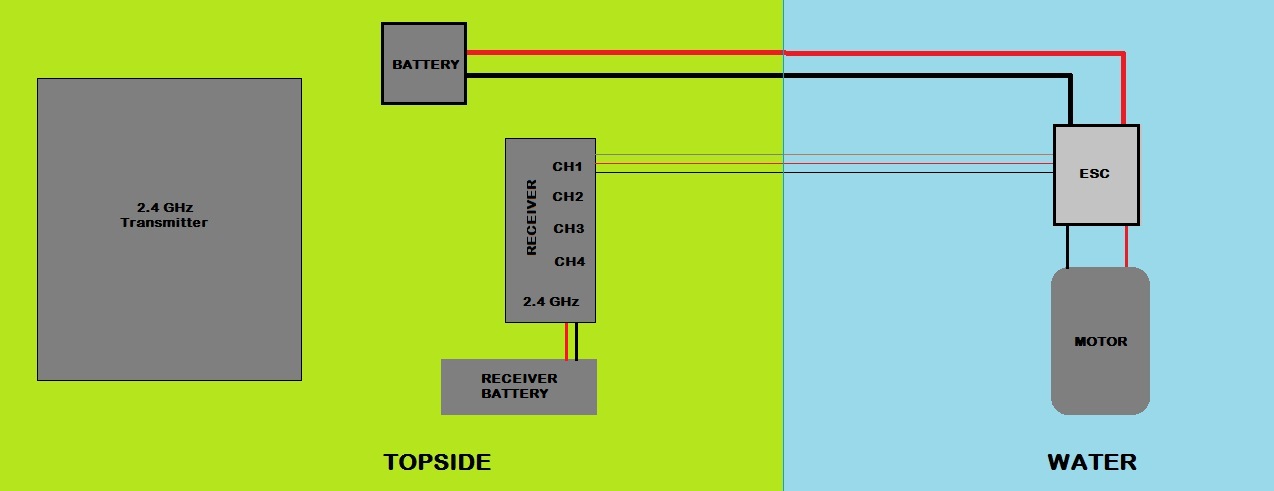

Ok then your in buisness. Using the DSC the PPM data works on over 1000 feet. If you get stuck with programing etc let me know.
2.4 GHz Setup
2.4 GHz Setup
- control.jpg (49.69 KiB) Viewed 3993 times

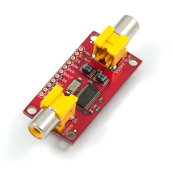

Which OSD are you using? Thinking of getting one
- bikerbones1968
- Posts: 374
- Contact:
Re: RC transmission through tether
Sparkfun OSD breakout board.
https://www.sparkfun.com/products/9168
- OSD.jpg (115.83 KiB) Viewed 3991 times
