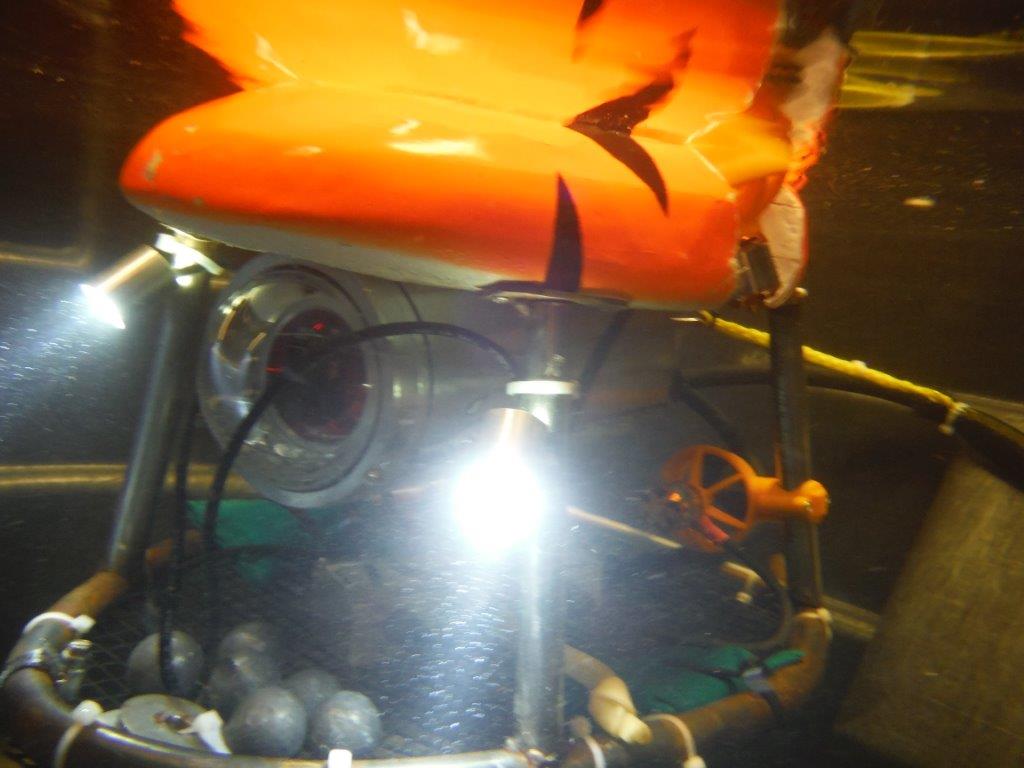

Here are some pictures from the test and as I work to get all the electronics cleaned up.
I am adding a solid state relay to turn the batteries on and off. When the tether is shut down the relay is off.

The latest video. This was a test in a livestock water tank at our last Kitsap CREATE meeting.
