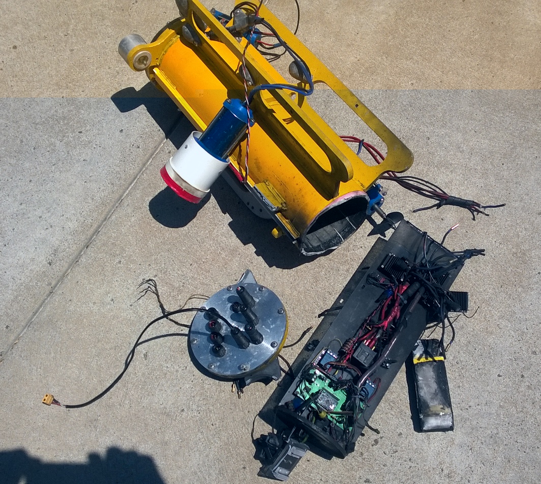

Well after a long absence I decided to get the ROV out and do some work on it, last night I ordered some new parts for PPM control using a standard RC radio. I also dug out a Video Tx and Rx to hopefully solve my video problems I was having.
This will also allow me to have a wireless tether reel in that there will be a Rx for the radio and Tx for the video inside the hub spinning at will.
So I put my ROV on charge and after about an hour BOOM!!! :?
I think I may also review my battery charging method, I knew it wasn't the best to charge the packs in the ROV.
Anyways I was very lucky not to have gotten hurt, at the time it exploded I had just placed my hand on the side of the case to see if it was warm, not much hair left on that arm but my eyebrows are still intact. :)
Re: My ROV
Wow
:o :shock:
Re: My ROV
WOW :shock: is right, glad you didn't get hurt.
Thanks for posting though this points out some of the dangers that can occur with any hobby.
