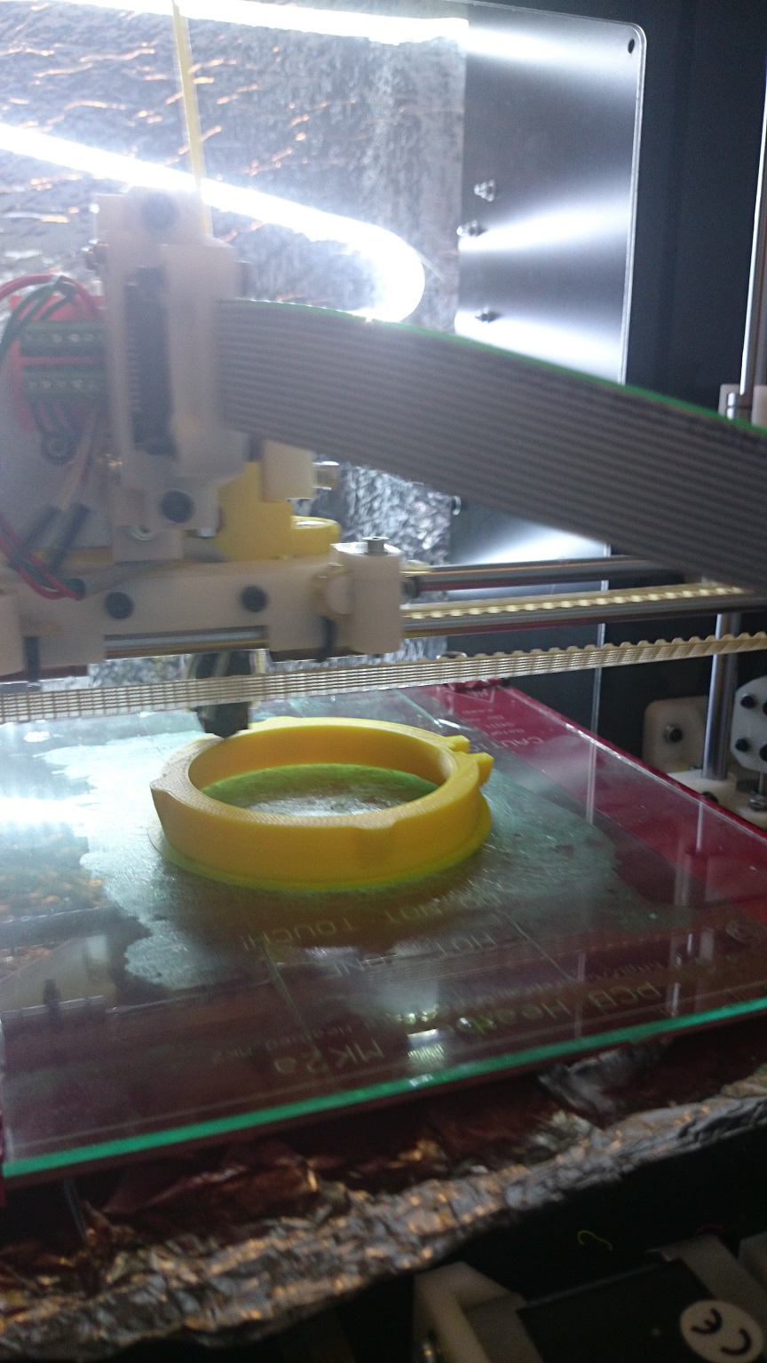

However my test shroud and prop combo is finally printing now. 46% and 1h55mins in at this point. If assembly goes ok, I hopefully can do some testing tomorrow.

Thruster pictures:
2014-08-19 20.09.32.jpg (353.03 KiB) Viewed 5482 times
Printing done.
Still need some finishing touches, but came out pretty good. 3h 40min print time @ 0.2mm layer height. The surface looks a lot rougher then it feels.

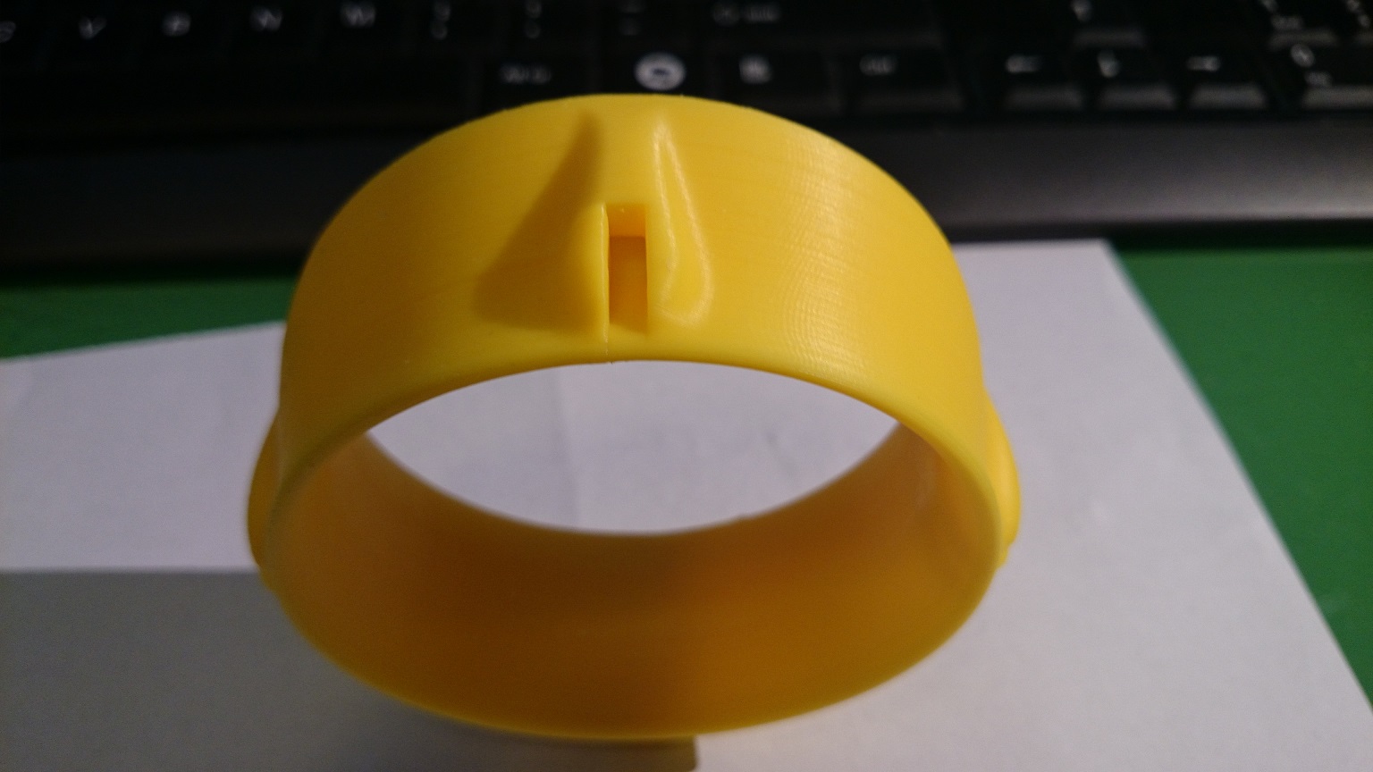

2014-08-19 22.34.28.jpg (249.83 KiB) Viewed 5467 times

Wow, that shroud looks great!

Really nice work with the shroud!!!! :shock:

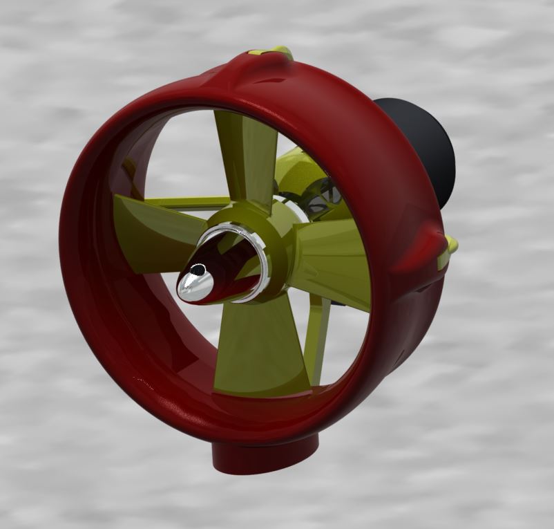

One question because I am a bit confused .which direction your propeller spin?Because I think you should reverse the shroud 180 degrees .

The nozzle will be most efficient in the direction on the picture you posted. However according to the literature you can find about the rice nozzle on the web, it should increase the efficiency in both directions.
Also, the propellers I am testing with, witch is the ones in the rendered pictures are 100% symmetrical and should perform equally in both directions. The nozzle and flow obstacles like the motor will change this though. Test will show by how much.
Printed the rest of the parts now, but I think I will have to go back to the drawing board again. The arms that was intended to hold the motor became to weak and hard to assemble. And if this thing can max out at a couple of kilos then I think the arms will flex too much and the prop will end up touching the nozzle.
I have a new idea and working on modeling it now.

New day, new design.
I removed the arms that I intended to use to mount the motor and have now replaced them with one mount (Shown in blue in the pictures)
This thing is a lot easier to print and will be 10x stronger. also making sure the motor and nozzle is centered will be a lot easier.
As you can see in the pictures the two pieces slot together so that they are all lined up and secured with one M6 bolt on each.
Downside is that I need to print a new nozzle :P
Also added a cone for the motor.
