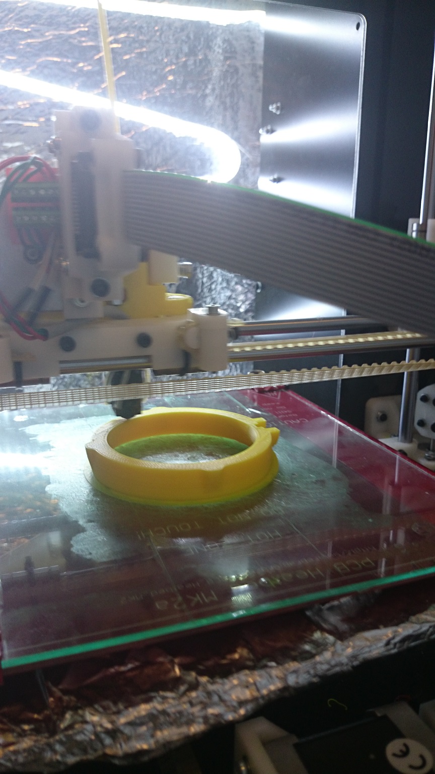

However my test shroud and prop combo is finally printing now. 46% and 1h55mins in at this point. If assembly goes ok, I hopefully can do some testing tomorrow.

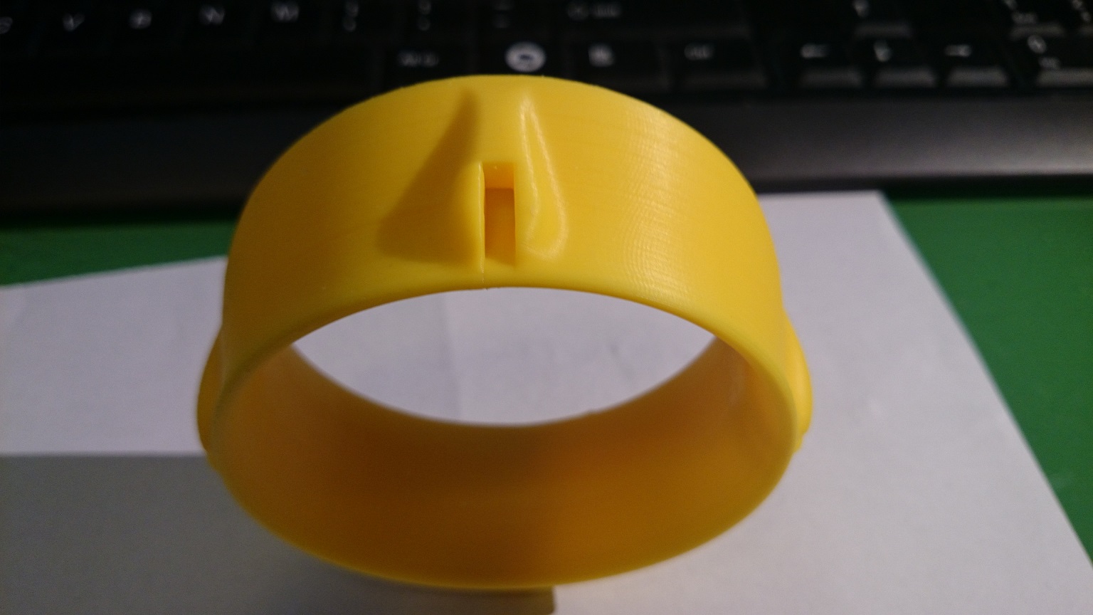

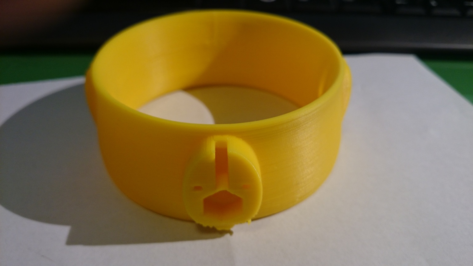

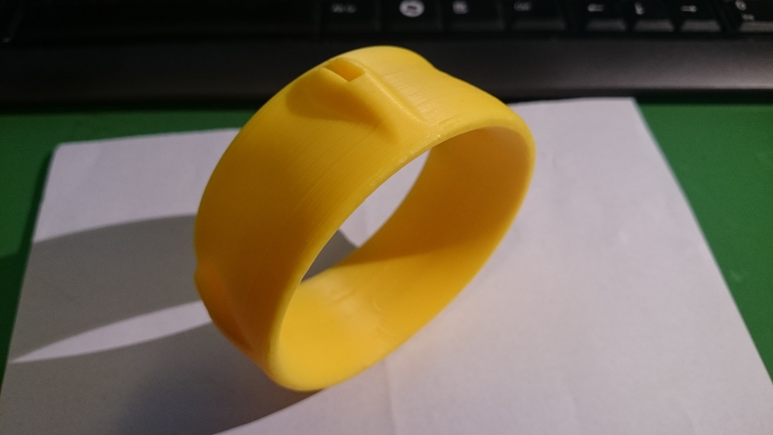

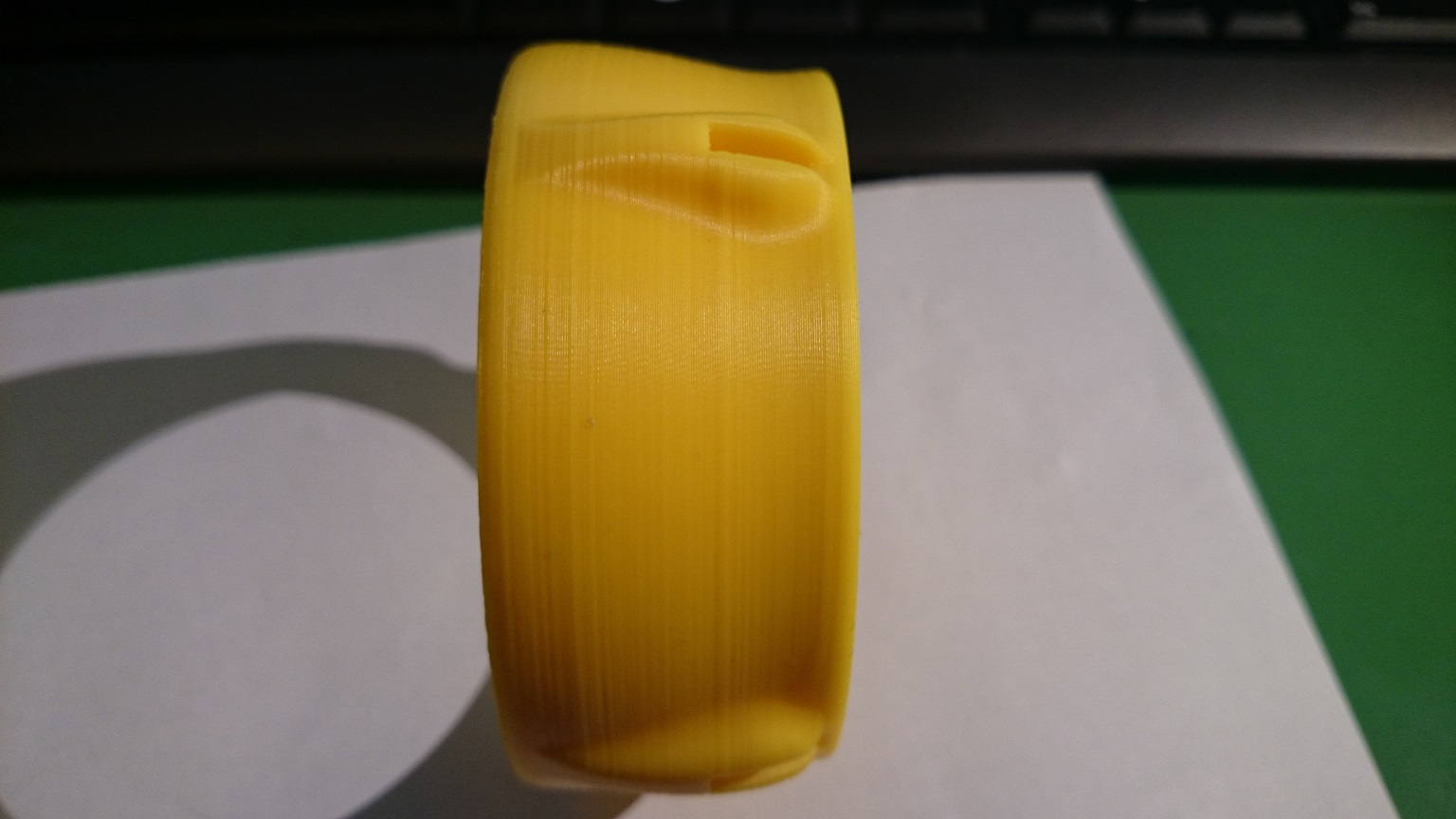

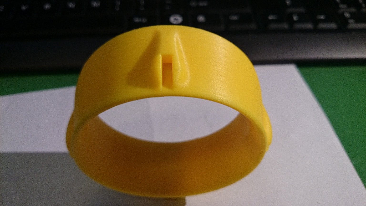

Thruster pictures: Printing done.
Still need some finishing touches, but came out pretty good. 3h 40min print time @ 0.2mm layer height. The surface looks a lot rougher then it feels.

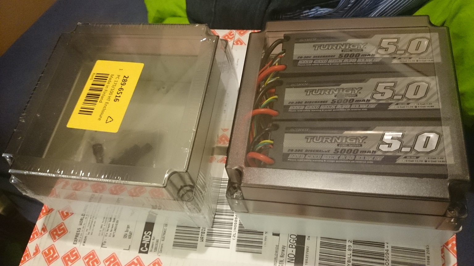

My Battery and electronics housing arrived. Two Fibox 180x180x100mm cases. IP 67 rating and actually came with a vacuum in them. Was really hard to get the lid of, but at least they are even air tight
I also got lucky and scored some subsea connectors to use between the battery box and the electronics housing.
The company a friend of mine is working for had ordered them by mistake and couldn't return them. According to him they are rated for 64 amps and waterproof down to 300m. Really good stuff! Will post pictures when he comes by with them.
Picture of battery and electronics housings, Six 4cell batteries in the one to the right:

Wow, that shroud looks great!
Can't wait to see what kind of results you get out of the assembled thruster.
Keep up the good work.
Re: I'm jumping in!
Really nice work with the shroud!!!!

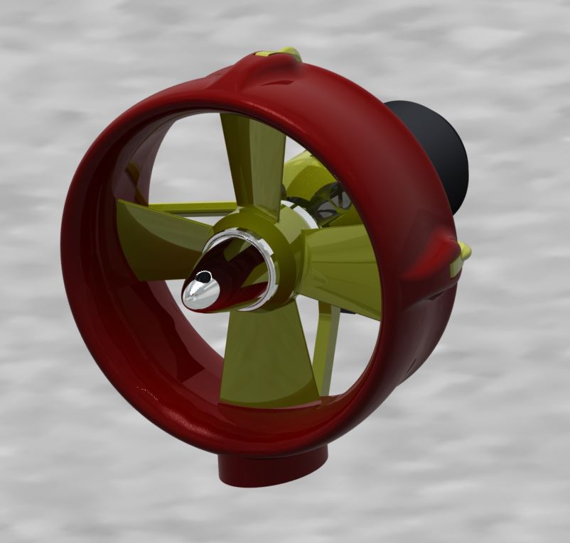

One question because I am a bit confused .which direction your propeller spin?Because I think you should reverse the shroud 180 degrees .
- image.jpg (8.25 KiB) Viewed 5435 times
Re: I'm jumping in!
Thanks Bubbles!

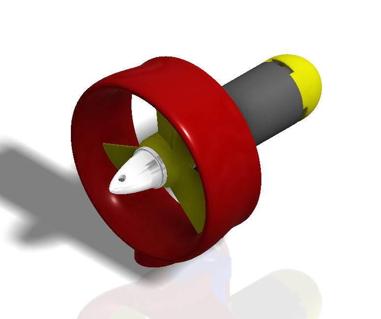

The nozzle will be most efficient in the direction on the picture you posted. However according to the literature you can find about the rice nozzle on the web, it should increase the efficiency in both directions.
Also, the propellers I am testing with, witch is the ones in the rendered pictures are 100% symmetrical and should perform equally in both directions. The nozzle and flow obstacles like the motor will change this though. Test will show by how much.
Printed the rest of the parts now, but I think I will have to go back to the drawing board again. The arms that was intended to hold the motor became to weak and hard to assemble. And if this thing can max out at a couple of kilos then I think the arms will flex too much and the prop will end up touching the nozzle.
I have a new idea and working on modeling it now.

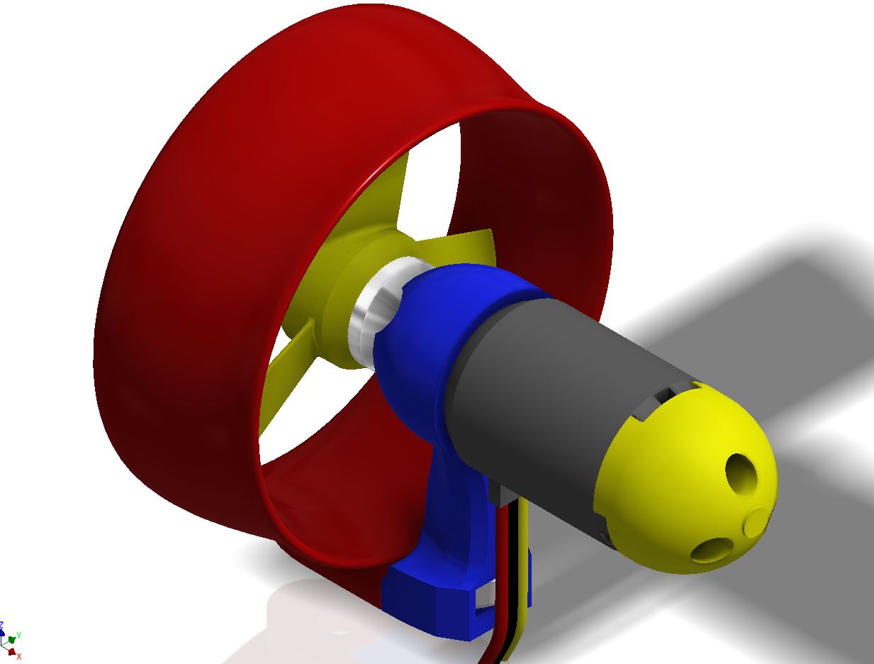

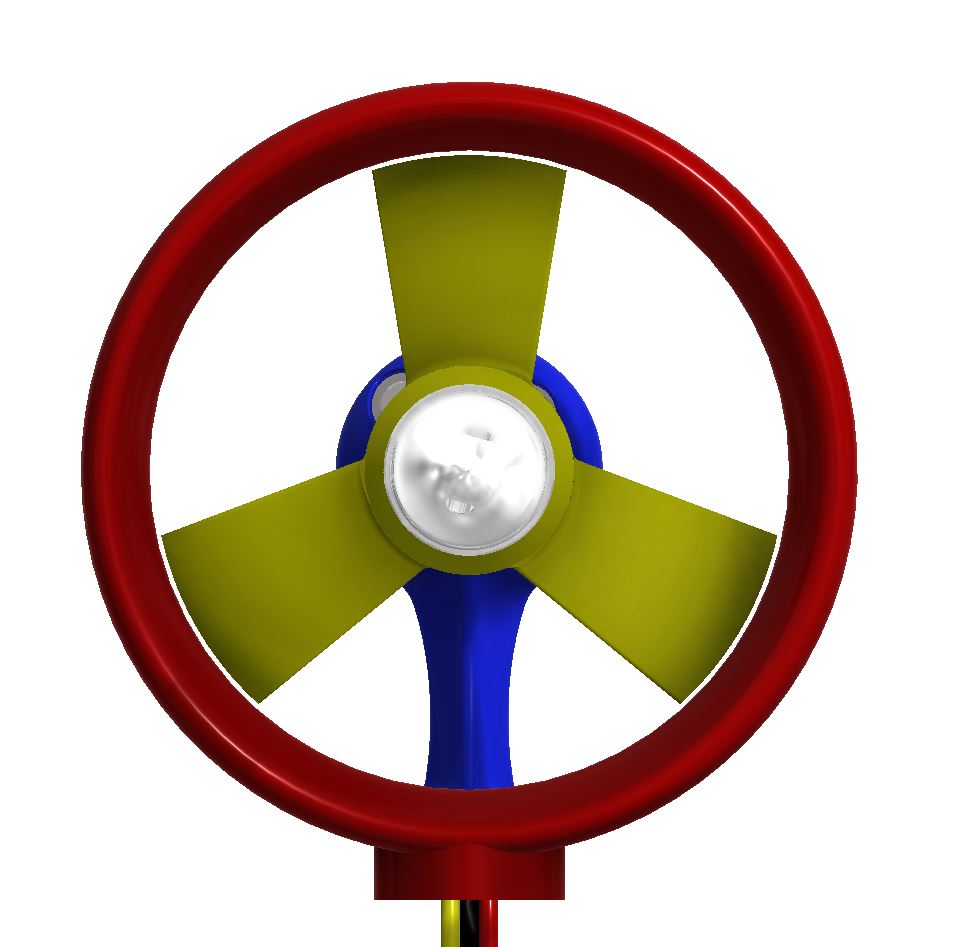

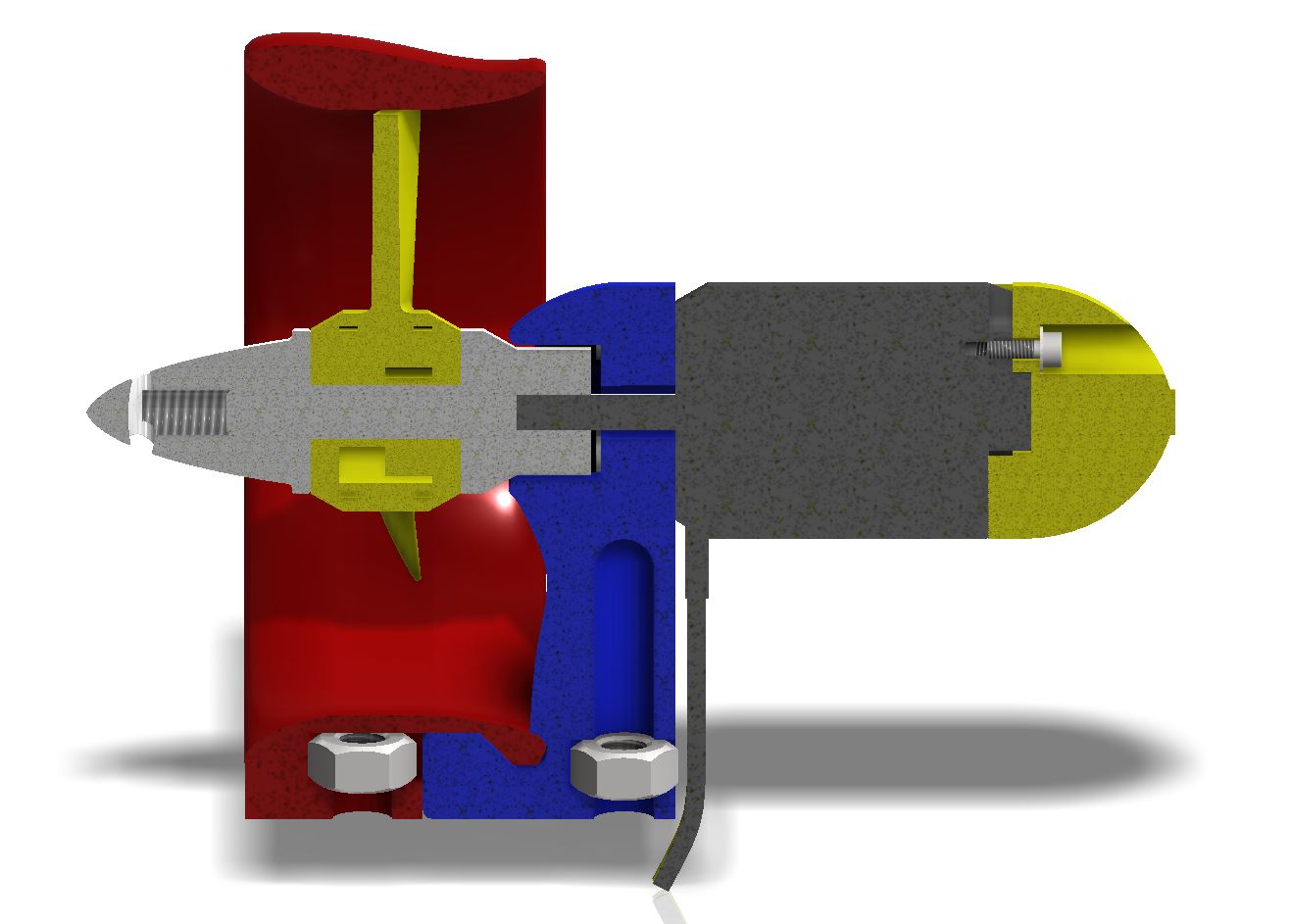

New day, new design.
I removed the arms that I intended to use to mount the motor and have now replaced them with one mount (Shown in blue in the pictures)
This thing is a lot easier to print and will be 10x stronger. also making sure the motor and nozzle is centered will be a lot easier.
As you can see in the pictures the two pieces slot together so that they are all lined up and secured with one M6 bolt on each.
Downside is that I need to print a new nozzle
Also added a cone for the motor.

Looks great, only thing is what parts of your outrunner motor are spinning? I couldn't mount mine that way since the back of the motor is the only part that doesn't turn (end you have the dome/ fairing on).
Re: I'm jumping in!
This is the same style of motor I have (mine are 28-36 750kv)
The part where the cables enter the motor is stationary. Same side as the shaft.
