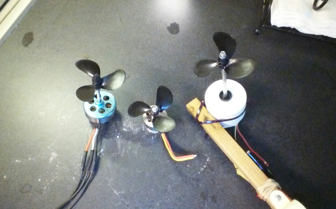

Tested this EDF fan as a potential propeller:
EDF Ducted Fan Unit 6Blade 2.75inch 70mm
All @ 12v with the NTM Prop Drive 28-36 750KV
2 bladed prop:
1kg = 6,5 amps
1,95kg = 23 amps (max speed)
Reverse:
0,9kg = 23amps (max speed)
3 bladed prop:
1kg = 5.5 amps.
2kg = 25 amps (max speed)
Reverse:
1kg = 25amps (max speed)
5 bladed prop:
1kg = 8.6 amps
1,8kg = 27amps. (max speed)
Reverse:
1,2kg = 26amps (max speed)
And the famous Graupner 2308.65
1kg = 5amps
2,2kg = 13amps (Max speed, but sucking some air so not really reliable)
Reverse:
0,9kg = 12.5amps (max speed)

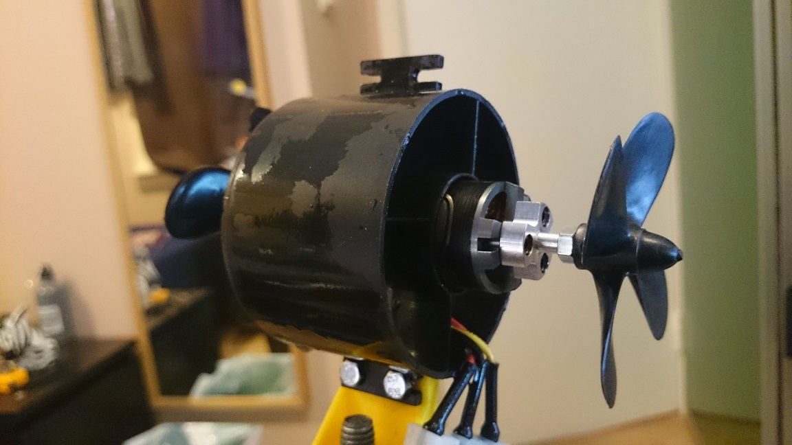

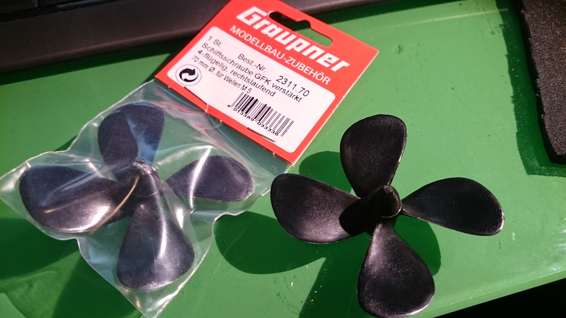

Graupner 4 blade 70mm prop (2311.70)
1kg = 7,5 amps
1,8kg = 14,5 amps (max speed)
Reverse:
1,3kg = 14,5mps (max speed)

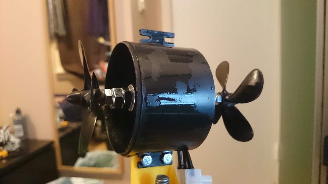

And for fun:
Two props on same motor.
Numbers were the same in forward and reverse as one would expect.
1kg = 10 amps
1,5kg = 18amps. (max speed)

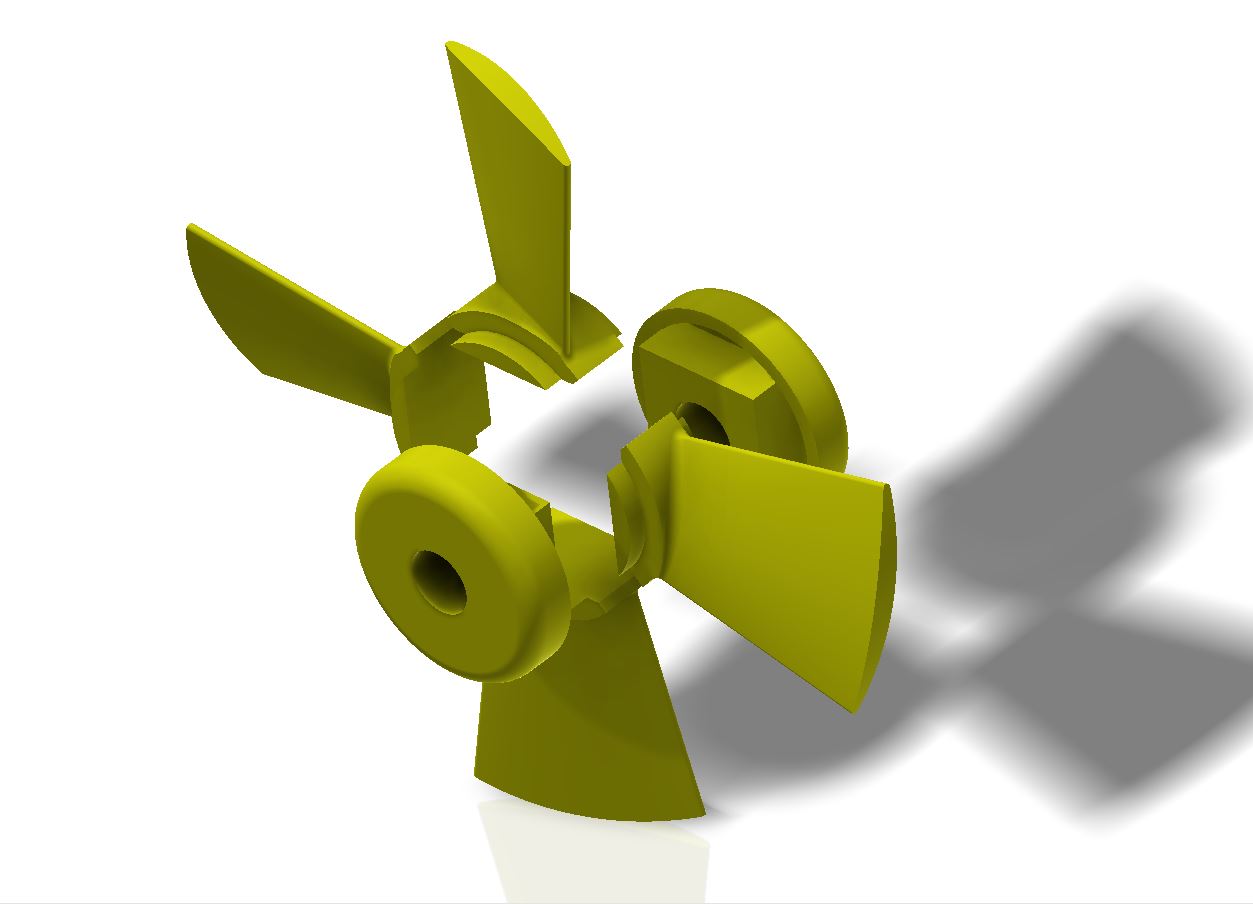

However, my time has been spent on a slightly different project. I randomly searched Thingiverse (thingiverse.com thousands of things you can download and print) and I found this prop:
http://www.thingiverse.com/thing:338127
As you can read in the description, the creator claims 14N of force @ 6amps, 12volt on a 750kv motor. in both directions! This is above graupner forward performance. And in both directions.
I tried to print this prop, but as it is printed "flat" it needs to be printed with support material witch is slightly more difficult and requires a lot of work afterwards to get a good enough finish where the support material has been removed.
So I made my own version with modular blades. It is now very easy to print. One complete prop took about 55mins to make. To print a set of four blades takes 40mins.
The one I have tested has a diameter of 69mm so it fits the shroud that came with the EDF fan I tested earlier. I can also very easily test different pitch, diameter and twist in the blades.

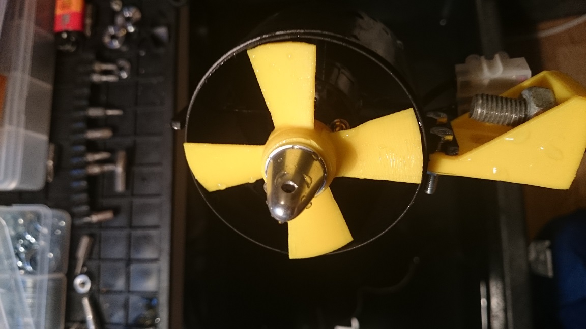

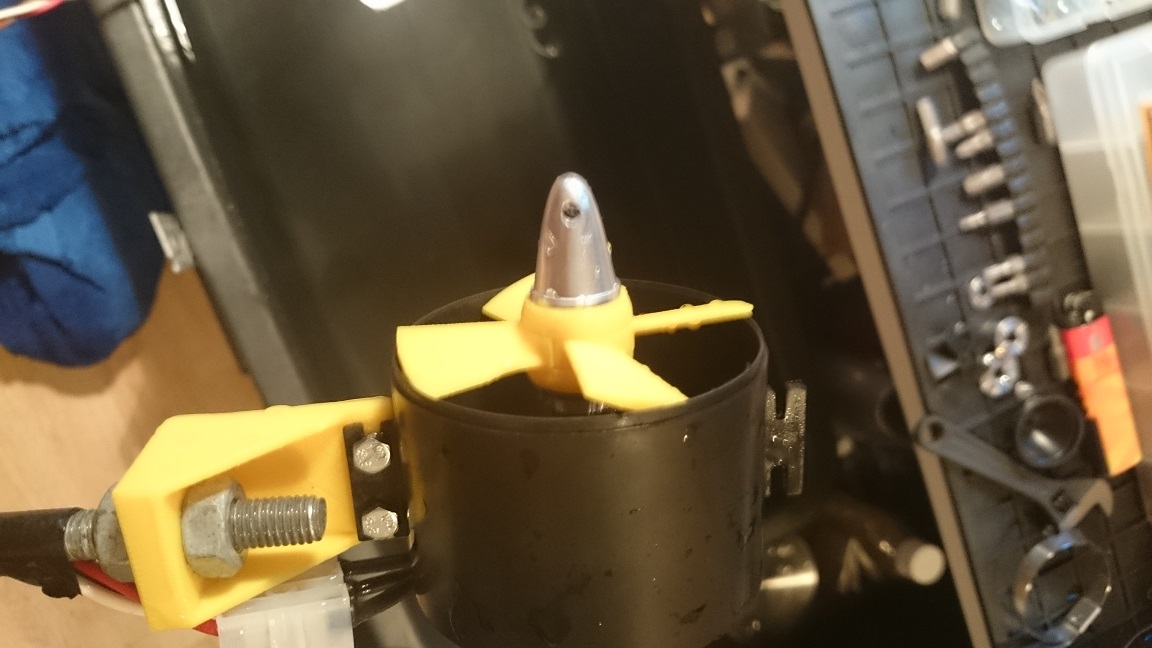

Tested the first prop now, straight from the printer:
As you can see in the pictures below, the prop doesn't sit deep enough in the shroud so the performance was a little bit bias to the direction where it pulls water through the shroud and out on the "propeller side"
1kg = 5amps
This is pretty much the same as the graupner 2308.65 and quite a bit better then the 4 blade 2311.70 prop.
But, where the graupner 2308.65 prop maxed out at 2,2kg while pulling 12.5amps. This printed prop went to ~3.9kg @ ~22amps (!)
That is a lot of amps, but also a lot of push if you need it ;) Also, it shows that the performance is quite linear! My tank is a bit too small for the max speed, so the readings are somewhat unstable.
I am sure I can tweak this further, both in the geometry, surface treatment and maybe number of props. But even at this point I believe this prop design beats pretty much everything, especially since it will be pretty close to equal in both directions once the shroud problem is taken care of.

You can see the prop is too far out from the EDF fan.
