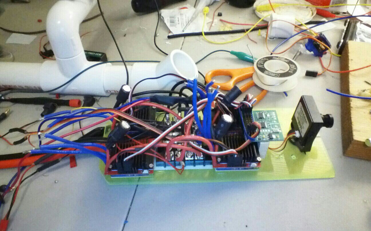

Posted: May 18th, 2013, 11:17 pm
by scubersteve
My control board...
Pretty simple. Four ESCs, a camera, a ppm to pwm converter, a brushed esc for the lighting, and positive and negative buss bars.
