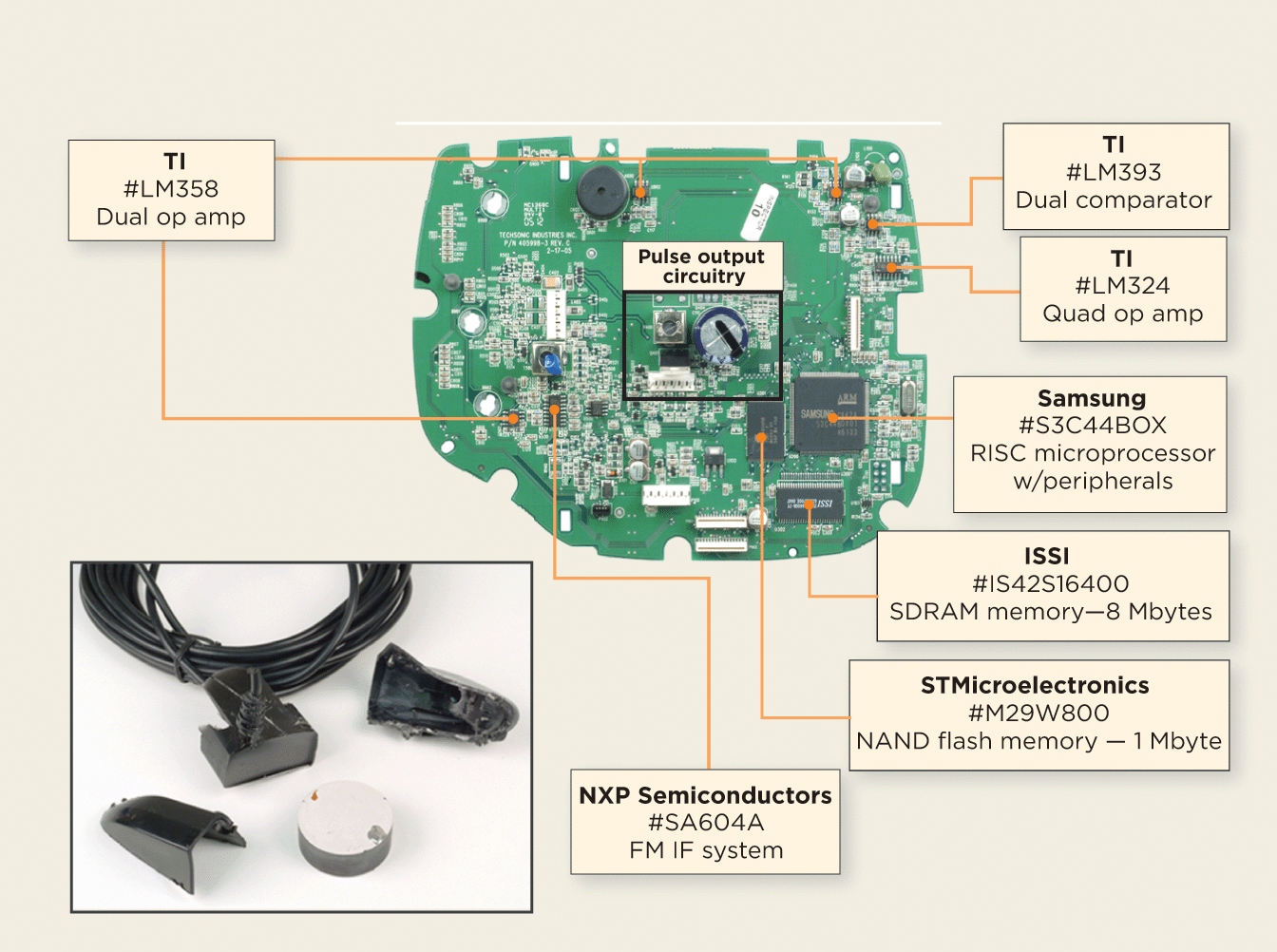

Re: depth sensor
Been checking out fish-finders to see how a cheap one may be "hacked into", with the view to doing USBL navigation and very simple imaging. Hummingbird (?) fish-finder around $100 which I believe is still being sold after a few years of production. In this model, I do not think there is any fancy digital signal processing (DSP), so you can tap into the analog signal where it goes into the FF microcontroller. Stick this signal into the A to D input of your own micro, and do some simple timing and level measurements on the received echoes and send whatever data you need from that to the surface. All the hard work is done in the FF analog circuitry. You could expect reflections from the water surface above, which may help or hinder.
Tried to find out how well potted or if any air was in the transducer (depth pressure issues) and could not, short of buying a transducer of the same type and cutting it open, which I did not! Would guess potted well enough with no air and just take a gamble. Alternatively, the transducer can be kept at atmospheric pressure in an oil-filled housing. This is commonly done with "shoot-thru" transducers on boats to avoid hull penetrations and things sticking out the bottom.
Sounds like what you want but usually costs more
, but standard depth sounders exist which give readings in NMEA0183 serial data, basically mimicking what is on their own display. This would be the easiest. Google or whatever "NMEA0183 depth sentence"
Then there are the wireless fishing-float transducers. If I understand how these work correctly, you could get serial data from what is being sent to the transmitter inside the float, and not have to do A to D as with the Hummingbird type mentioned in the first paragraph
Re: depth sensor
Here's the one I recall seeing. Good article for those wanting to learn more. For depth only, maybe just a comparator on the RSSI output would work without the need for an A to D http://www.eetimes.com/document.asp?doc_id=1281283 There's also cheap handheld finders (sub $60) on ebay or the the Chinese importers like this mob http://dx.com/p/ff108-2-4-lcd-sonar-fis ... pQodLh4Akw

Re: depth sensor
Awesome thank you for the link to the article
Going to be more complicated than I had anticipated but it gives me hope
